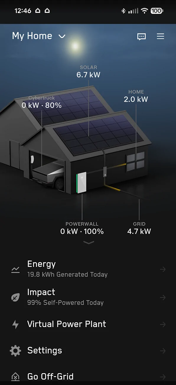

Unless you have so many panels more than you need to not be able to buy from them during the winter, you're going to have a ton of electricity you don't need in the summer. Maybe if that was the only issue but then increasing the percents for distribution so that what you produce is worth even less and then them paying you next to nothing, their wholesale costs. What they tell you is worthless and at a wholesale cost they turn around and sell for 10 20 or 30 times more. And again, they're adding fees that you can't avoid and they're going to keep raising those fees. And they've added these fees in some cases like mine after you've already put your system in. So now they're taking almost an extra $300 from me. No matter what. That number is not going to go down. They're getting everything they want at every turn. It's ridiculous.
Sorry, but incorrect. I heat with gas. My power usage is highest in summer. I never use grid power. With the Powerwall I don’t even dip into the grid at night in mid-December. My power bill is solely a fee. $10 per month.

If you heat with gas and cool with electricity, and have a site well-suited, it can work out. Solar panels are cheap enough to add more than you need most of the time so you can get through the low production times with conservation. A Cybertruck can be of real benefit by supporting any particularly dark string of days with imported electricity on those occasions.
Some not insignificant ifs there. But you're still buying and using gas and that going to cost who knows what in the future. The hope was that the EV and PowerShare (if they ever enable it) could help get through a random cloudy day but it's not going to do a lot if you're in the winter and you've got several weeks where your productions very low. Even if you're using gas for heating Maybe you can calculate your array to being a little smaller but you're still producing way more electricity than you need in the summer. For more and more folks you're gonna get next to nothing for that extra electricity that you're producing. Hopefully battery and solar will get so good and so cheap it'll that it won't be an issue but then more and cities and utilities will require you to be connected and pay a flat rate no matter what and that rate will just keep going up.
I'm glad you're heating with gas but that doesn't change everything. It's great if you can somehow never use utility power but I'm guessing it's going to happen at least sometimes like when you have a Powerwall 3 and it shuts down for a day or two to recalibrate or an inverter goes down etc. If those are the only times great. I'm glad your monthly fee is currently only $10 but other folks already fees two or three times that amount and it's only going to keep going up.
You get lucky and size your system just right and you have a gas water heater and maybe a gas for HVAC and you're never using utility power. But where is the gas coming from, what's the price of that gonna be in 5 years?
10,293
20,698
I don't understand your objection to having more production than you need during some seasons in order to create independence from the electrical grid for the entire year. More solar than you need during the sunny seasons is the way. If you size the system to meet your needs during the cloudiest, shortest days, there is no downside to producing more electricity than you need the rest of the year. That would be like saying you should never build a dam that requires the water to be diverted around the generators during the rainy season. Dams do this all the time when it rains too much. The generators are sized without worrying that they can't process all the water year round. Please explain why this is a problem.
Who cares if you can't use every kWh the system is capable of producing (when you don't need the electricity anyway)? The point is, you can reach your goal of total grid independence. I used to have a property with unmetered water, I could use as much as I wanted for the same monthly price. Do you think I had to leave all my taps running 24/7 just so i could get my money's worth? Of course not. You use what you need and shut off the water when you don't need it. Or, how about sizing the number of bedrooms in your house to accommodate your grandkids when they visit? Do you fret that those bedrooms go unused 9/10ths of the time or are you happy that your grandkids have a place to stay when they visit? How about buying a car that can seat 5 or 6 people when it generally only needs to accomodate 1 or 2 people? Do you refuse to go grocery shopping until you can fill every seat (since you paid for a car that big)? We size a lot of things for peak use. It seems you just want to throw up non-sensical objections. More solar than you can use during most of the year is a good problem to have.
It's nonsensical to worry about not having 100% reliability. Even the grid is not 100% reliable. Imagine you have an off-grid house in the woods. You want electricity but it's going to cost $10K to run a utility line in. Would you say, "Well that sounds great, but what am I going to do when there's a power outage? No way, Jose, if the utility line is not 100% reliable, then I don't want it!". It's a ridiculous way to think.

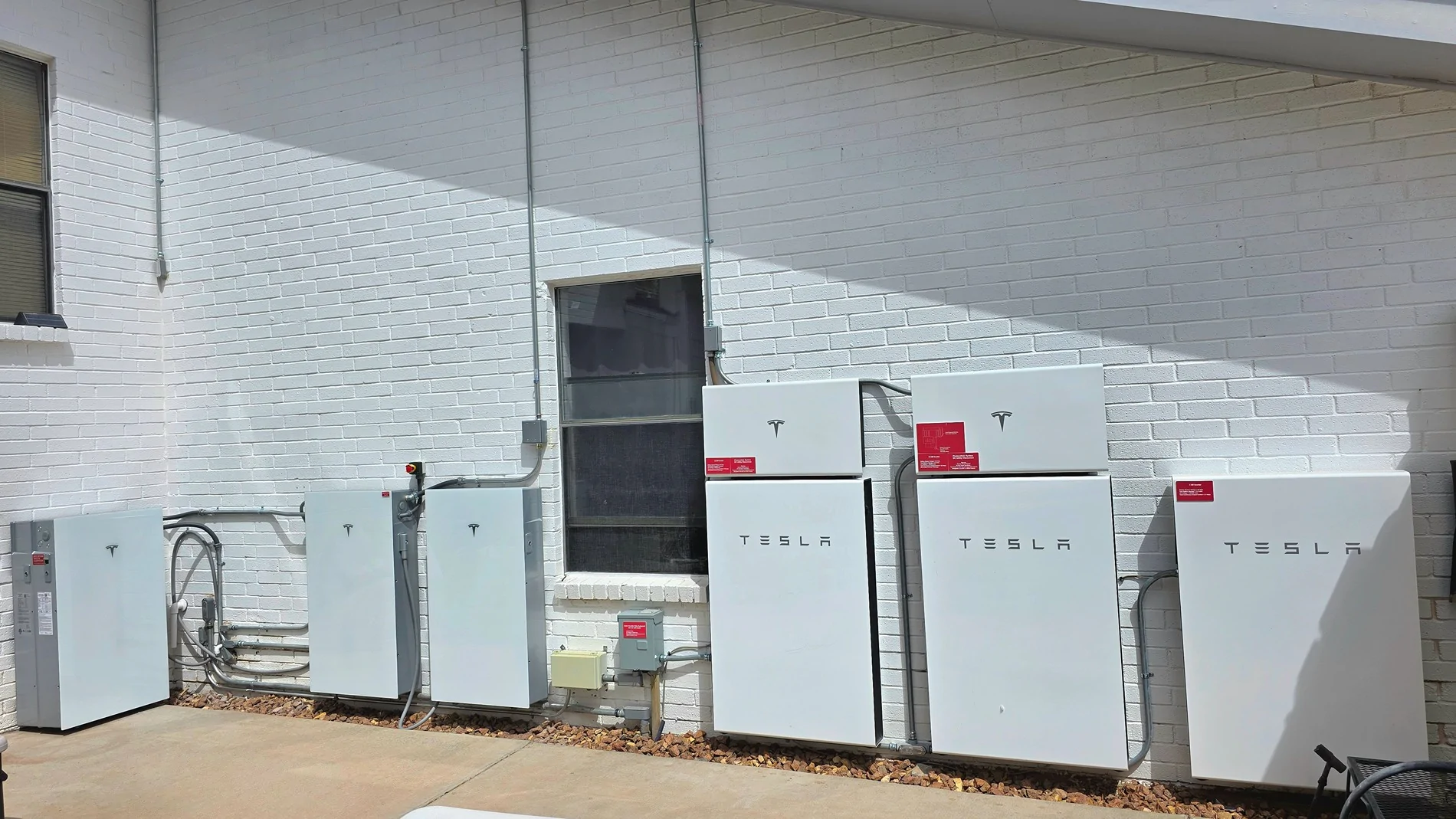

The contractors just completed the install of the 2 additional Powerwall 3 Expansion Units so now all 7 batteries are up and being charged by my 2 solar systems. Noticed the 2 on the far left are piggybacked; a Powerwall 3 in the front with an expansion pack in the rear to save space. The total capacity is just 98 kWh, still smaller then one battery pack from my Cyberbeast 😂
