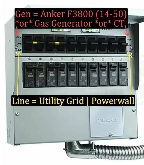

The Cybertruck will source 40A from the (nonlocking) 14-50 outlet in the bed. I'd suggest using a locking 50A SS2-50 on the house side. Otherwise, you run the risk (load or fault dependant) of either overcurrenting the cable/ L14-30 or tripping the inlet breaker (assuming it is 30A).
Something like this: https://www.amazon.com/CircleRiver-Generator-14-50P-SS2-50R-Locking/dp/B0BL2KTH1R
Full kit:
https://www.electricgeneratorsdirect.com/Reliance-Controls-EGD-Q510KIT/p13512.html
It seems like you could have the best flexibility with a powerwall connected to your main panel that would 'instantly' switch over (eg vacation or away from house at grocery store, etc)
AND have that transfer switch so when you are at home and plugged into the CT bed that you could pick what runs on the CT and what runs on the powerwall. As well the transfer switch input could be:
a) cybertruck
b) Anker SOLIX F3800 w/NEMA 14-50
c) gas powered generator (borrowed from friend or whatever)
My associated attempted picture.

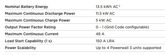

Powerwall 3 spec:
a) cybertruck
Powerwall 3 spec:
Yeah, that's sorta the setup I am trying to get installed with Powershsre upstream of existing full panel manual transfer switch. Powerwall installation guide calls out PW then Automatic transfer switch for dual backup options.

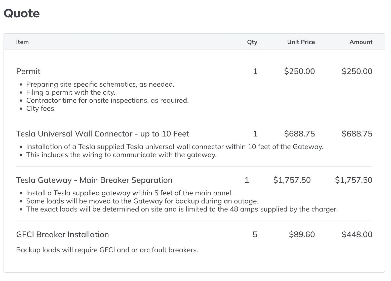

as I posted in another thread, i denied four bids by qmerit affilates before accepting a fifth bid which I found somewhat reasonable.
my take, keep denying the quotes...and see if the quotes keep going down.
