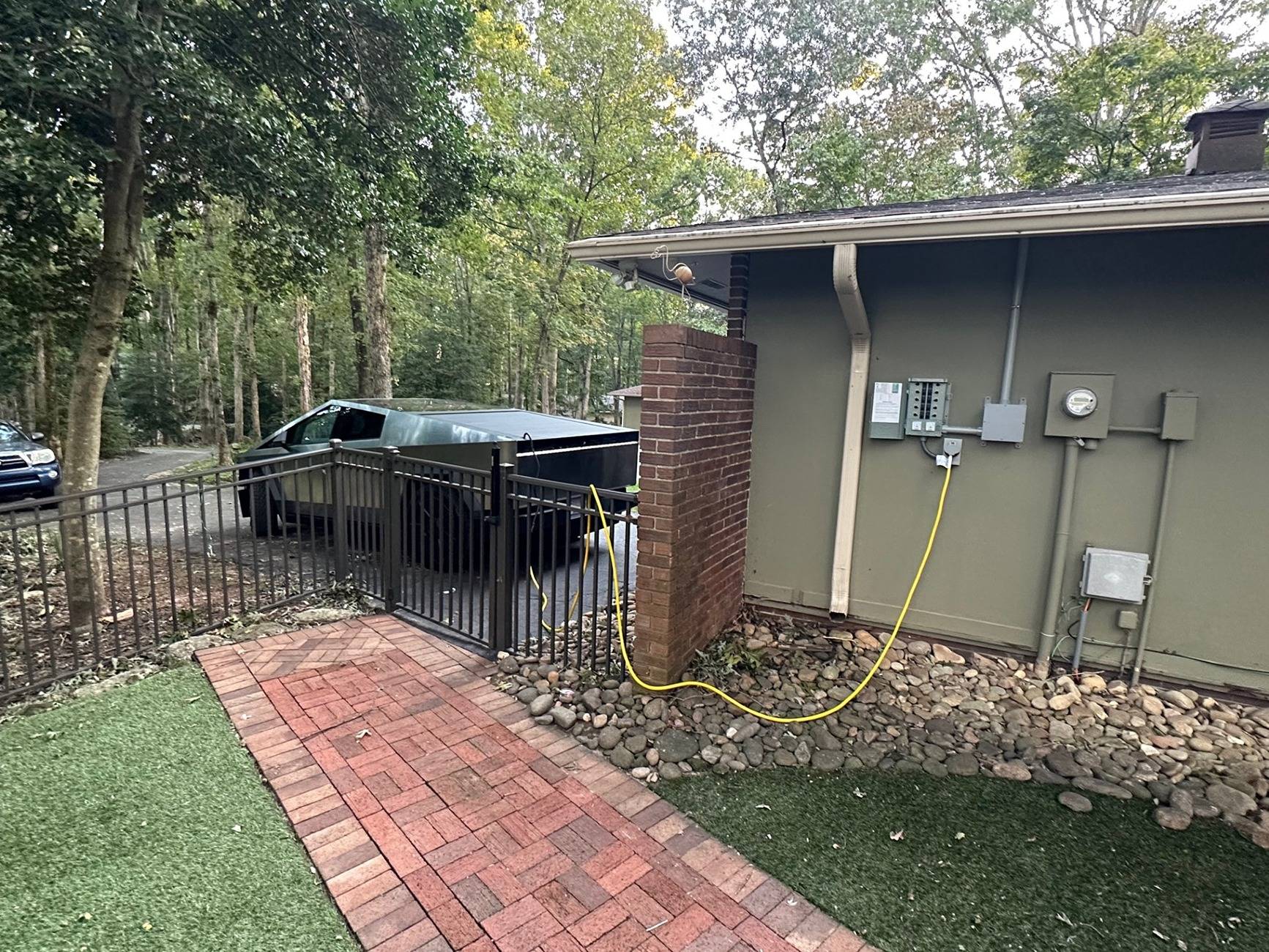

  3. Emergency Setup: In an emergency, I don’t need an automatic cutover that kicks in within 2 seconds. I just want to power critical circuits until the grid power is restored—things like the refrigerator, lights, internet, hot water, and kitchen outlets. That’s exactly what I did: had 8 critical circuits diverted from the main panel to the cutover box.
Here’s what I ended up doing:
  • My electrician installed a cutover box that’s set up for an L14-30P generator cable. This allows me to connect a generator manually to power the essentials. I had this put outside so that I can run the generator as far away from the house as possible to mitigate noise and CO2.
  • Since the Cybertruck has a different connector, you’ll need to get an L14-50 to L14-30 adapter cable created to go from the Cybertruck to the generator inlet.

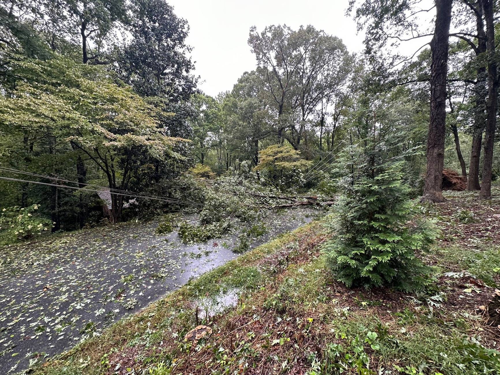

This setup has already paid off. We’ve been without power since last Friday when Hurricane Helene knocked down power lines and poles in my area. The infrastructure damage means we’ll probably be without power for the rest of the week, but thanks to this generator cutover, I’ve been able to keep essential systems running smoothly.
It's running between 0.8KW and 1.2KW and that drops battery range about 10% per day. I topped it off yesterday and drove 26 miles to find a Supercharge in operation. No lines. But I did pass several gas stations with lines - only a few had power to pump.

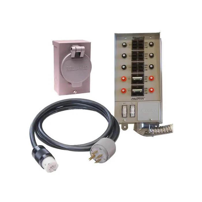

The Cybertruck will source 40A from the (nonlocking) 14-50 outlet in the bed. I'd suggest using a locking 50A SS2-50 on the house side. Otherwise, you run the risk (load or fault dependant) of either overcurrenting the cable/ L14-30 or tripping the inlet breaker (assuming it is 30A).
Something like this: https://www.amazon.com/CircleRiver-Generator-14-50P-SS2-50R-Locking/dp/B0BL2KTH1R
Full kit:
https://www.electricgeneratorsdirect.com/Reliance-Controls-EGD-Q510KIT/p13512.html
