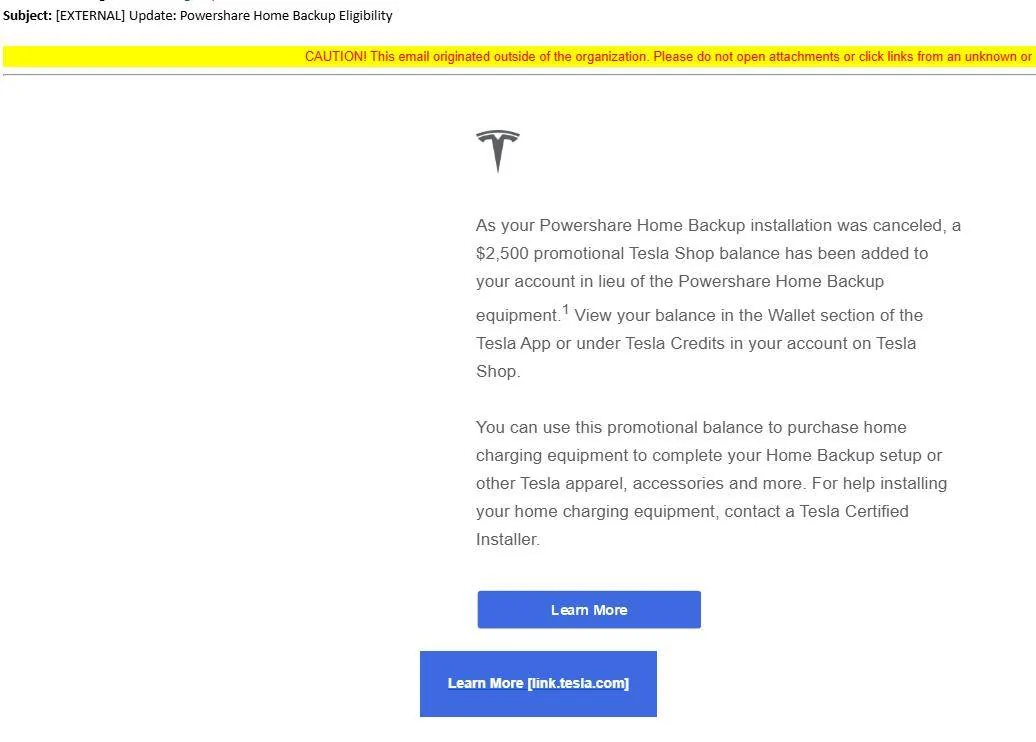

I received this puzzling email in April, which I did NOT "cancel" but their email indicated that it was. WTF??!!
?‍♂ mine was from September and similar but had a Tesla shop code with one year expiration date.

The original package with Foundation Beast was Gateway 3V + UWC (later given as $2,500 shop credit or voucher) plus up to $4k towards installation (this perk went away for new orders in May 2024) .
Nowadays, you would need to buy the equipment for $2.5k and pay for all of the installation.
