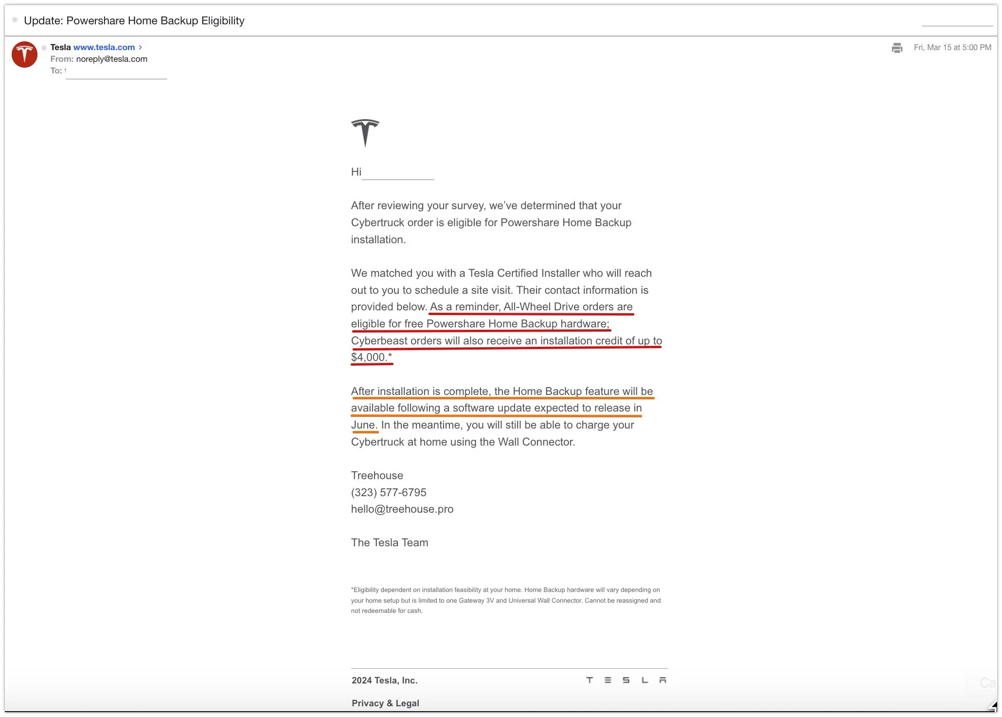

I got this from an installer- gave them my info
waiting for them to give me a quote and talk to me..
What got me, is the complimentary equipment statement.

Got an email from Tesla,

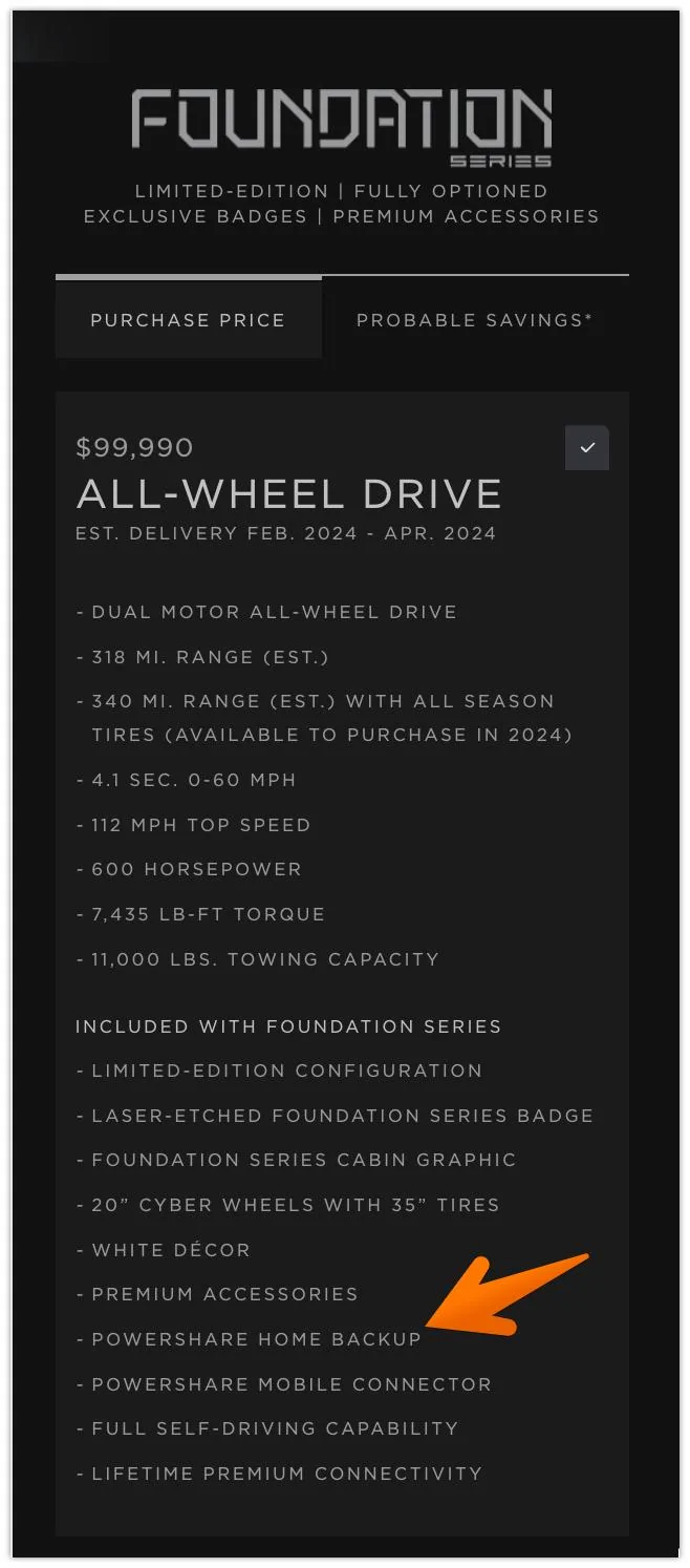

My question is: Its stating the Powershare Home Backup Hardware is "Free"
Thought we buyers bought the equipment already in the Foundation/Beast Package deal.
Also states software to use this feature not available till June.

Tesla Cybertruck PowerShare Install Process & Assessment Foundation series paid
