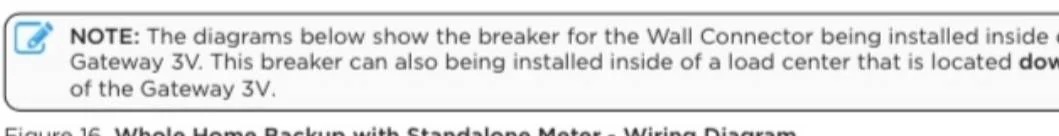

Tell them to read the fine print in the installation manual:
This breaker can also be installed inside of a load center that is located downstream of the Gateway 3V.
Ok, they now understood and considered my request. They say that the subpanel will be over it's capacity with the new charger, particularly because we have already another charger on it, which we're about to keep.
Provided that we don't need to use both chargers at the same time, is there a device (load manager?) which will allow only one of the two chargers to be active at a time? They say there's no suitable device, particularly such that supports two-way flow (for charging and backup).
