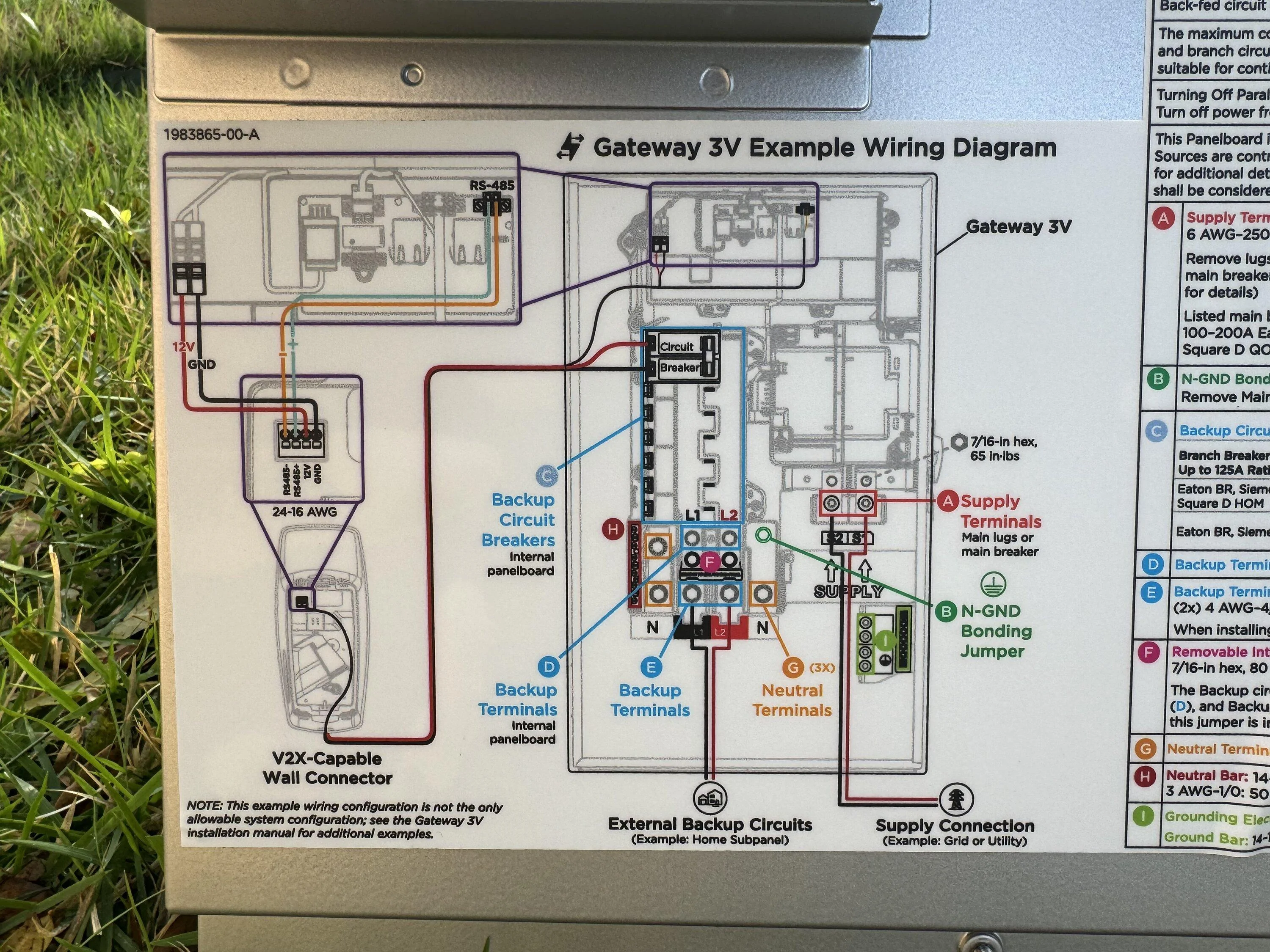

Thanks for intel. I assumed a Powerwall would back up my entire existing panel without the need to have a separate panel with desired circuits lit up during a power outage. That’s my main concern with PowerShare, separating circuits from main panel adding more complexity, bulk and points of failure.
Also wondering why those who indicated to Tesla that they had a Powerwall were mostly disqualified for the PowerShare benefit.
Bottom line for me is does PowerShare really add that much to my home, especially if the power outage occurs when I’m away with my CT? My food still rots and there’s a fair amount of complexity to the installation.
