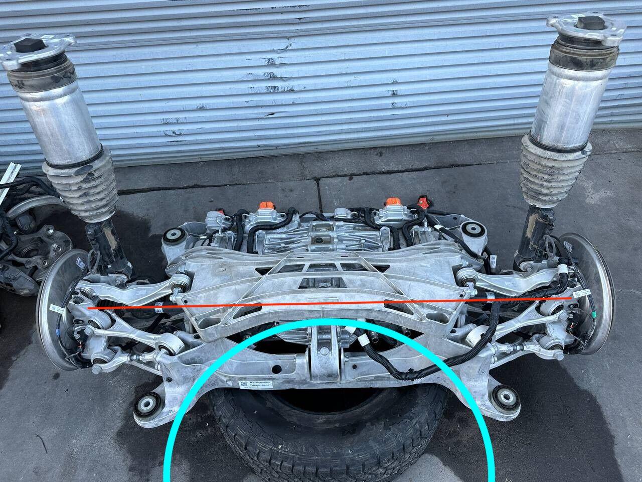

Tesla could have certainly been doing their due diligence on the technology and company for years but that doesn’t necessarily mean they had the product in mind for Cybertruck. Particularly when they were at the Alpha design stage which would have been quite a long while ago. It could have been just a matter of the space being there already for the aforementioned aero reasons.
That being said I'm not going to discount the possibility entirely given you have insider info, it would just strike me as an odd choice for them to prioritize wireless charging over departure angle were it not for, primarily, aero reasons. Which, unlike wireless charging, ranks far higher in importance on a vehicle like the Cybertruck. Robotaxi would be an entirely different story.
Just to clarify I’m not saying there is space for one with the way the truck has been designed but there might have been enough space for one had Tesla wanted for there to be one, it just didn’t rank high on their list of priorities for a number of reasons, some of which you mentioned.
Looking at the Model S Plaid rear drive unit you could have one be very close to the centerline of the 'axle':

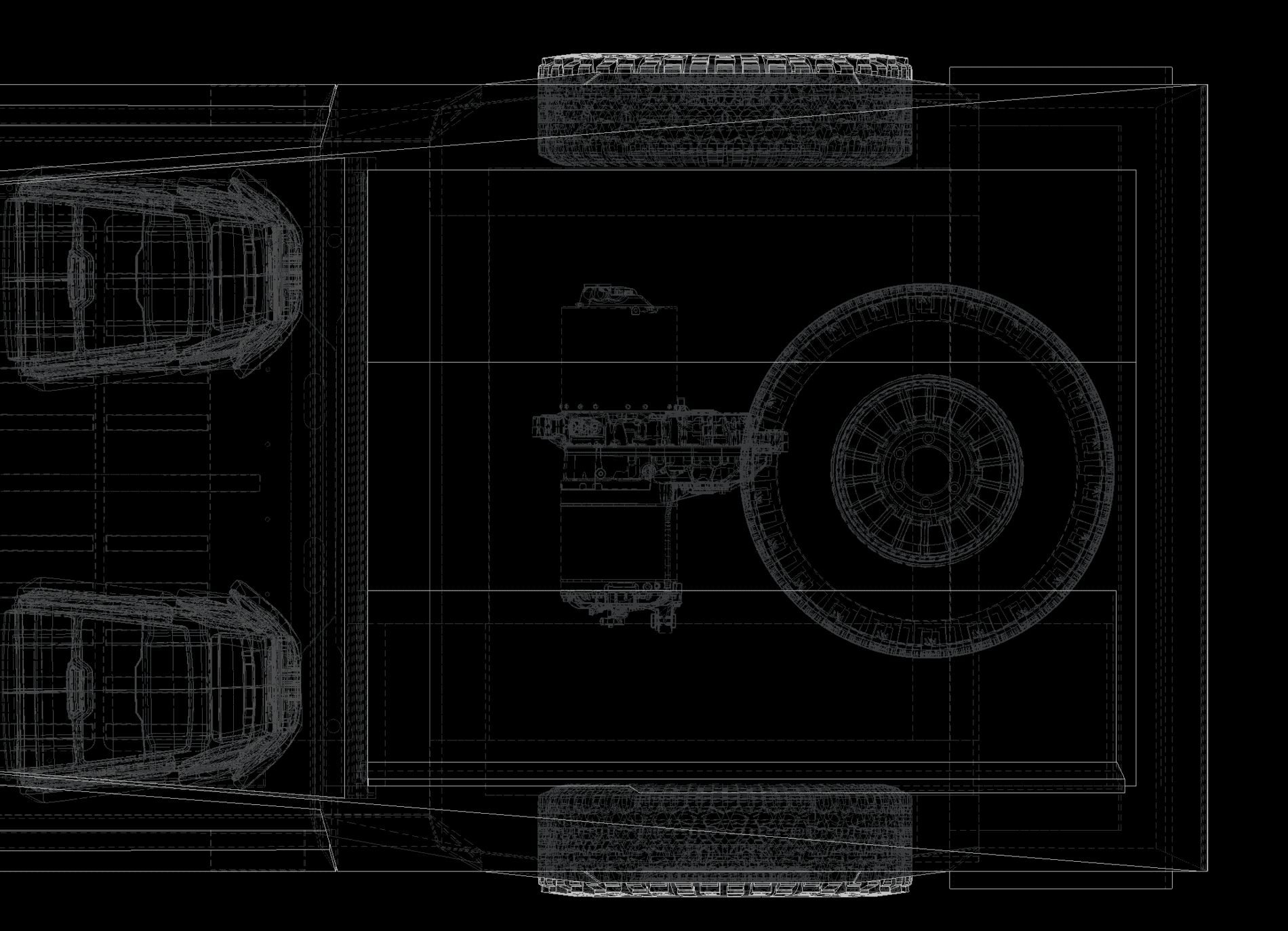

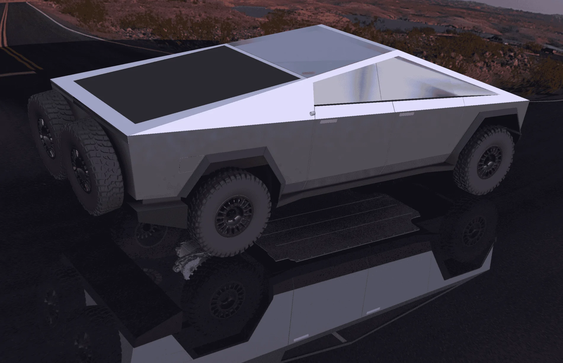

This is a fairly old conversation, but maybe these even older drawings I made a few years back, will help show the spare wheel size problem:
Tesla Cybertruck PREDICTION:  Cybertruck Accessory = Wireless Charging ct-spare-drawer-
Tesla Cybertruck PREDICTION:  Cybertruck Accessory = Wireless Charging ct-spare-drawer-vtop-

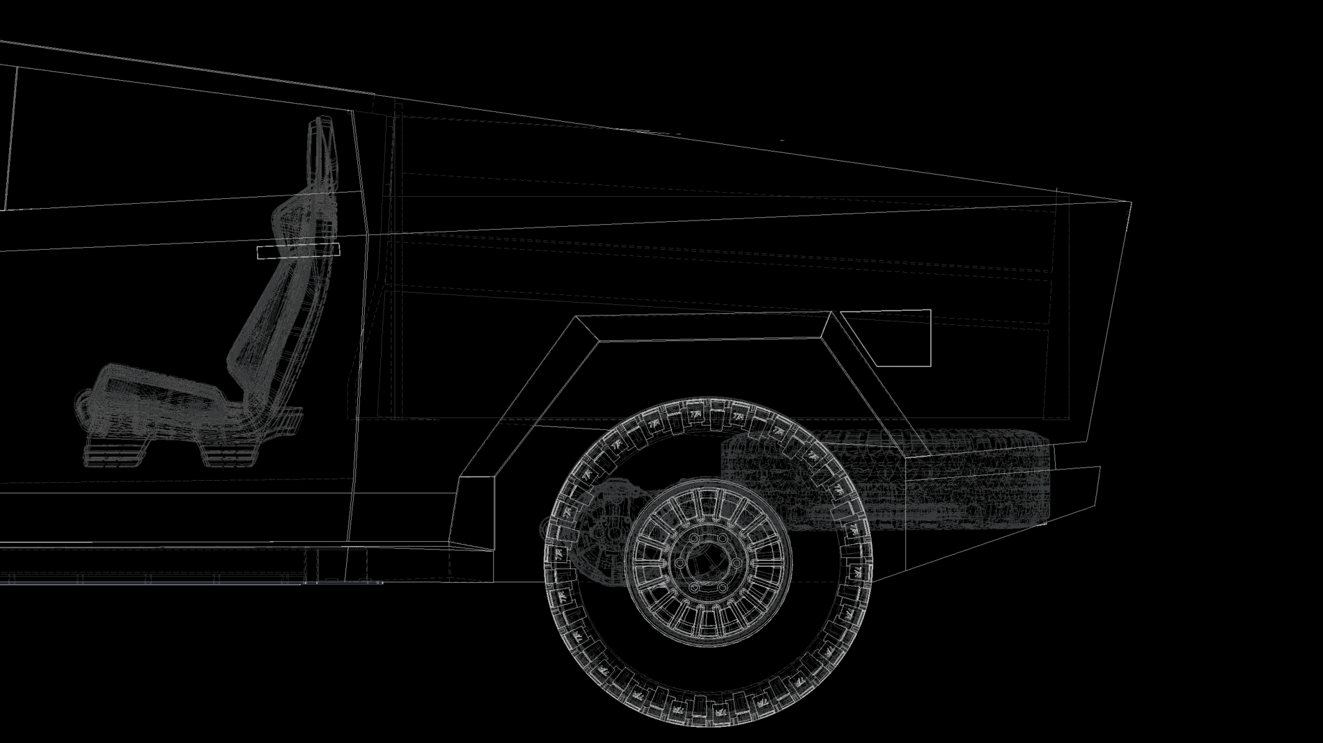

That's using the Plaid motor setup in the rear, which is mounted so that the rear driveshafts to the rear of the CT line up with the centre of the rear wheels so that the CV joints aren't on angle that increases wear, and reduces torque handling. A smaller motor would not change the location of the driveshafts to the rear wheels, so here the limiting factor is the distance behind the rear wheel centre to the end of the rear bumper.
Tesla Cybertruck PREDICTION:  Cybertruck Accessory = Wireless Charging spare-wheel-options-png
You can see the proximity in the reflection of the render above.
I'd say mounting the spares on the rear is the only way to get them onboard, without interfering with the CT design length (which has been shortened since these old drawings) or increasing the rear overhang by reducing the wheelbase.
https://www.cybertruckownersclub.co...k-come-with-a-full-size-spare.3196/post-52851

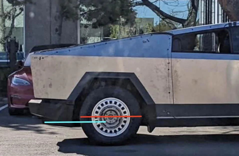

it’s not permanent. Equip-wise it’s like any other charger, except instead of a connector at end of wire, it’s a pad that lay on the ground (wire, too).

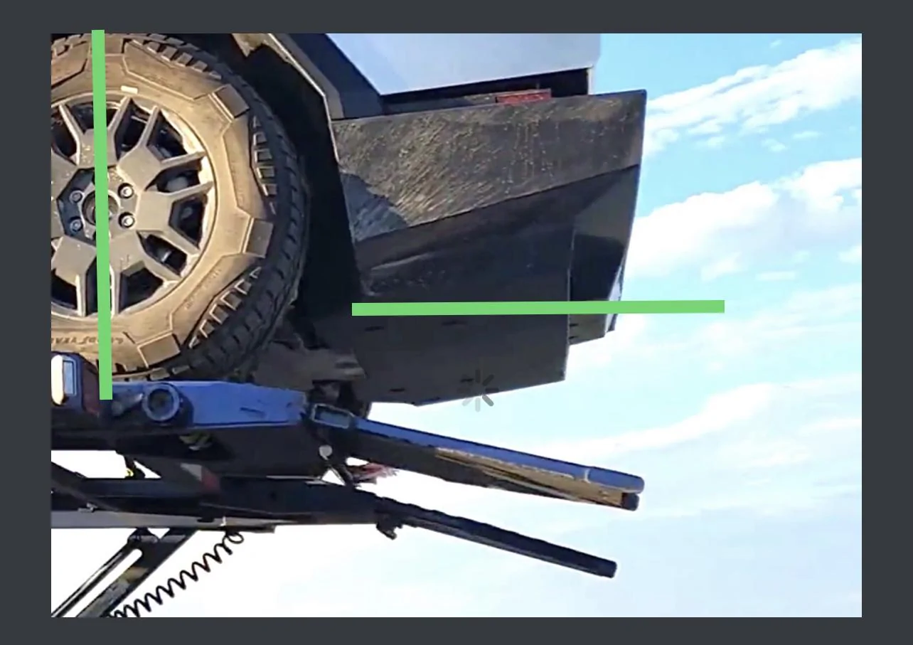

bare in mind the size of a “donut” is relative to the size of the standard tire: a “donut” for a 35” standard would still be a large tire
set aside that Tesla doesn’t really do spares, and set aside that there is “stuff” in the way prohibiting a spare in this under-bed location, and set aside that a spare under trim fascia such as this is generally unworkable, and you’re still left with their just not being room there
the two green lines above are the same length. While a really rough compare, it emphasizes that there simply is no room for any spare, donut or otherwise

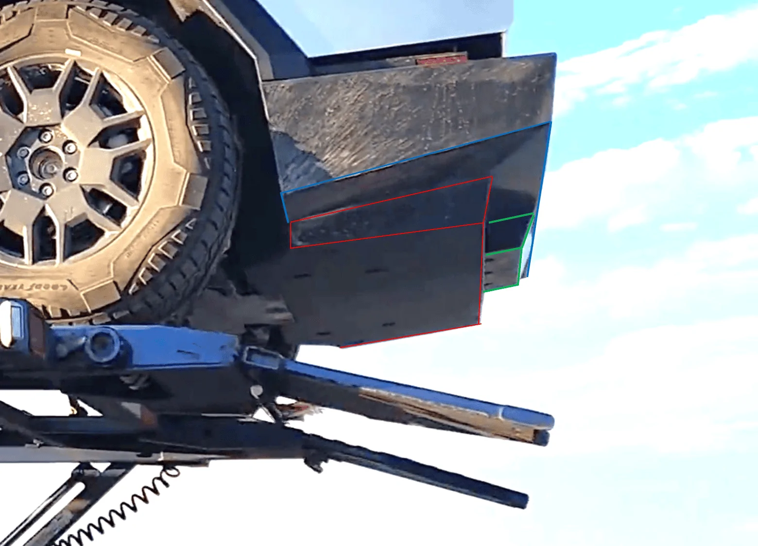

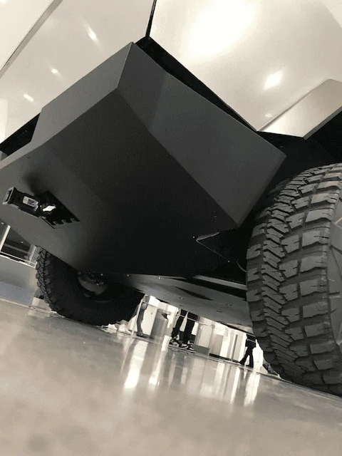

No doubt that this portion of the rear fascia has to some degree been designed with aero in mind. Every part has.
But in terms of maximum aero efficiency, the OG prototype rear fascia nearer to ideal.
So the starting question becomes, for what purpose would Tesla adjust to a less ideal aero rear fascia with this form factor?
And the answer to why they would make this move to a design that is both less aerodynamic and results in less departure angle, is that they are accommodating something of importance.
What that importance might be was somewhat a mystery, until we were able to see *under* the fascia and realize that ... nothing is there. Other than a few minor support struts which themselves appear to be there for the near sole purpose of providing attachment points for this rear fascia bump down (in the photo above, see the four trim attachment points, which correspond to those support struts).
So Tesla has changed this rear fascia to be less aerodynamic and reduce departure angle for, nothing?
Alone it leads one to think it's there to accomodate some option not present in the unit we've seen *under.* That option not being a spare, it leaves open the question.
My post was in effect then pointing out that this rear fascia's form factor (mirroring the Wiferion tech equipment), together with the acquisition of Wiferion, together with the screen-grab tease from Investor Day showing the Model S with wireless charging, and also this rear area of the vehicle to be Tesla's preferred location for Wiferion tech, seems to me to wrap it all together.
There's a longer more tenuous discussion left as to why, if it's an option, Tesla wouldn't also have an optional rear fascia that is used only for wireless-equipped units. I have thoughts on that, but neither here nor there for present purposes.
IF nothing else, what doubt one might have left regarding this rear fascia being for wireless charging, puts the onus on them to come up with an alternative explanation for why Tesla has reduced both aero and departure angle for no apparent reason (once we've seen under).
Given that premise, yes. However I'm not of the same view that there is no aero benefit to the 'diaper'. The OG bumper had a very steep angle to it, which usually isn't a design conducive to reducing drag. That is not to say there won't be a wireless charger, just that I'm not entirely convinced it was the primary reason they shaped it that way. Unless you have info coming from within Tesla to the contrary.
Not saying you could definitely fit one but it's small margins. Any combination between the OG possibly having had 37's, using a smaller spare, new 'diaper' bumper, some degree of error in the diagram etc... might be the difference between being able to fit one or not. No point in discussing it now though, we saw the post-crash underbelly photos and it's clear there won't be one. As SledgeMD mentions below, provided they include an onboard compressor you can tap into, it's a reasonable call on Tesla's part.
