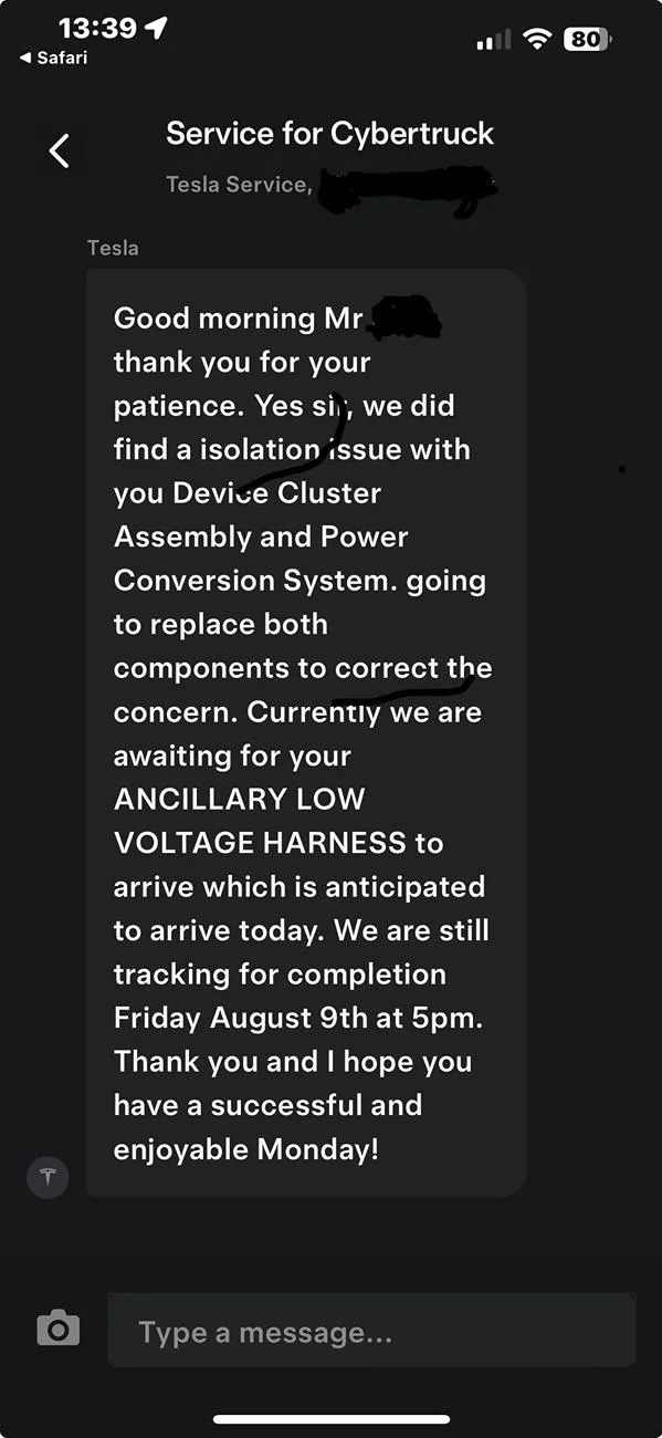

Service Center resolved it today by replacing the PCS. Done in 1 day.

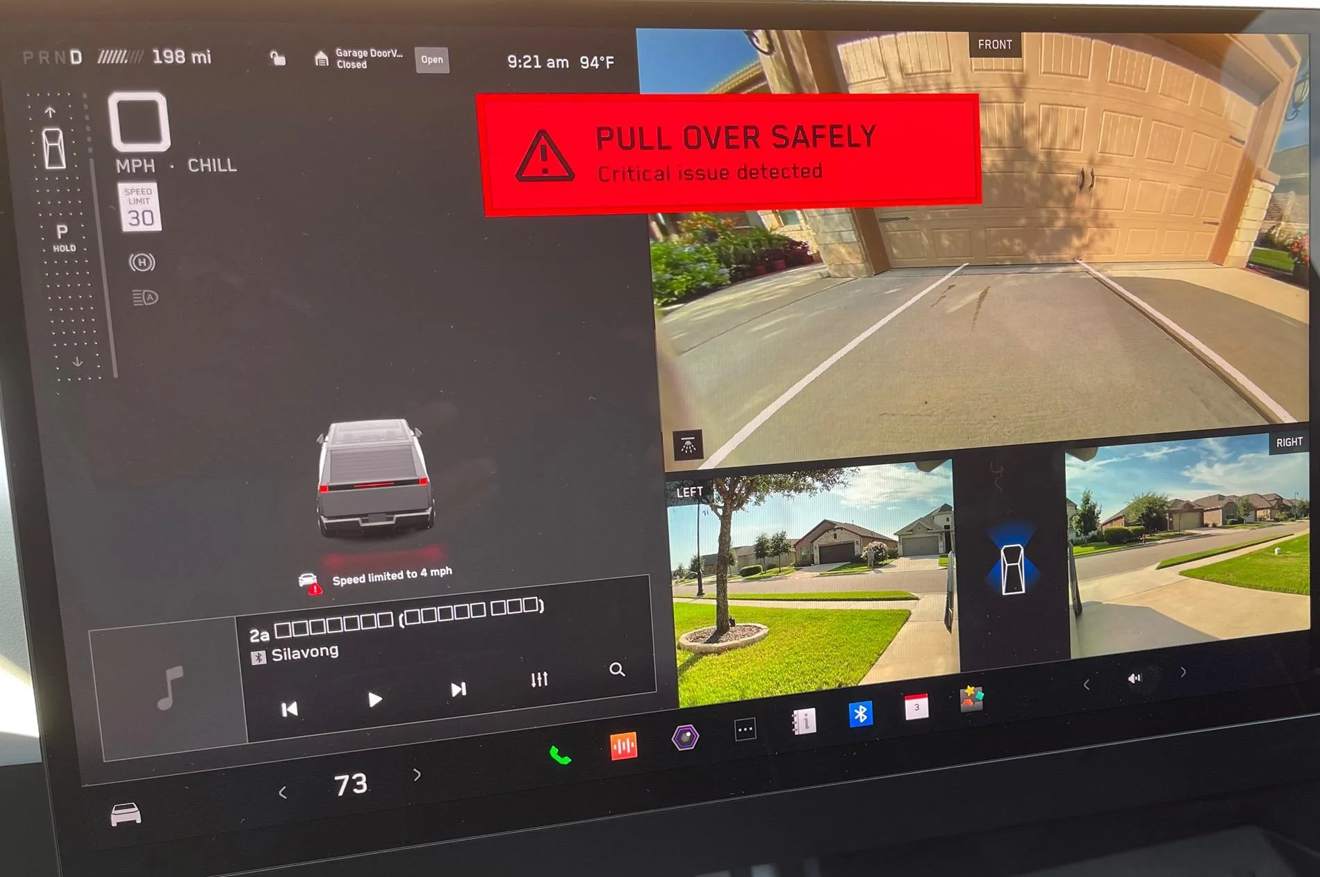

Issue: The red flashing message “Pull Over Safely. Critical Issue Detected”
Details: This is a data point of CT FS issues in our CT Owners Club Forum; and this is not an insult message to Tesla engineering. The CT ran fine yesterday. This morning I backed it out from garage and surprisingly found the issue (see photo); and here are my main actions:
Calm and patiently read the pop-up messages and followed (without any good results) > Called the Roadside Assistance > Rode the tow truck to Tesla Service Center > Drop off the CT > Pickup a loaner Model-Y and drive home > Waiting for updating messages in Tesla App (The estimated service time is 1 week).

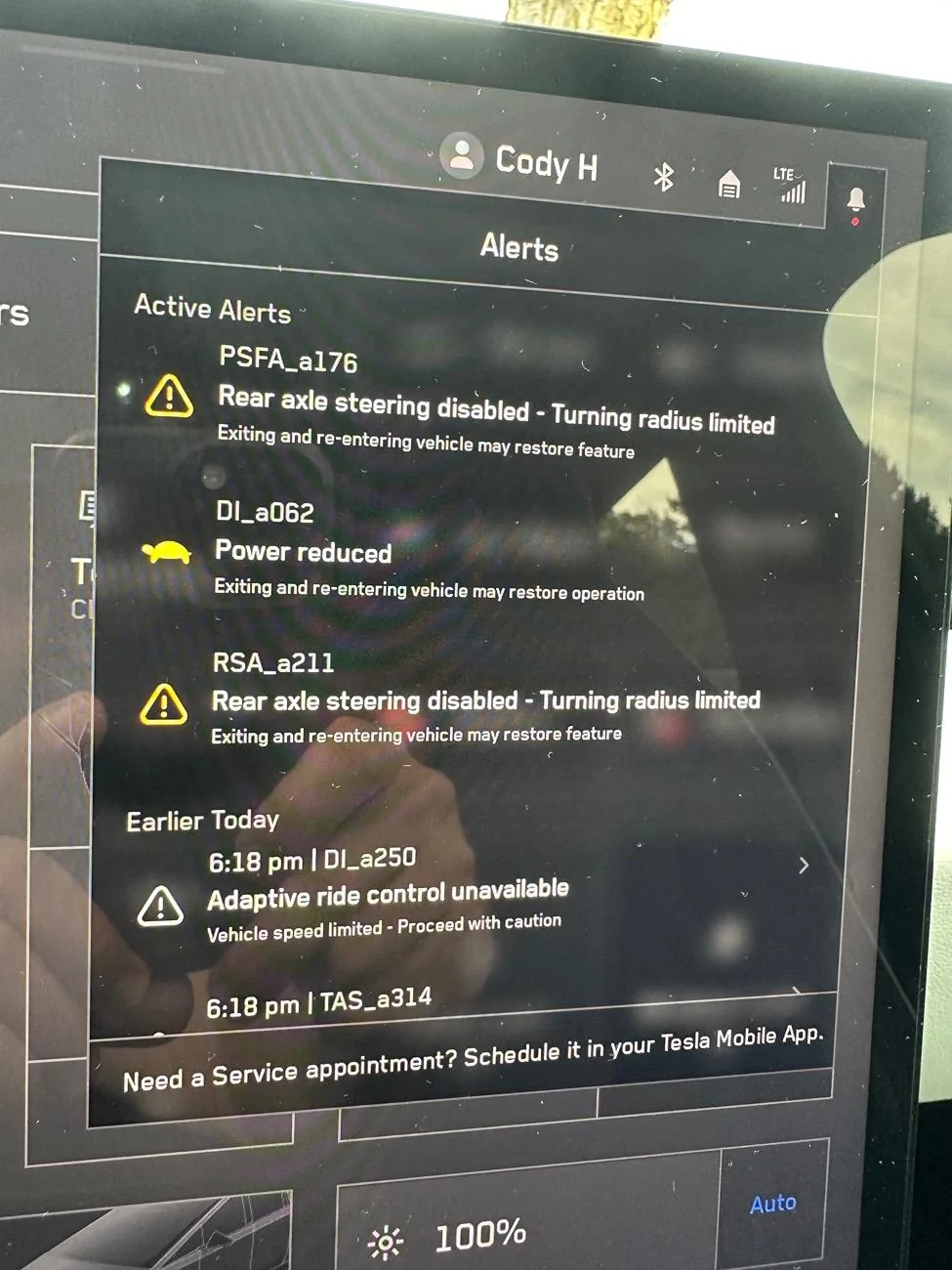

Picked up my Cyberbeast a week ago. Drove it on Monday to get it wrapped. When I went to pick it up later in the week, I received the same error. Rear wheel steering disabled, along with some low voltage error, speed limited to 4mph. Unfortunately, I couldn't make the error to away, so I needed to be towed to Tesla service.
They are saying it should be completed later in the week. Didn't even put 50 miles on... I am hopeful that Tesla can fix it quickly and that it's smooth sailing after. Just posting for reference. VIN is in the 27xxx range.

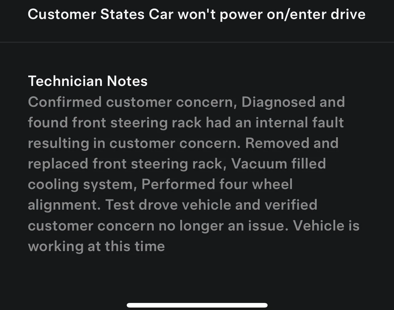

So, it’s been at the service center since 2 Tuesdays ago. Was diagnosed late last week as a damaged wiring harness connector pin related to the HV battery.
part needs to be sourced. Will update on the final outcome and total length of days.

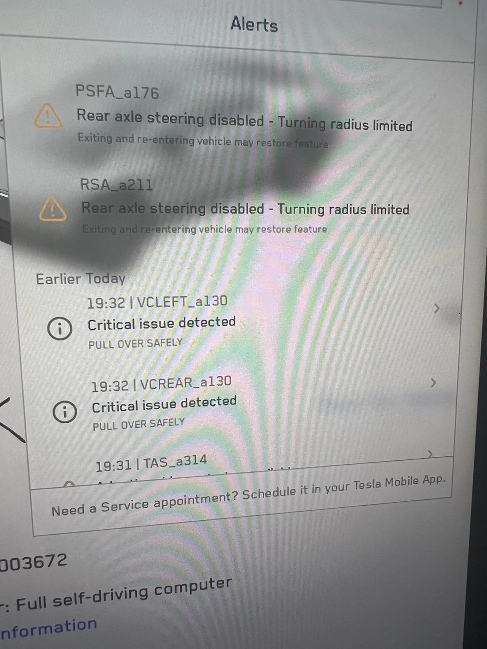

Same thing happened to me after charging. After a few resets the error went away and is driveable. Going to bring it into service soon.
