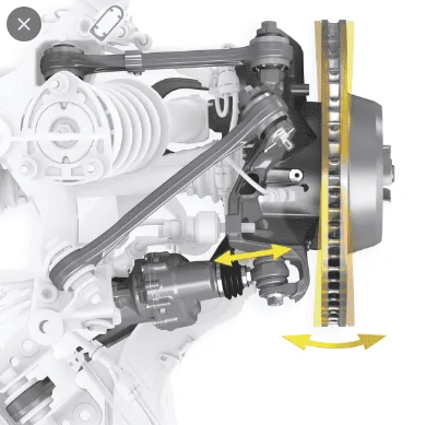

There are many ways to accomplish RWS.
Porsche has RWS on the 911. It uses variable length tie rods. Simple actually.
