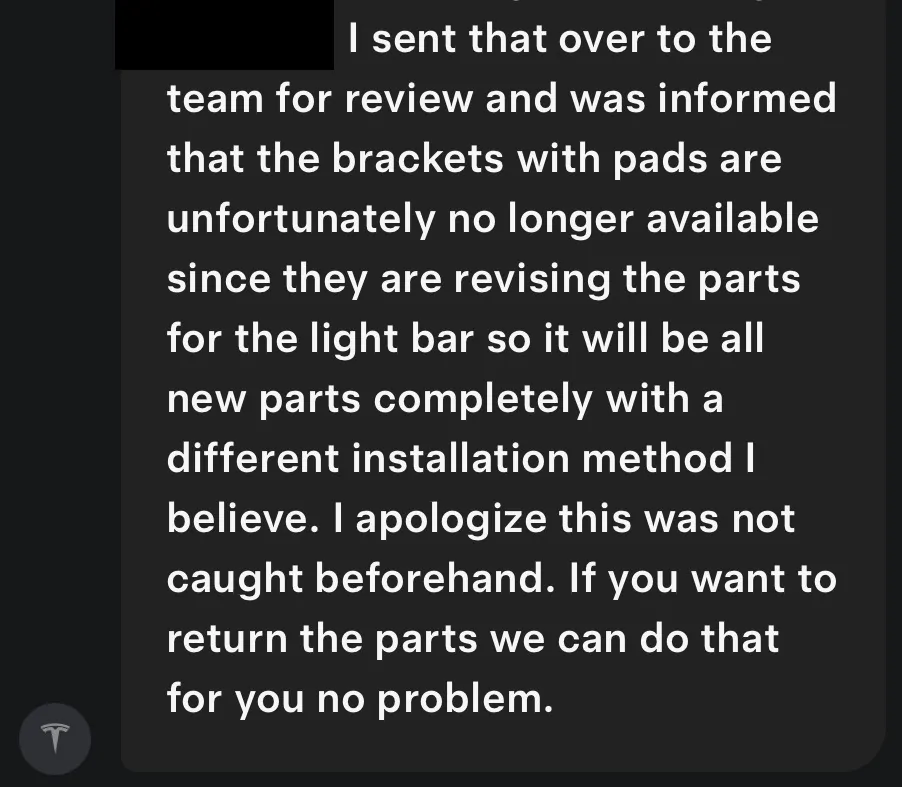

So as an update to my prior post about my OTC parts order missing the metal pads... it looks like I'm not going to be able to get them as Tesla has put them on restriction pending a whole new mounting process that's yet to be finalized (per chat with my SA - see below):
Tesla Cybertruck Recall bulletin SB-25-90-001 Off Road Lightbar fix - new version with bracket 1770686119480-o3
I asked if they had a new service bulletin that I could use to order the new parts, and that is not available at this time. I let them know I'd hold on to the parts until there was a clear path to both a new mounting solution and an installation procedure.

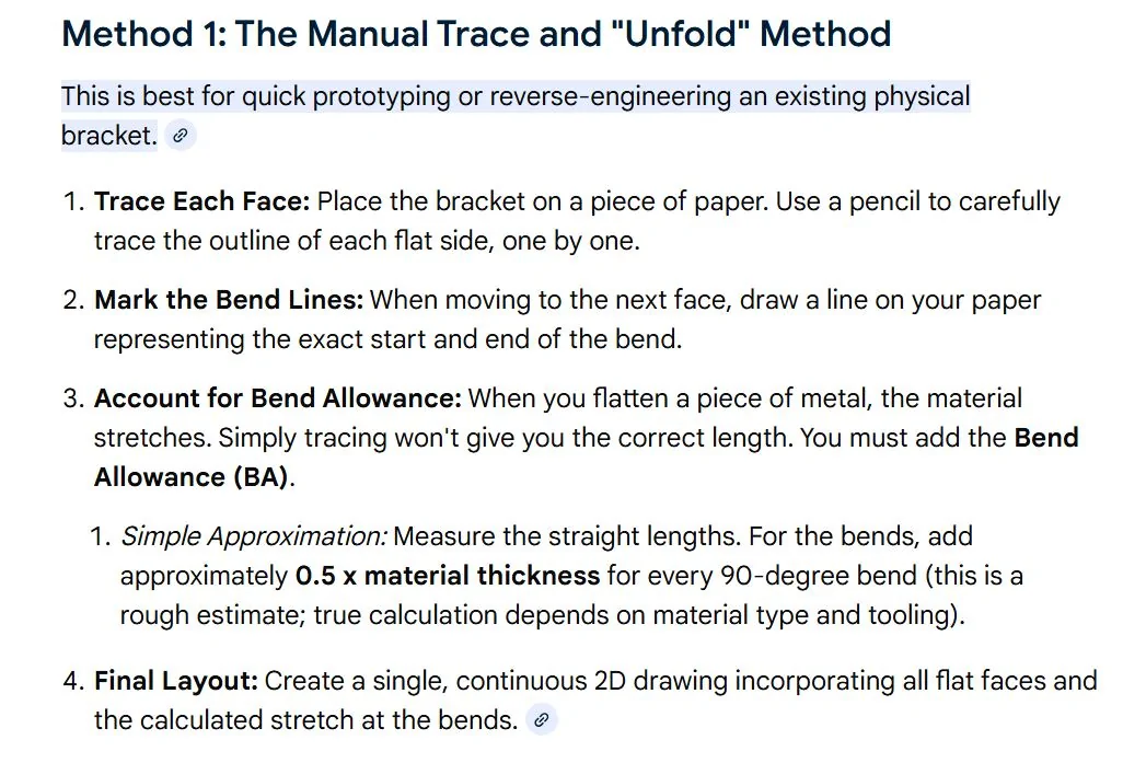

Trace the bracket.. A few youtubes show this... Then mail him the tracing.

For those of us who were waiting for the brackets - I'd be happy to 3D model these if someone is able to get a few measurements. I have a printer and the beast bar installed, so I could do a little prototyping to make sure it fit before finalizing the design.
If we can get this done I can put the final design on Thingiverse, then anyone could get it commissioned in metal by a company like PCBWay. Also it'd be pretty straightforward to model a "pad" that fits over the bracket. Print it in a suitable filament or resin and hit it with some gloss black, good to go. Thoughts? @EightBitWhit would you be game?

There's also the option to use SendCutSend. Great US based shop with some of the best pricing/shipping times. They're my default for any sheet metal designs now, though you do just have to make sure you match their design guide's K-Factor and Inner Radius values. You can even make a part and put it up on their marketplace for others to buy:
