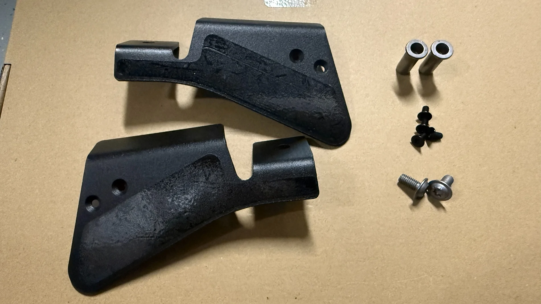

FYI that I was able to pick up my OTC parts order at my local SC yesterday, so I (finally) have the lightbar retrofit parts in hand.
Here's what the whole lot looks like:
2 brackets, 2 Rivnuts, 2 bolts to secure the brackets to the body of the truck (via the Rivnuts) and 4 black screws to secure the light bar to the bracket.
doesnt include the mounting plates for the light bar ends?
It did not - even though the bracket description says "with pad" there was no pad in the bag, so I'm going to have to go back to the SC and see if something changed on the install procedure or if I'm missing parts.

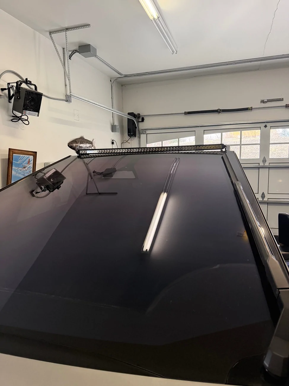

I went with an aftermarket one from Tsportline. 20 minutes to install works great.
