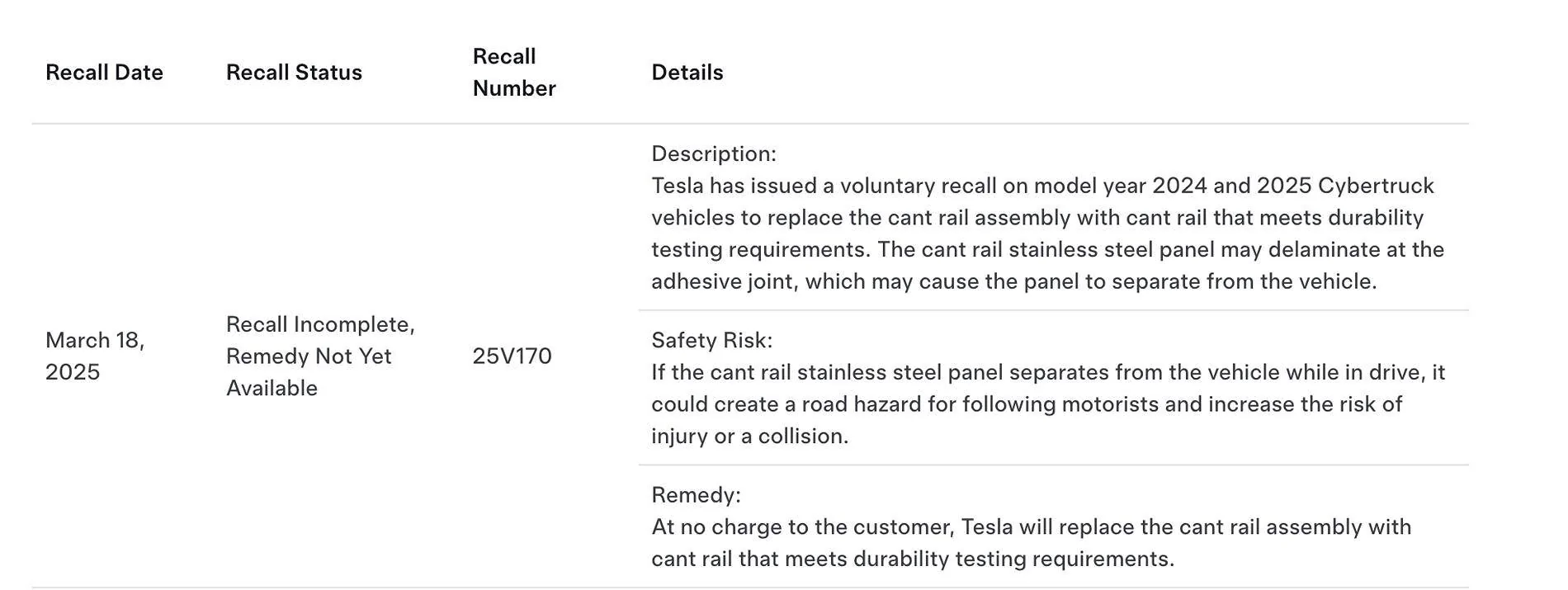

The recall would be all trucks manufactured to include those not sold.
Yes. Mine that I was supposed to pick up today is affected, and my delivery day got pushed to 3/29

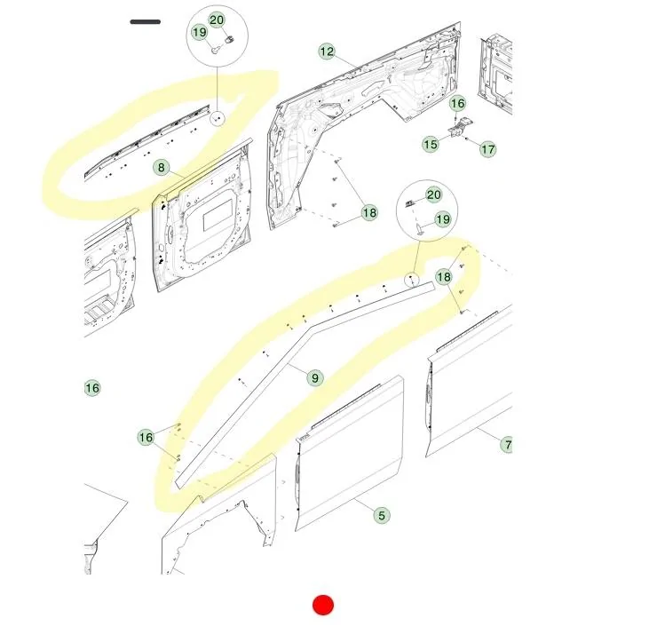

It's not the assembly to the truck that's the issue, it's the stainless bond to the carrier bracket (bracket is bolted and screwed to chassis).

Is it delaminating or is the attachment nut loose?
It’s not the nut, trust me. You can see the adhesive all along the cantrail. I’ve posted it on another thread about it here.
you can see breaks in the adhesive and gaps from it starting to separate. All cybertrucks I’ve seen until last month or two have it.

Does anyone have any idea if this can be a ‘same day’ turnaround, or will we have to leave it overnight?
I'm assuming overnight but thought I’d ask anyway.
May 27, 2024
4,609
5,604
Should take less than a hour to swap both based on service documents.

So how long until a good fix is available? Mine has this issue and I reattached it with my own adhesive. I have a service appointment Monday for it scheduled a while back, but I think I want to wait another few weeks until a permanent fix is figured out since my truck is wrapped.
They gave new version parts now with the stainless welded stud.
