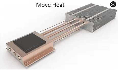

What about another option: a Peltier sucking externally off the chiller or cabin evaporator, or other cooled component under the hood? If you can get enough watts off a cooled surface, delta would be easy, and efficiency would be up too. No moving parts, super compact and cheap, and if a clip on design, low installation cost as well. Maybe use heat pipes for connecting to the frunk from source.
http://celsiainc.com/resources/calculators/heat-pipe-calculator/

One external source of cold that is, usually to our detriment, always available in a refrigeration system is the suction line. If you could replace that with a coaxial line you could get some cold from it. Of course this would change the superheat at the compressor and you would have to open the system to install it and probably have to tweak the charge to get the super heat back to where it should be.
But then the fact that these portable fridges only use 40 watts or so with COPs ranging from 0.4 (Peltier) to say 2 (compressor) suggest that only 10 watts or so of cooling are needed (if the box is loaded with pre chilled stuff).
