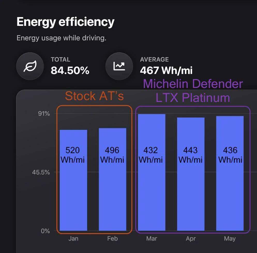

Adding more data. I've been doing a LOT of driving around in beast mode lately and doing "demos" but looks like Michelins are proving to be at least more than 10% more efficient than the AT's. Yesterday on an FSD Drive about 70 miles away with 78 mph top speed I was getting in the 390-410 Wh/mi range. All tires at 50psi. I'm pretty happy with that. I can confirm (as I did in the OP) the LTX Plats don't have quite as much traction on a beast launch, but it's a small trade-off for a bit more range, comfort and lower noise.
Tesla Cybertruck Review - Michelin Defender LTX Platinum Tires - Cyberbeast Screenshot 2025-05-12 at 9.30.28 AM
