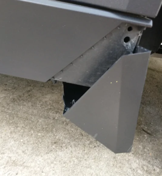

FSD drove right over a tire on the highway
Anyone had any luck getting these not through a business?
No option to order online although the part is $15
This a swing by the service center and ask kind of thing, because they don't pick up the phone per the usual.
They tend to be responsive via the message function in Tesla app.

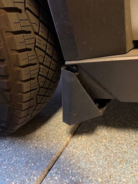

I had another pair sheered off last month. Sh#t design proven up once again. Waiting for next recall or other appointment to address. Approximately $60 parts and labor for each pair I’ve had to replace.
Yea $60 ok no problem, figure at the rate I am going will need 2-3 a year for highway driving and a CASE if I drive off the pavement.
Feel like this is a recall item coming
$60 no problem, 6 hours of time AND $60 is rough
Make an app service appointment for other and request the part.
I've gotten replacements that way

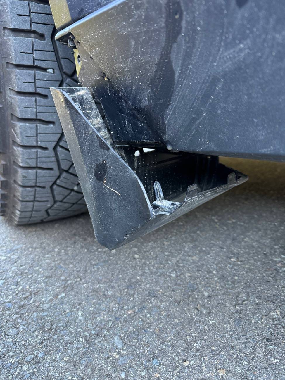

The part was $15 from Tesla when I replaced mine. There are four T-20 screws that hold it on. To get to them you need to partly remove the rocker cover. You can leave front wheel fairing attached, then remove six 10mm bolts from bottom of rocker, pull the lower corner of rear wheel fairing off to access another 10mm bolt. Also remove one push pin from rear liner. Then pull rocker toward you and you can access the screws.
https://service.tesla.com/docs/Cybe...UID-D0420707-8D36-4266-9B2A-4B636FBA962E.html
Yes. I broke mine on a snow/gravel mix a few months ago, removed the broken part and ordered a new one for 15 + tax. Because the nearest SC is over 100 miles from here, I arranged to pick it (and my wheel covers) up from a SC when I’m en route on a trip this week. The removal of the broken fairing wasn’t difficult once I saw how it’s done. I think it will be easy to put the new one on. I agree with another post that it would be nice to have a cover for the gap when the fairing is off for off-road or whatever. I have it covered with Zip tape to keep dirt, etc. out.
