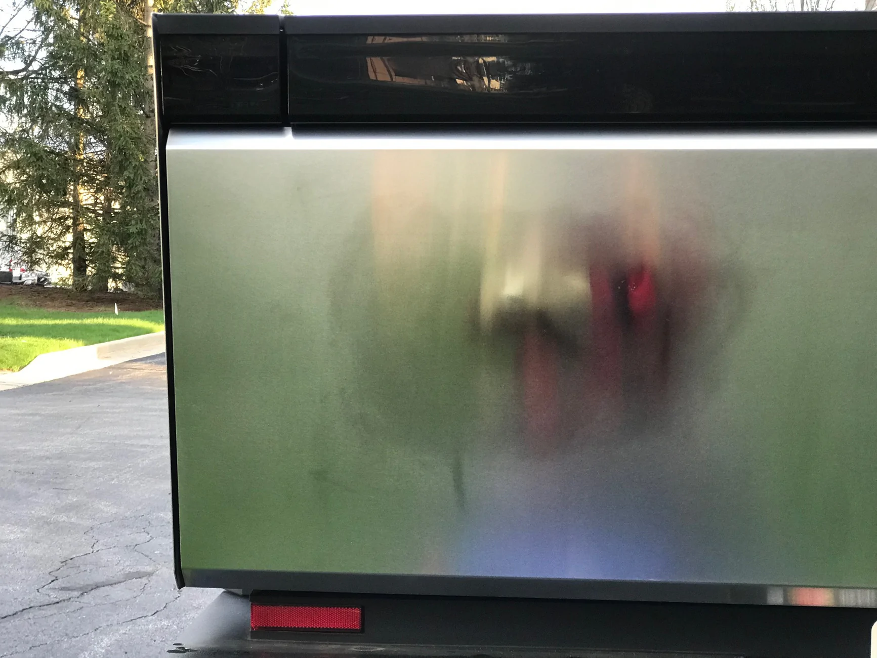

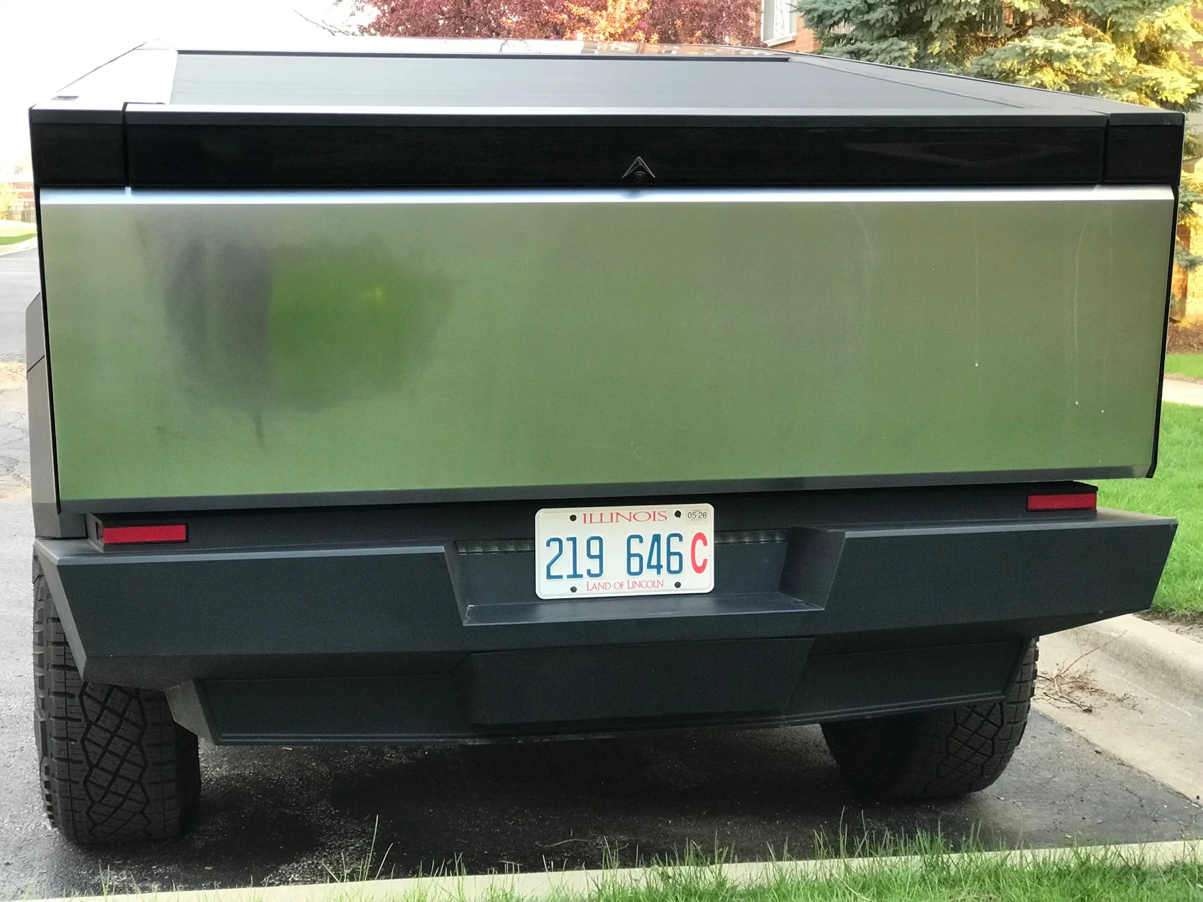

Had a chance to try out Walter Blendex pads. This is what it looked like before-- almost a mirror finish where I used the metal polish.
Tesla Cybertruck Magnetic sticker damage - how to restore stainless steel finish? IMG_6874

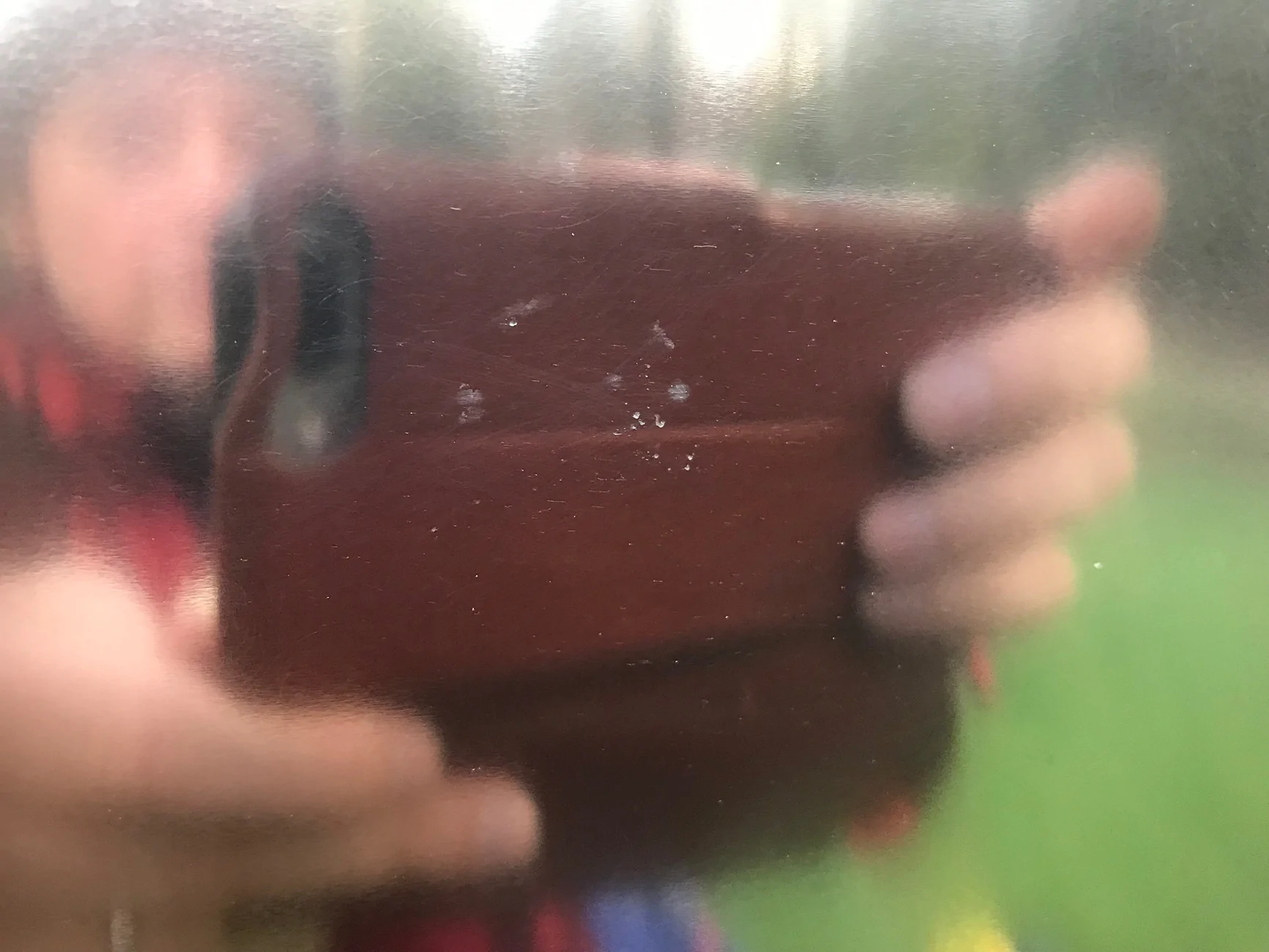

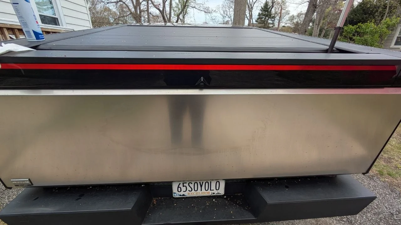

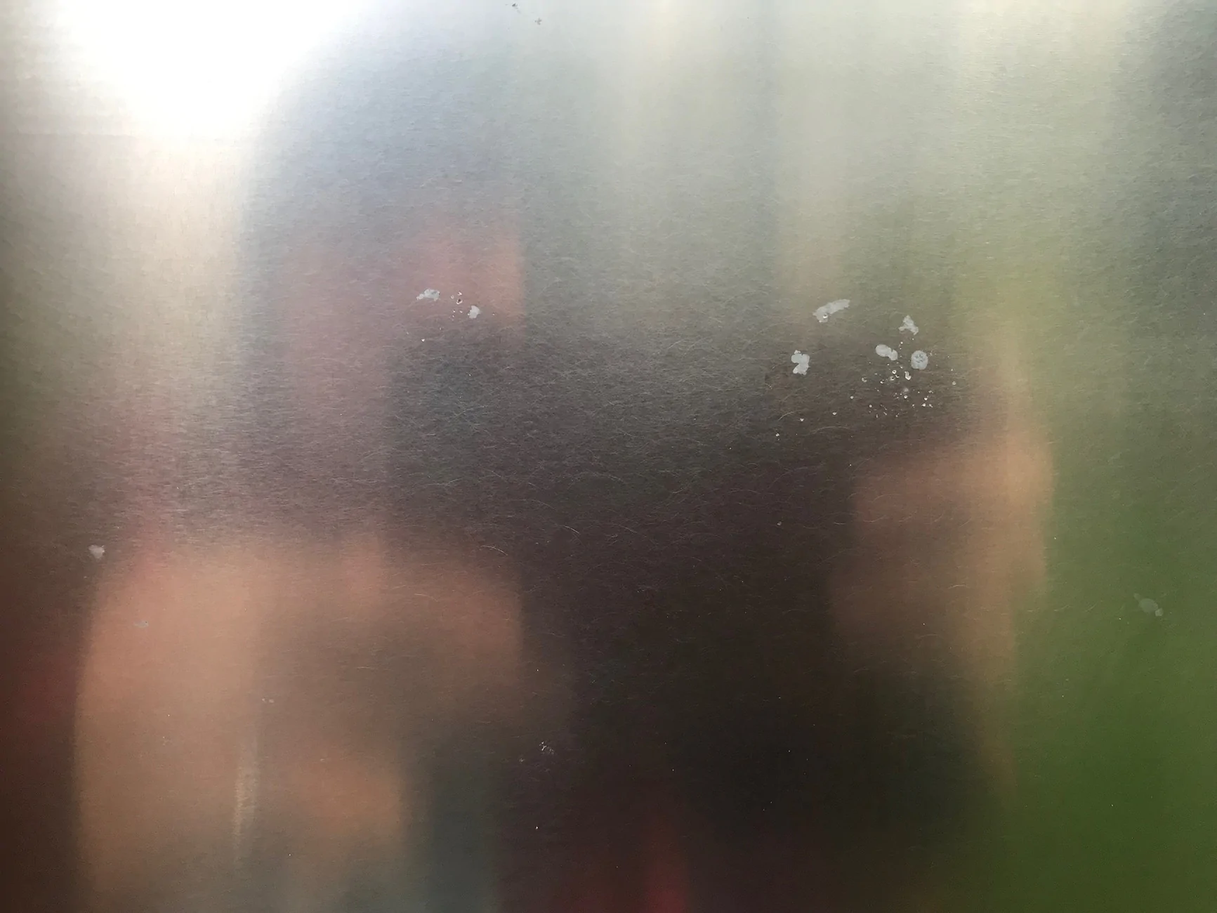

This is after Walter Blendex 614 and 615. The mirror spot is gone. I only did the left side of the tailgate and the finish matches well. I can still see the etched spots but they are barely noticeable now . I will probably need to get the more aggressive 613 pad to get them out.
Tesla Cybertruck Magnetic sticker damage - how to restore stainless steel finish? IMG_6876

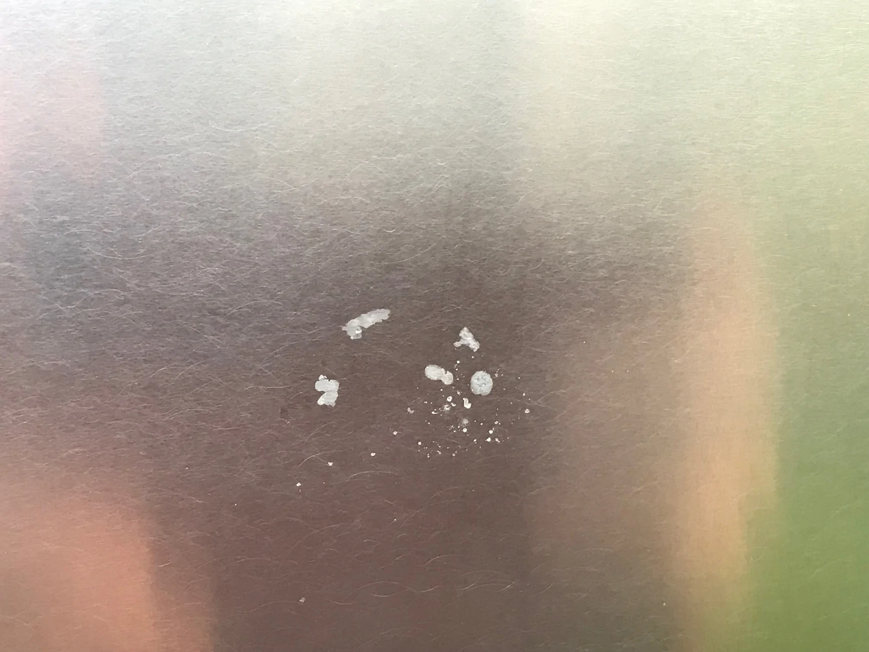

Here are the etched spots now. Still visible, but only if you are looking for them. So success overall.

It's a great reminder not to attach magnetic emblems to the CT’s stainless steel panels. The SS pitting is pretty significant.
You would need to grind a significant amount of material away to totally eliminate the pitting.

Man that pitting is WILD. I'm still not sure that the viewing angle isn't playing tricks on me, but it looks like 1mm deep craters! I've had similar success with the Blendex pads, correct throw DA sander, and Citrisurf 77 for post sanding passivation.
