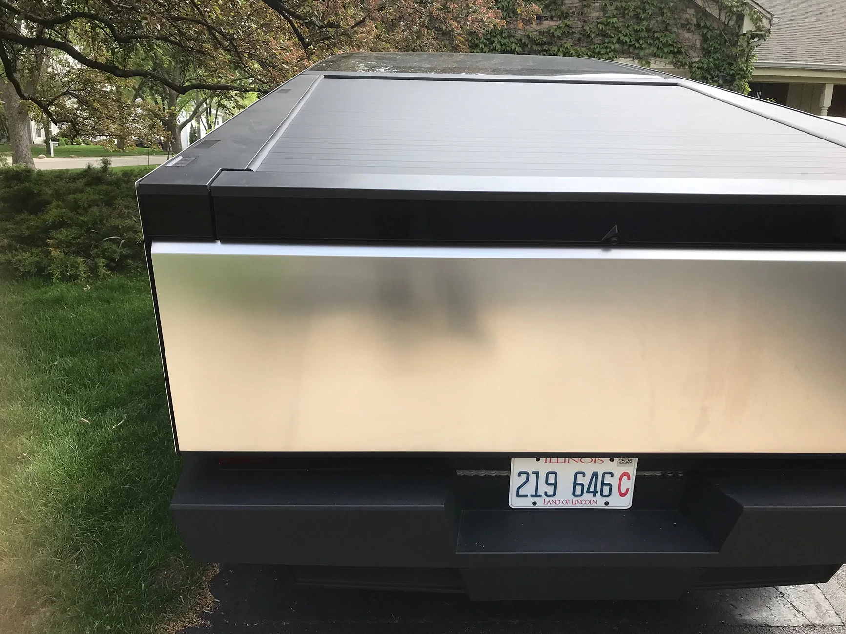

Had a chance to try out Walter Blendex pads. This is what it looked like before-- almost a mirror finish where I used the metal polish.
Tesla Cybertruck Magnetic sticker damage - how to restore stainless steel finish? IMG_6874

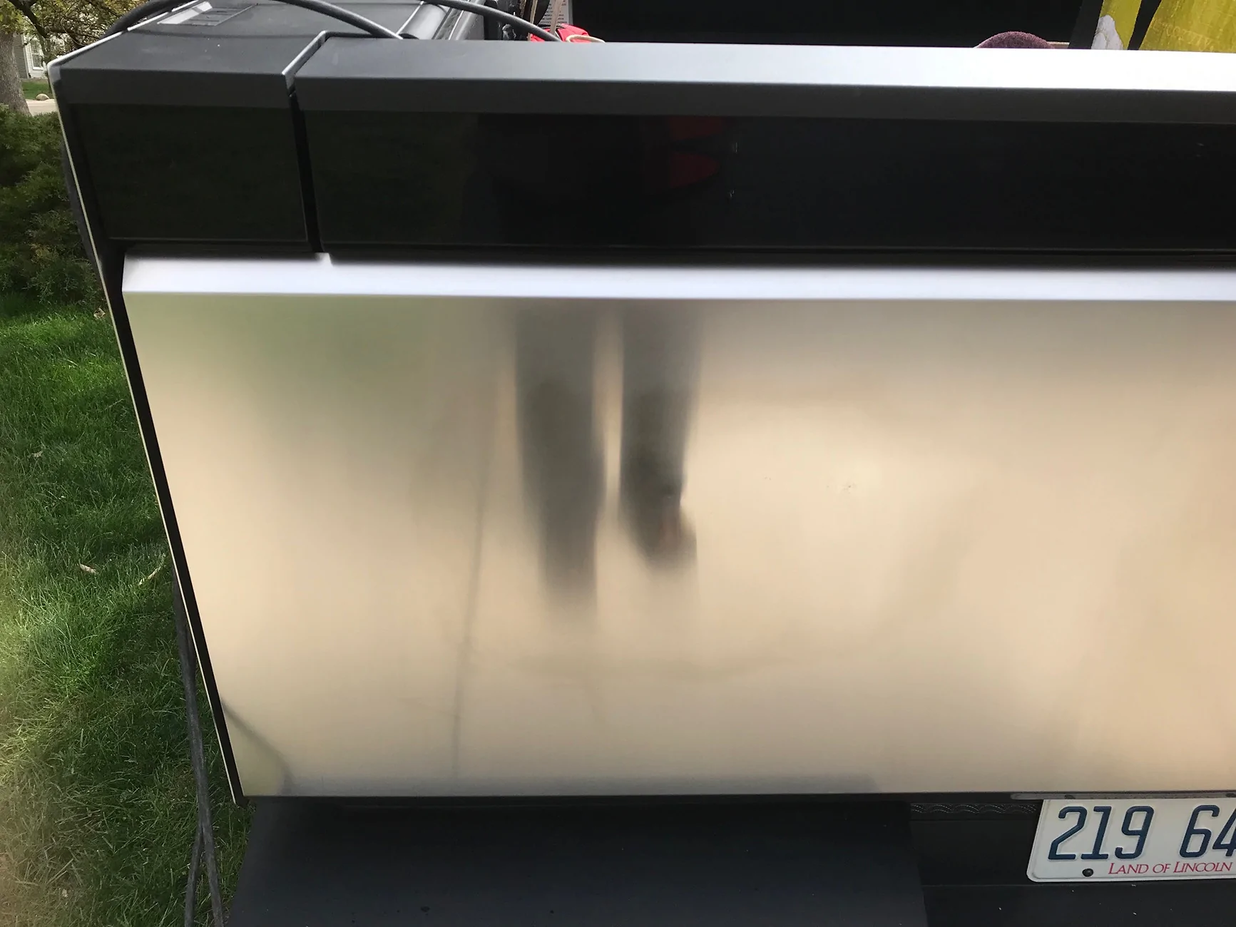

This is after Walter Blendex 614 and 615. The mirror spot is gone. I only did the left side of the tailgate and the finish matches well. I can still see the etched spots but they are barely noticeable now . I will probably need to get the more aggressive 613 pad to get them out.

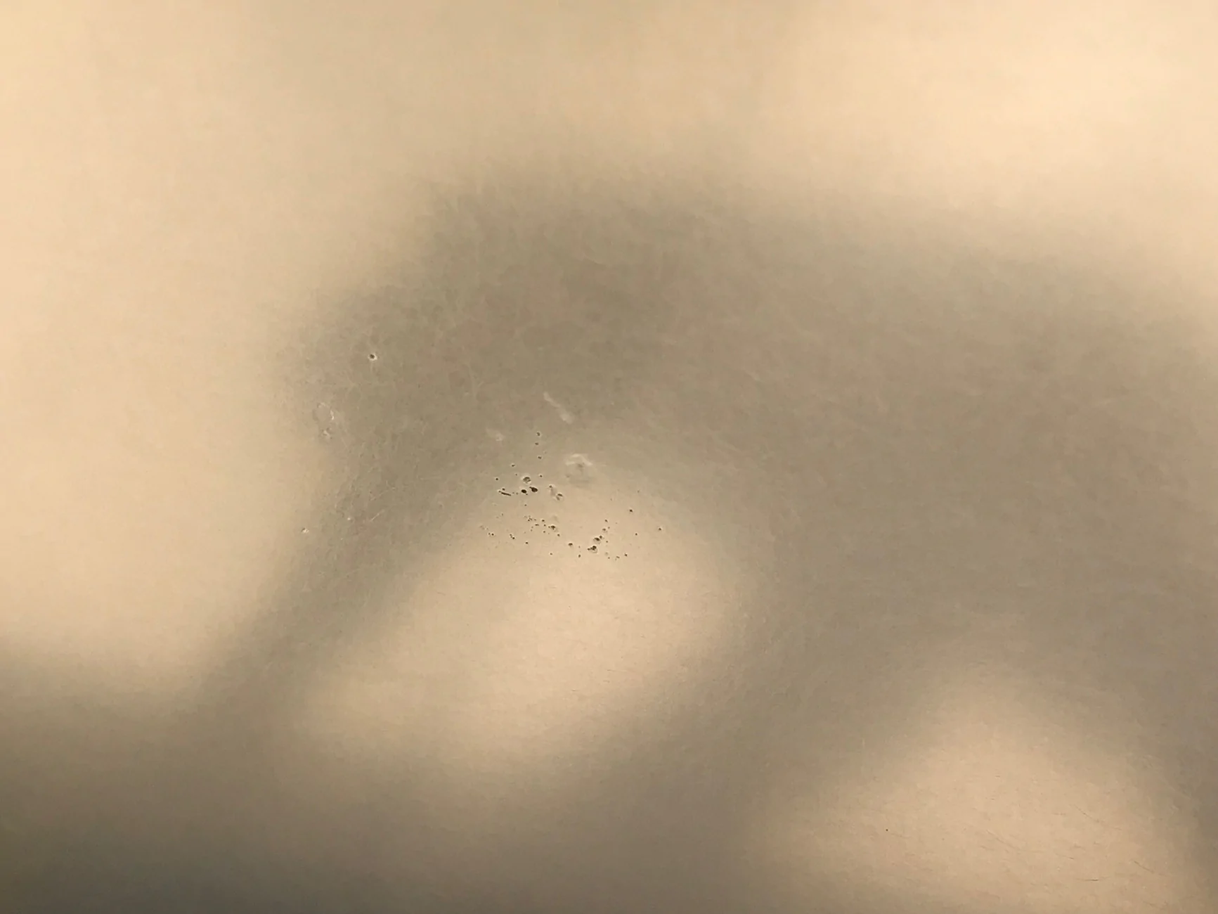

Tesla Cybertruck Magnetic sticker damage - how to restore stainless steel finish? IMG_6876
Here are the etched spots now. Still visible, but only if you are looking for them. So success overall.
Tesla Cybertruck Magnetic sticker damage - how to restore stainless steel finish? IMG_6877
Tesla Cybertruck Magnetic sticker damage - how to restore stainless steel finish? IMG_6878

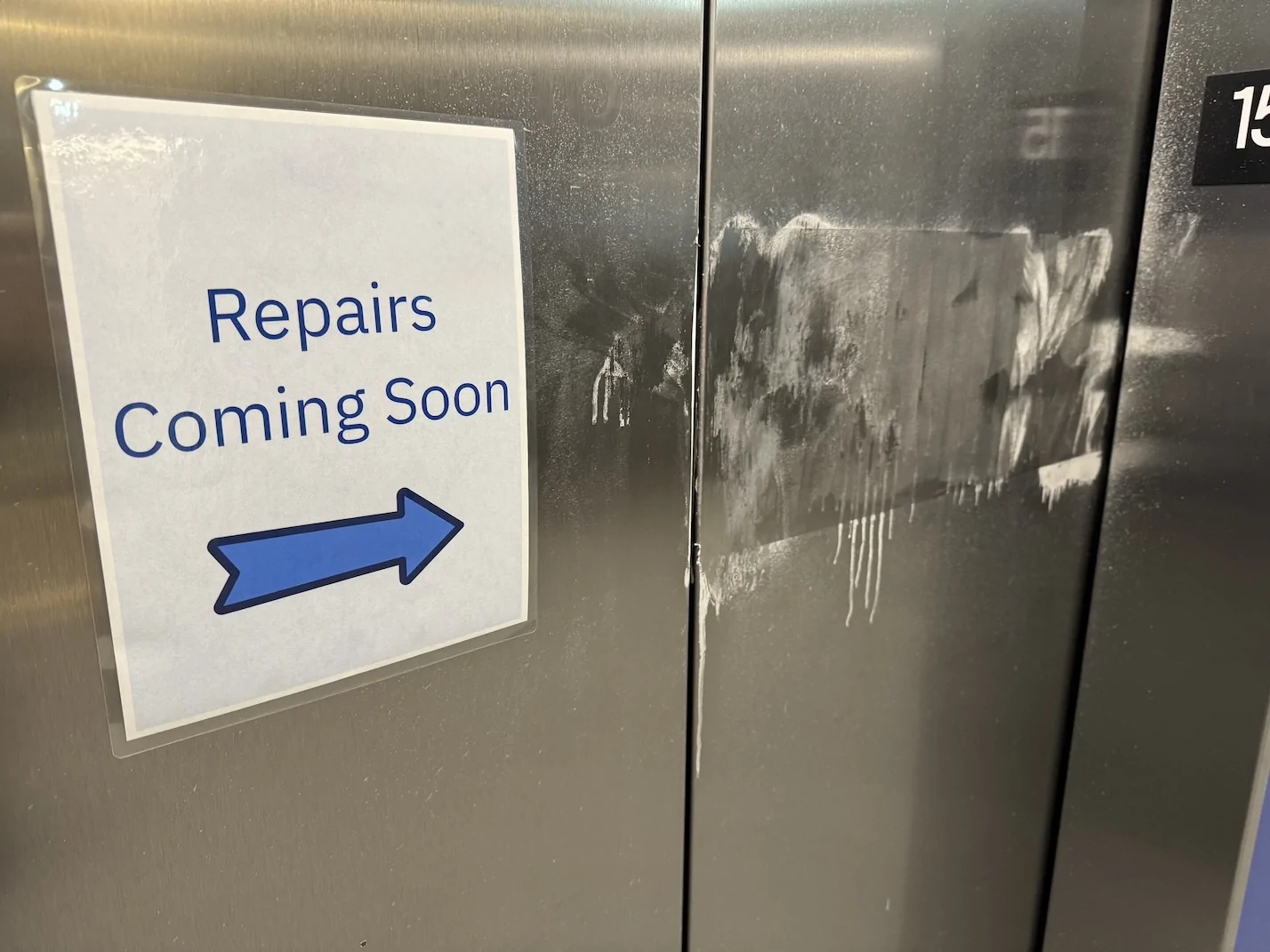

Can I borrow your sander? Apparently I need it at work:
Tesla Cybertruck Magnetic sticker damage - how to restore stainless steel finish? IMG_2073
I'm dying to know what the hell they put on a stainless elevator door to make this horrific mess lol

It's a great reminder not to attach magnetic emblems to the CT’s stainless steel panels. The SS pitting is pretty significant.
You would need to grind a significant amount of material away to totally eliminate the pitting.
Sure thing. I also have plenty of Walter Blendex pads now, as they come in packs of 20.
