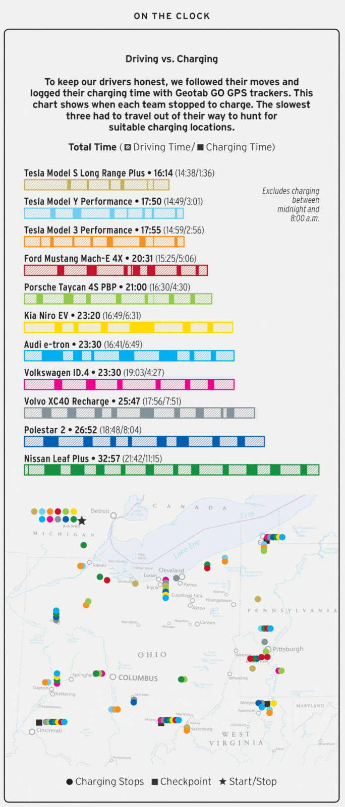

You have the 1000mi. round trip (RT) race. Tesla just finished 1,2,3 in the Car & Driver 1000 race. Their finish times 16, 18, 18 hrs.
https://www.caranddriver.com/features/a36877585/ev-1000-11-electric-cars-long-distance-race/
Tesla Cybertruck Road trip capable? 4CDB557F-F373-4D30-BBB0-FDADC4079B57
To a soul all drivers were asked if they’d do the trip again? Response, including Tesla winners, if they were to do the trip again, they would do one thing differently: drive a gas car.
