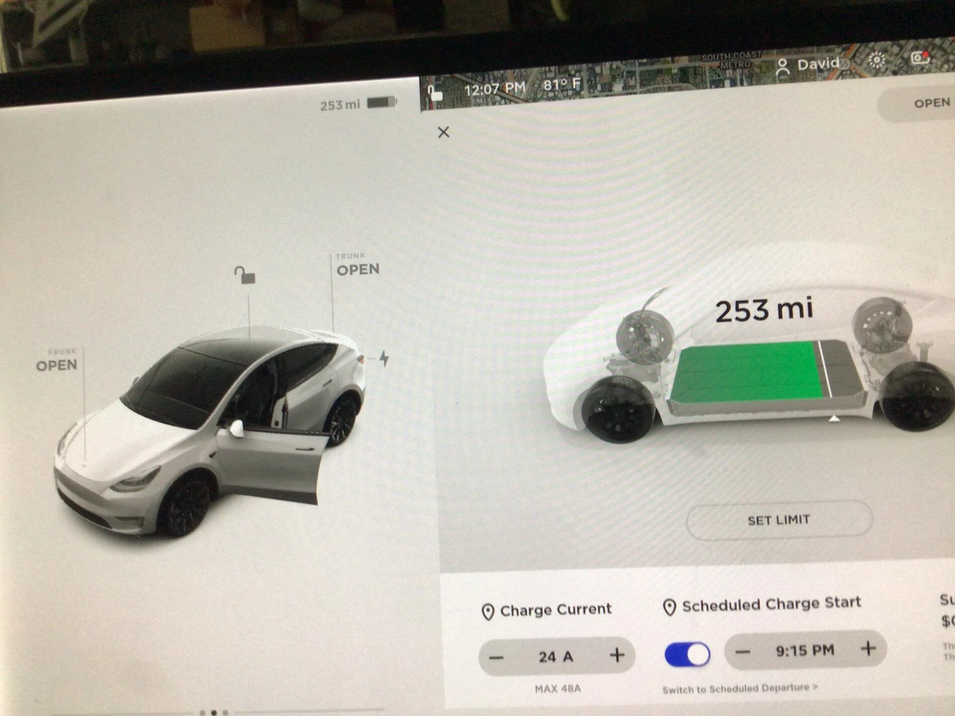

I did two things to help preserve battery health with our 326 mile range DM Model Y. I set the charging limit to 80% (roughly 260 miles) when home charging. I also limit the charge current to 80% of the 220v 30amp circuit breaker rating (24 amps).

I did two things to help preserve battery health with our 326 mile range DM Model Y. I set the charging limit to 80% (roughly 260 miles). I also limit the charge current to 80% of the 220v 30amp circuit breaker rating (24 amps).
What charger are you using? With the HPWC you must either take off the cover and operate a rotary switch (Gen 2) to do that or log into the HPWC (Gen 3) hot spot. You can, AFAIK, only do that with a Tesla charger while sitting in the car. I really wish you could control the charging rate from the app (through the API).
