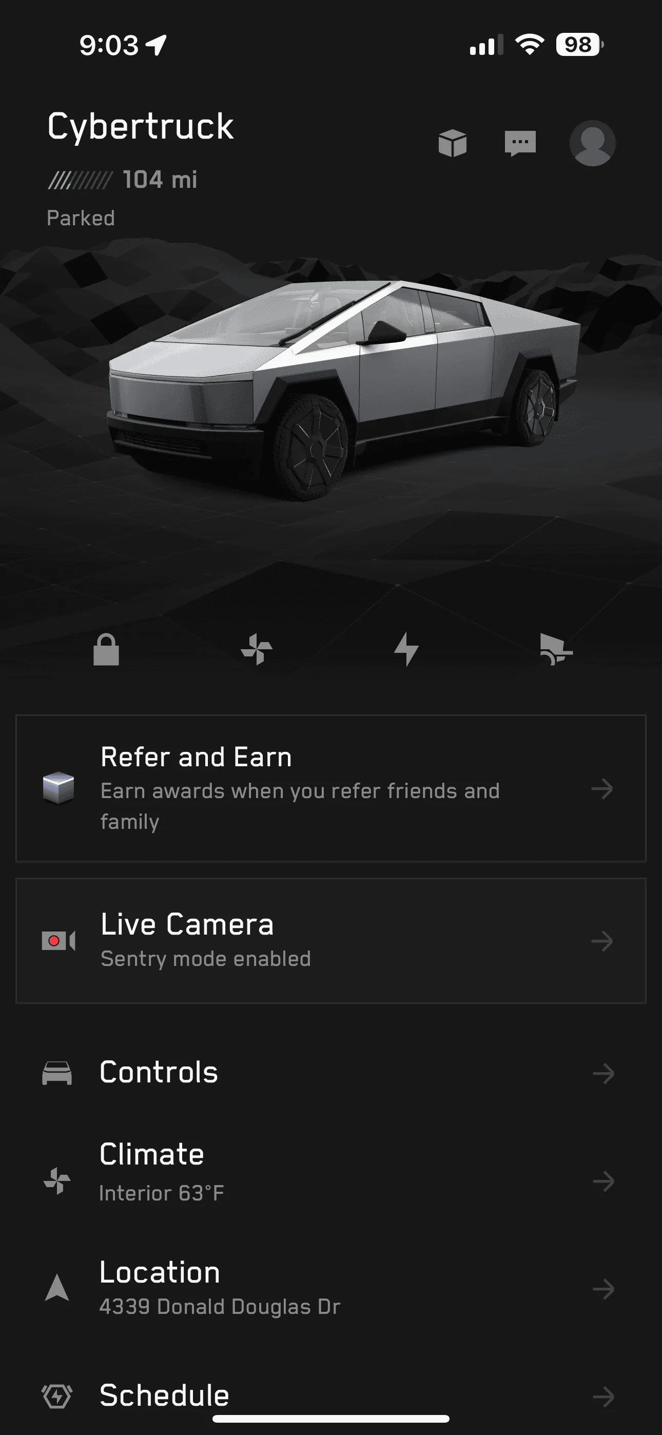

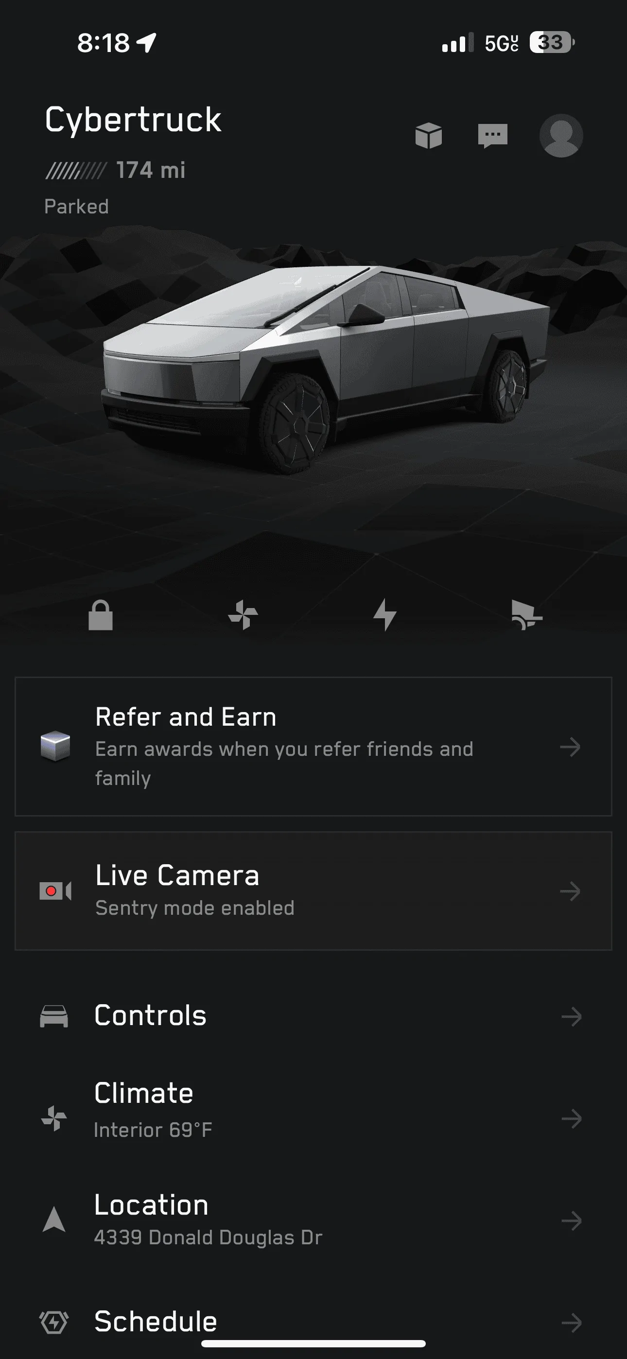

While I'm not new to Teslas and Sentry Mode, I was a bit surprised at how much power it uses. Took the Cybertruck to the airport for a quick 3 day trip. Left it on Friday night with 174 miles. By Sunday night, it was down to 117 miles. Monday morning it was down to 104 miles and by Monday evening when we got back, it was at 91 miles. Almost exactly 3 full days and 83 miles of range just sitting there with sentry mode on. No temp controls (dog or camp mode) on and checked the app once or twice a day to check in on the battery.

Hope so but then again, I had a pal park his Model 3 with Sentry turned on at the airport with 230 miles. Came back 10 days later and it was down to 64 miles. Going to turn sentry off tonight and see how much drain I have.
