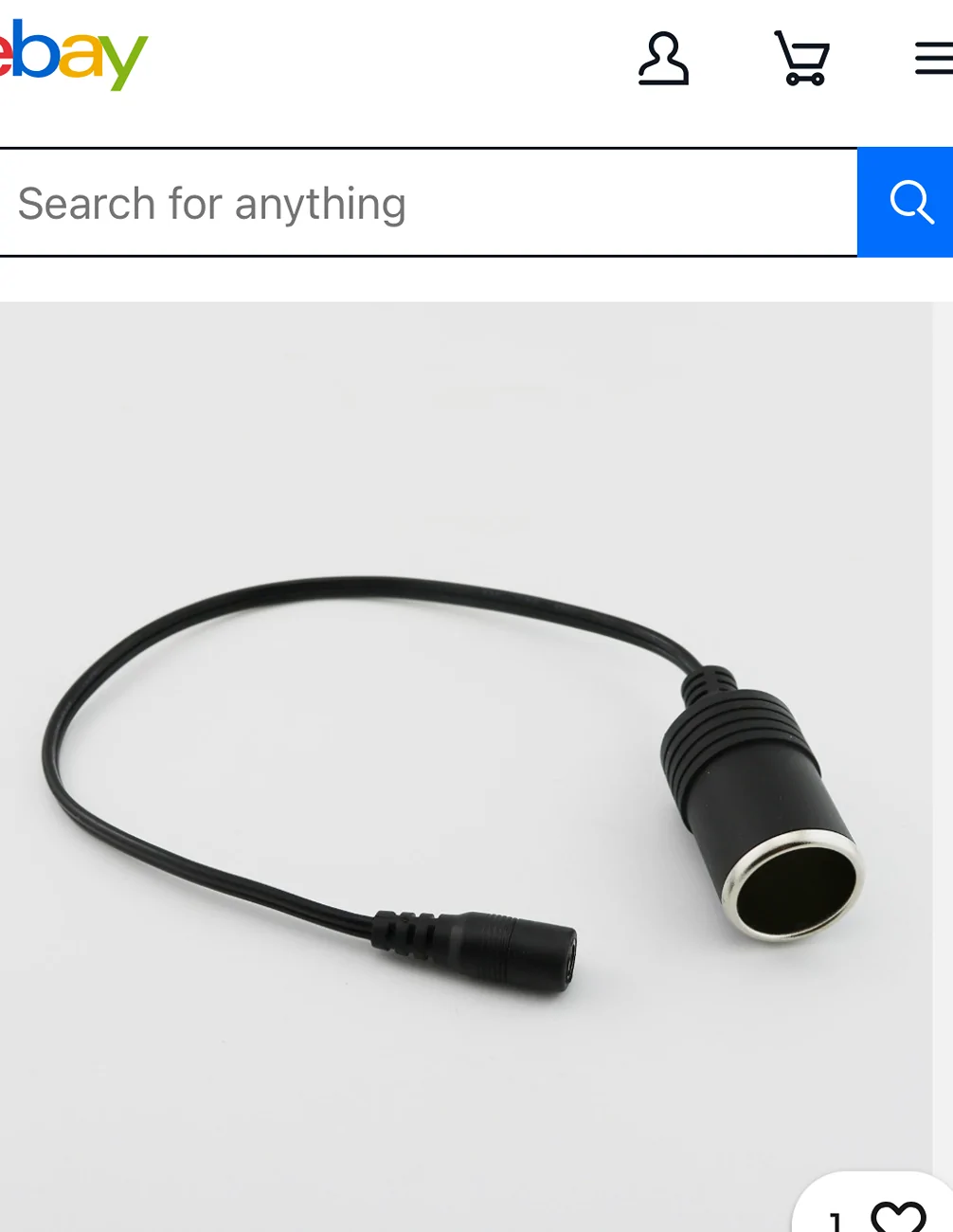

I'm curious as to how I would connect this cord to the fridge though?
With something like this in between, assuming that the mini fridge has a 12 v cigarette lighter cord?
Tesla Cybertruck So I thinking of doing this: USB-C to 2-Pin DC for CyberFridge 1775330888254-uf
