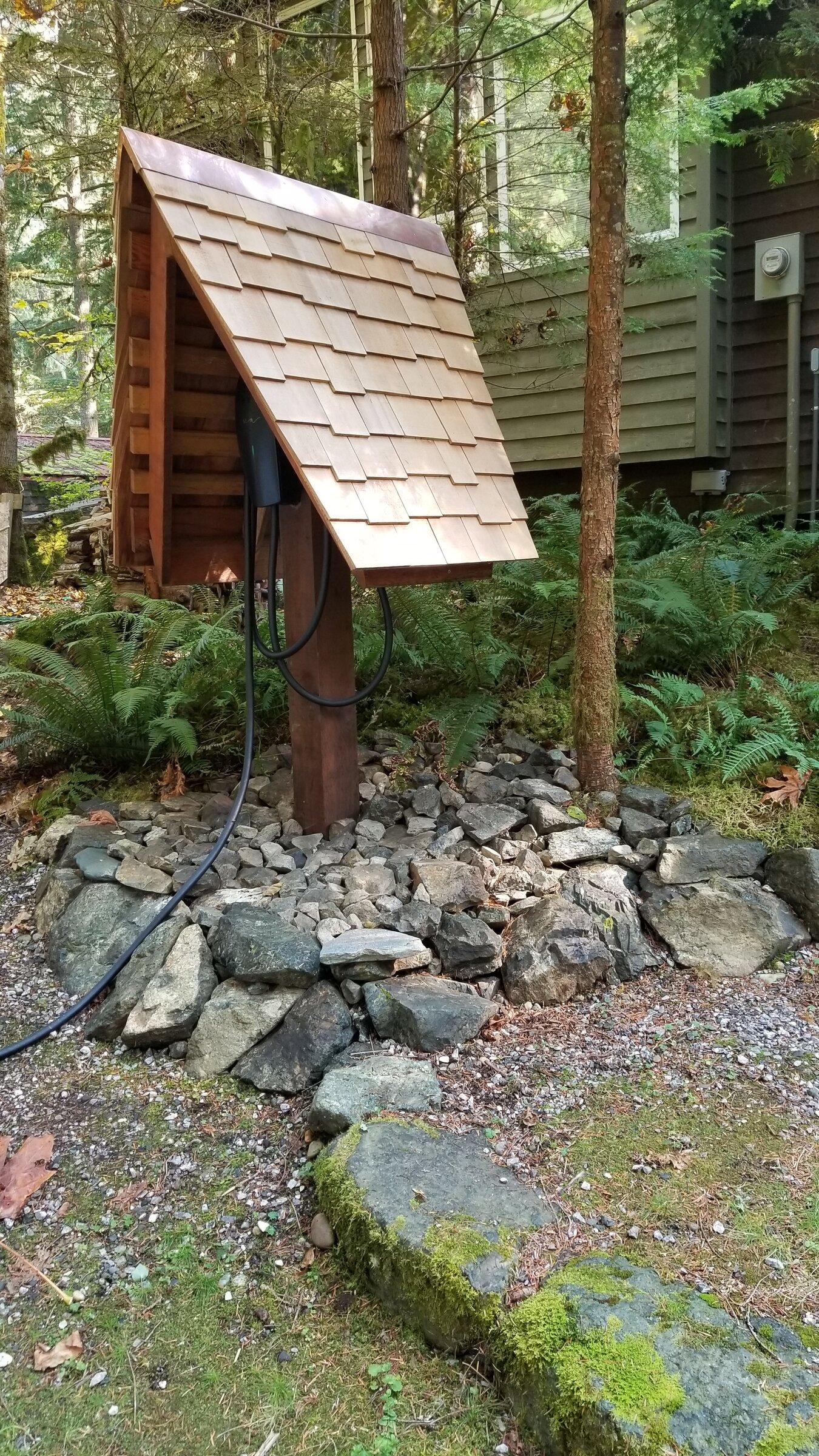

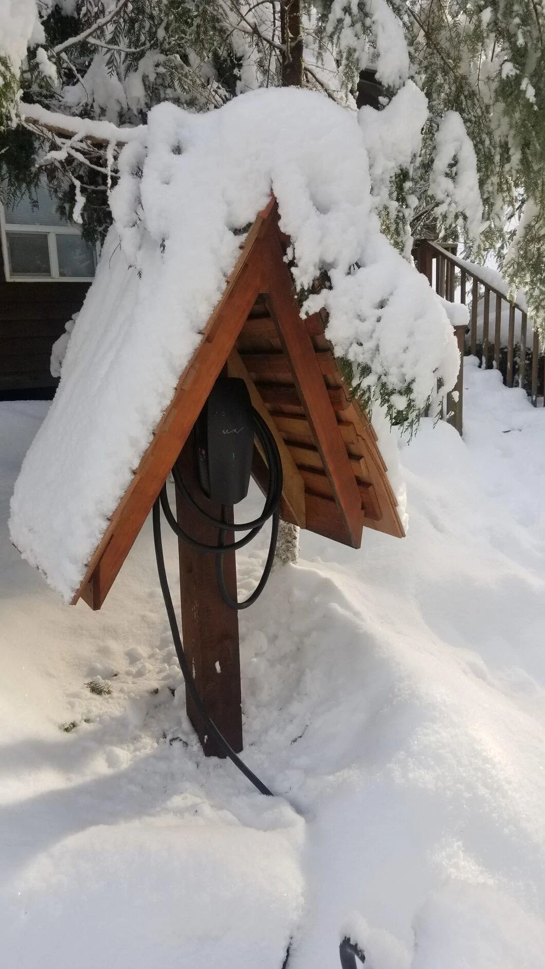

That's silly. Supercharging costs an average of around twice as much as home charging. For under $500 plus the Wall Connector I built this charge solution for the driveway of my ski cabin. If I had omitted the roof the entire project, from start to finish would have been under $150 (I already had the spare Wall Connector):
Tesla Cybertruck So, Let's Talk About Size Again... 20200117_122904
Tesla Cybertruck So, Let's Talk About Size Again... 20201002_121516
Keep in mind, the Wall Connector is weather rated, so I didn't need to build a roof but it's in a rainforest and I didn't want it turning green and becoming encased in ice, so I built the roof mostly from scrap lumber in my lumber pile. The conduit and electrical wire, 60 amp breaker, electrical box, elbows and other fittings only less than $150 from Home Depot. I had the post leftover from another project.
I find it perplexing why people think you need to charge an EV indoors. Most Superchargers are out in the weather and they carry up to 20 times the current. Adding a breaker and some conduit to an existing electrical panel is generally super easy, people just feel it's daunting because they don't know how to do it. If that's the case, just install the conduit, post and Wall Connector and let an electrician hook it up. It should only take a couple of hours to add the breaker and run the wire. In my case, it was easier to just do it myself since I already knew how.
On the far right of the last photo you can see the conduit I ran up the wall next to the meter. It enters the wall cavity below the electrical panel (inside the cabin) and then runs up into the bottom of the panel to a 60 amp breaker. The hardest part was digging the trench through soil that was more rock than soil. All those rocks scattered around the base of the pole came out of the trench I dug.
Now I have a place to charge my Cybertruck too. At 48 amps of 240 V charging and a 24-foot cable on the Wall Connector it's practical to charge two EV's from the same cable because I can usually top up a vehicle in 2-3 hours. And my electricity comes from a small hydro plant with two large Pelton wheels. It's grid power but I'm at the end of the line.
Most people who want to charge in their driveway don't need to trench, they can just mount the Wall Connector under the garage eave and run power through the wall to the electrical panel. Having EV charging increases your property value. If you rent, tell your landlord you will hire the electrician if he buys the wire and charger. This is a much better solution than using the Mobile Connector out of doors (which I did for one winter).

Dude… that is awesome.
