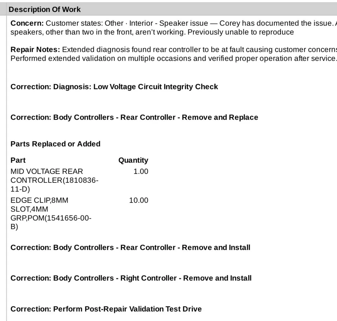

As a reminder, in my specific case, it wasn't losing a few miles a day. It was losing 10kWh per day (20 miles per day). But because they had the car for more than two weeks, they were able to actually locate the issue. They just kept saying there was no issue until they finally realized that the car had a dead battery over the weekend and they were forced to jump it. Anyways, debugged to being a mid-voltage battery drain. I guess the high voltage was always trying to top up the low voltage system? No idea. But the battery drain since then is almost zero, other than there still being a good drain if the car has cellular signal and it communicates to the mothership.
I do need to do some more testing, since I just went into Tessie to show a before and after screen shot of my battery levels, and I'm actually showing huge battery drain, but I very much suspect that's due to Sentry Mode and cellular communications.

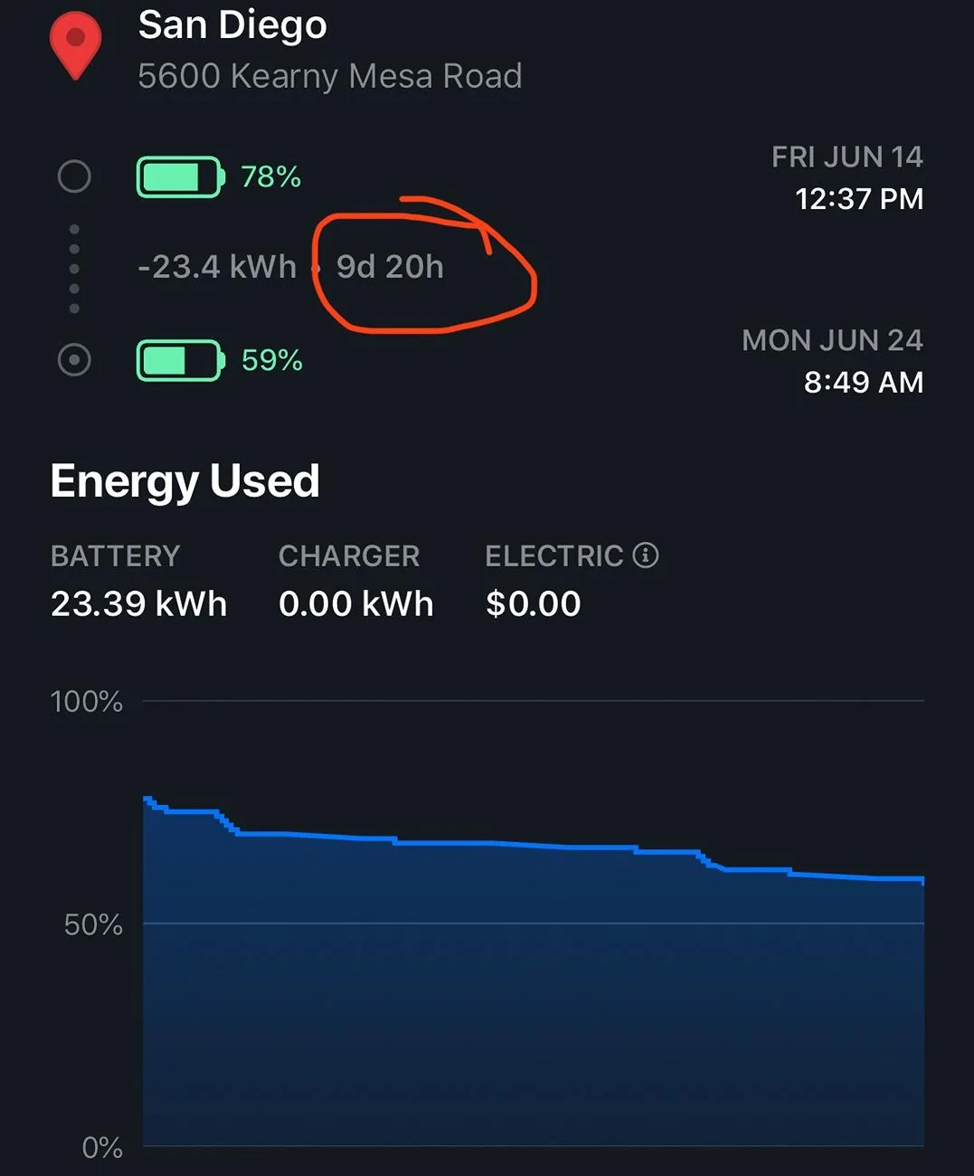

Attaching the fix invoice from Tesla, and attaching the 9 days the car sat idle at the Tesla service center. Around 4 miles per day loss, and the majority of that was Cabin Overheat Protection (you can see the extra drain during daylight hours). Anyways, I'm quite happy with the repair and glad that I don't need to super charge the vehicle every 4 or so days.

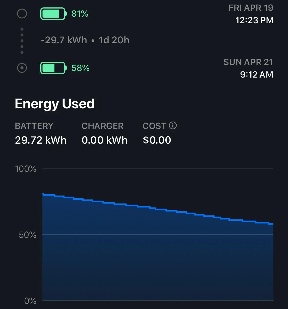

I've seen other people discuss phantom drain on their CTs, but I haven't seen any discussion with specifics about what is normal and what isn't. Back in the day I'd read about people having a 2% drop per day and them being upset about it. I'm seeing more like a 10% per day drain.
I left my CT for just under 2 weeks in an underground garage with sentry turned off, no wifi or cellular coverage, and I wasn't in town to accidentally have the car see me as nearby. I came back and the car went from 80% SOC to dead zero. Tesla had to send out a tow truck to give me a jump start (which is funny since I gave away my 12v jumper when I got the CT, even though that would have saved me the 12v jump I got). Needed the jump in order to unlock the charge port to plug it back in to my L2 charger (even with the flap open, the CT wont accept a charger being plugged in).
*Since* then, I've added the truck to Tessie. Even today on 2024.8.12, I'm seeing 10kwatts of power over 18 hours of being idle. Or a few days ago, while camping, I had 30kwatts consumed over 48 hours of it being parked (though that's not a great example as I was frequently around the car).
More specifically, while camping outside the truck, even with my app closed to prevent it from seeing me nearby, I'd hear the high voltage system click off every 13 minutes. Very specifically 13 minutes. Same sound you'd hear when you plug it into a charger and the high voltage system switches from 800 volts to 400 volts. Then ~30 seconds later (I didn't time it), you'd hear the two clicks of it getting enabled again. What I think is: the truck is going into the proper idle state, and then it's being woken up for some reason.
I don't have a good way to confirm this, but I have a feeling that the car is keeping the battery pack warm for some reason. It's somewhat just a guess with a few other signs that lead me to that feeling, but very much nothing formal. So, are other people experiencing the same? And any suggestions on a way to monitor the battery temperature over time to confirm/deny my "feeling"?
