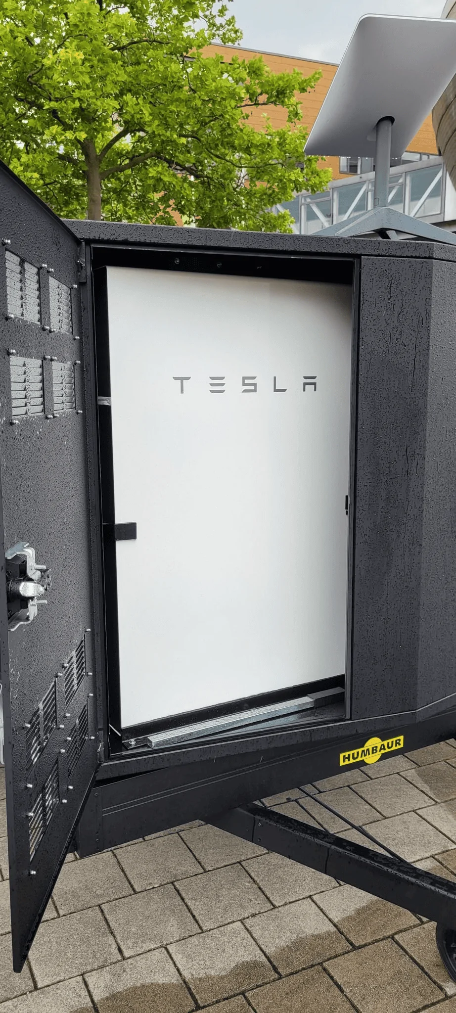

3.2kW so around 350W panels x 9. Also has a powerwall inside it!

I had no idea a powerwall could be laid down flat. I figured it would not be recommended work due to the liquid cooling. Apparently that is not true. 🤷‍♂️

It actually does look upright, in the front of the trailer

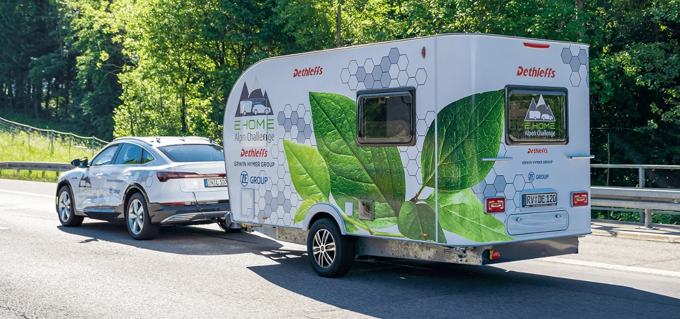

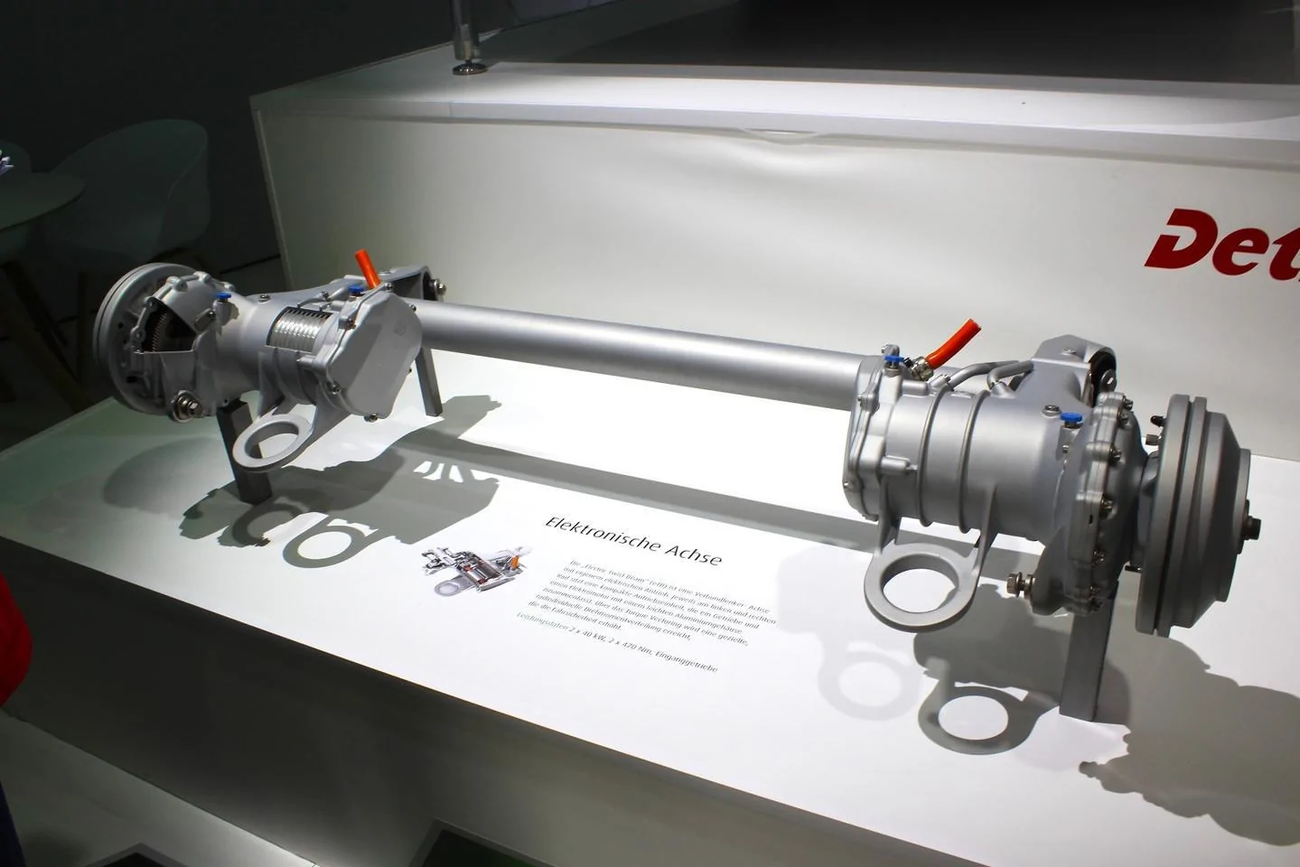

Thor pushes forward with self-propelled electric camping trailer.
Thor Industries and German automotive supplier ZF Friedrichshafen are teaming up to clear the hurdles that stand in the way of a viable production trailer that uses electric motive power to move its own weight. The self-propelled trailer promises to be a critical tool for eliminating the efficiency and range reductions a trailer makes on its tow vehicle
By C.C. Weiss
January 13, 2022
https://newatlas.com/automotive/thor-dethleffs-electric-camping-trailer/
In July 2021, Dethleffs and ZF put the E.Home Coco to a major real-world test behind the Audi e-tron Sportback on a vacation-style journey they dubbed the Alps Challenge. Starting off with nearly-full Audi (96.4 percent) and eTrailer (99 percent) batteries, the team towed the E.Home Coco 240 miles (386 km) from Dethleffs' HQ in Isny, Germany to Lake Garda, Italy.
Much more than a basic autobahn sprint, the trip also involved climbing and descending through the Alps, including navigating the twists and turns of the Fern Pass Road in Tyrol, Austria. The team completed the journey on a single charge, consuming 82 kWh from Audi's 95-kWh battery and 74 kWh from the E.Home Coco's 80-kWh battery, factoring in the creation of a combined 17 kWh from regeneration.

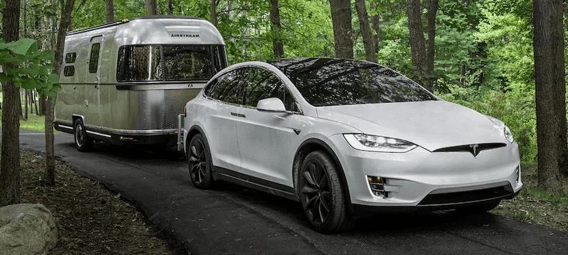

All-Electric, Powered Airstream eStream Trailer Can Assist Its Tow Vehicle.
The power assist helps with the tow vehicle's driving range—good if it, too, is electric.
By Monica Gonderman
Jan 25, 2022
https://www.motortrend.com/news/airstream-estream-electric-drivetrain-trailer/
Thor Industries, owner of the Airstream brand, thinks so. Trailers don't "go" on their own, but that's about to change with the introduction of the Airstream eStream. Its traditional torpedo-shaped aluminum shell veils Thor's own high-voltage electric chassis that distinguishes this concept travel trailer from its multitudinous competition. The electric drivetrain powers the wheels, allowing the eStream to proverbially help carry, well, its own load instead of putting the full burden on the tow vehicle. This motorized assistance helps with fuel economy (or range for an electric tow vehicle) and theoretically reduces vehicular wear and tear.
Josef Hjelmaker, Thor's Chief Innovation Officer, sums up the benefits of the eStream: "The technology we co-developed creates a synchronized relationship between the trailer and the tow vehicle, enabling the trailer to move in harmony with the tow vehicle, reducing the pulling effect required from the tow vehicle. This, in turn, dramatically improves the possible range of the combination. In essence, we've turned the trailer into an electric vehicle. The technology is game-changing for our industry and others."
The Airstream eStream's electric drivetrain unit was developed in partnership with industry titan ZF. It consists of two offset electric motors that each produce 30 kW of continuous power or a maximum of 90 kW. That's about 40 hp of continuous power or a max of 121 hp each—and a maximum of 66 lb-ft of torque.
Energy — about 30 times more than the largest lithium battery system of today's Airstreams—is stored in two high voltage automotive-grade battery modules that provide 80 kWh of power for the eStream's drivetrain and amenities. Thor claims there's enough battery power to survive comfortably without hookups for up to two weeks.
