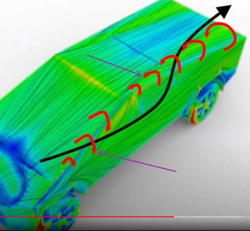

I think you also need to add payload and towing limits. Then payload assuming 10% tongue weight of standardized trailer.
It's also iffy to use the same Wh/mile with trailer when the base vehicles have different Wh/mile. Ignoring truck-trailer specific aerodynamic interaction, the trailer should add the same Wh/mile to each vehicle.
I do have payload in columns farther on the right but I was just giving the basics that clearly show for towing what way better mileage options there are than the CT. The payload of any of them seems pretty sufficient for most use cases (campers). Work trailers may be different.
The "Towing miles/kWh" column was just picked up from different forum examples and seemed pretty consistent for moderate speed / driving.
The trailer adding the same Wh/mile is an interesting point since the air drag and tire friction would be the same ... assumes that the different truck (open bed/tonneau) airflow doesn't impact the front of the trailer.

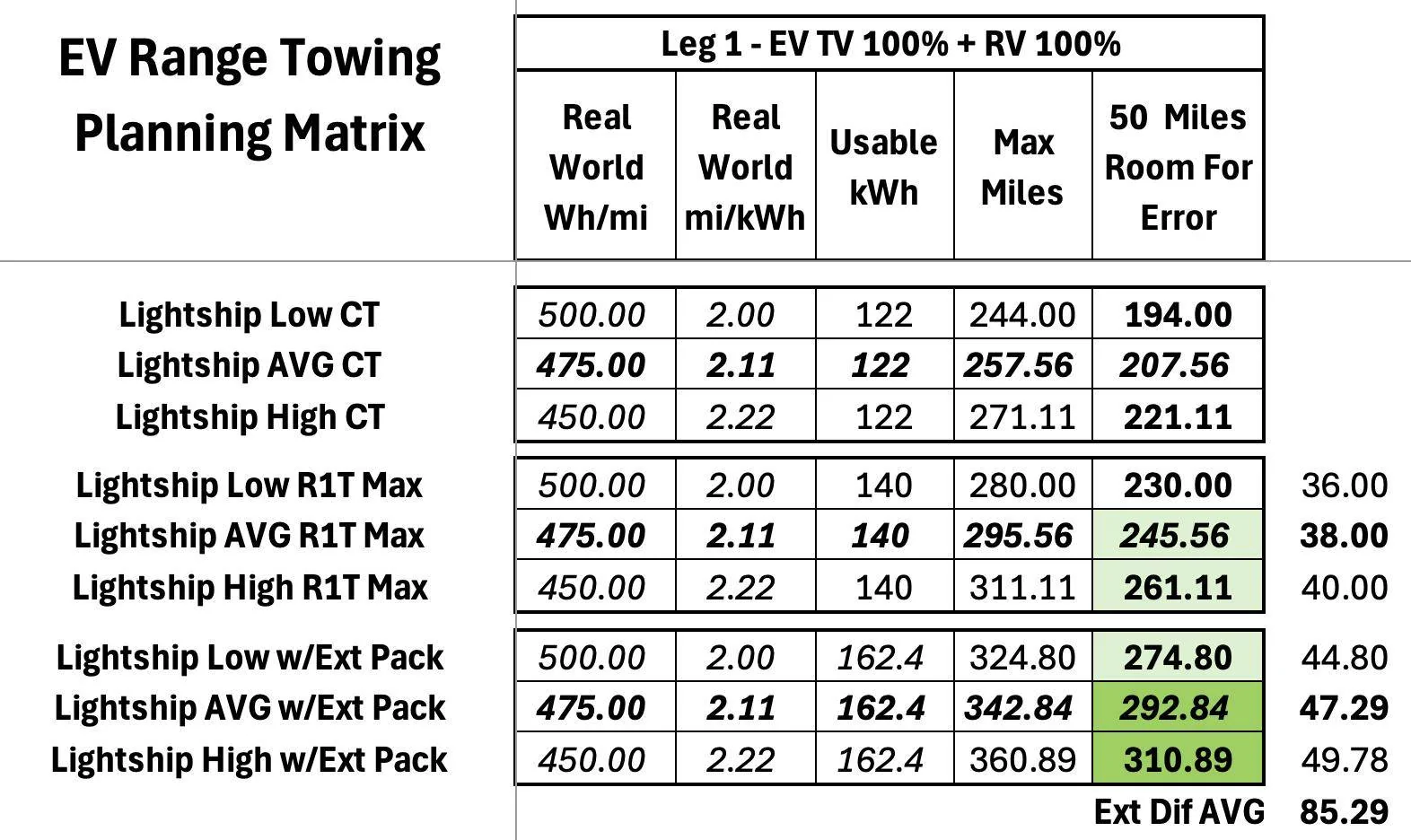

Seems there are only a couple of genuine towing options ...
Impressive! I did my pros and cons list and biggest issue for us was we have to have Pet Mode, and only Tesla and Rivian have this option currently. So, GM, Ford, and Ram are out for us. I had a Rivian R1-T Max (loved it) but when Telsa came out with Free Supercharging AND has the Extended Battery Pack, it added about 50 miles more of real world towing of the Lightship RV (these are my own educated guessing numbers) over the Rivian R1-T Max pack. HOWEVER, now with the cancelation of the Extended Battery Pack, I am about 50 miles LOWER than the R1-T Max Pack. When you tow the Lightship, the range loss is minimal as it is very aero and self propels. So, now I am only able to route plan 200 miles instead of 300+ miles (leaving 50 miles of room for error)! That is a HUGE difference and Elon/Tesla really screwed me over with this cancelation. I would have kept my Rivian Max pack and preferred 250 miles of route planning (leaving 50 miles of room for error) and that is more doable than 200! The cost to switch back to the Rivian R1-T Max is too much to switch now with the huge depreciation of the Cybertruck (the Free Supercharging can't be transferred to the new owner and has really trapped me!).

Thanks!
It is odd that the others don't have Pet Mode yet. Seems like a popular feature. Hard to imagine that they won't all get it.
I have seen on the Silverado EV that some pet owners are just making sure AC is on, leave the vehicle with the pet inside, and then do a remote start (keeping the truck locked).
