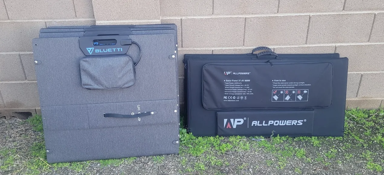

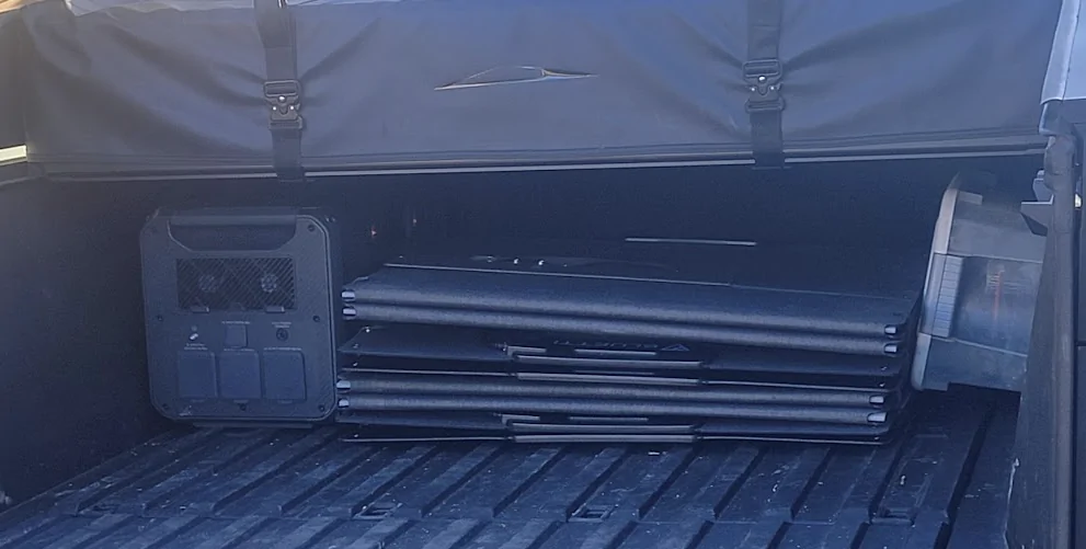

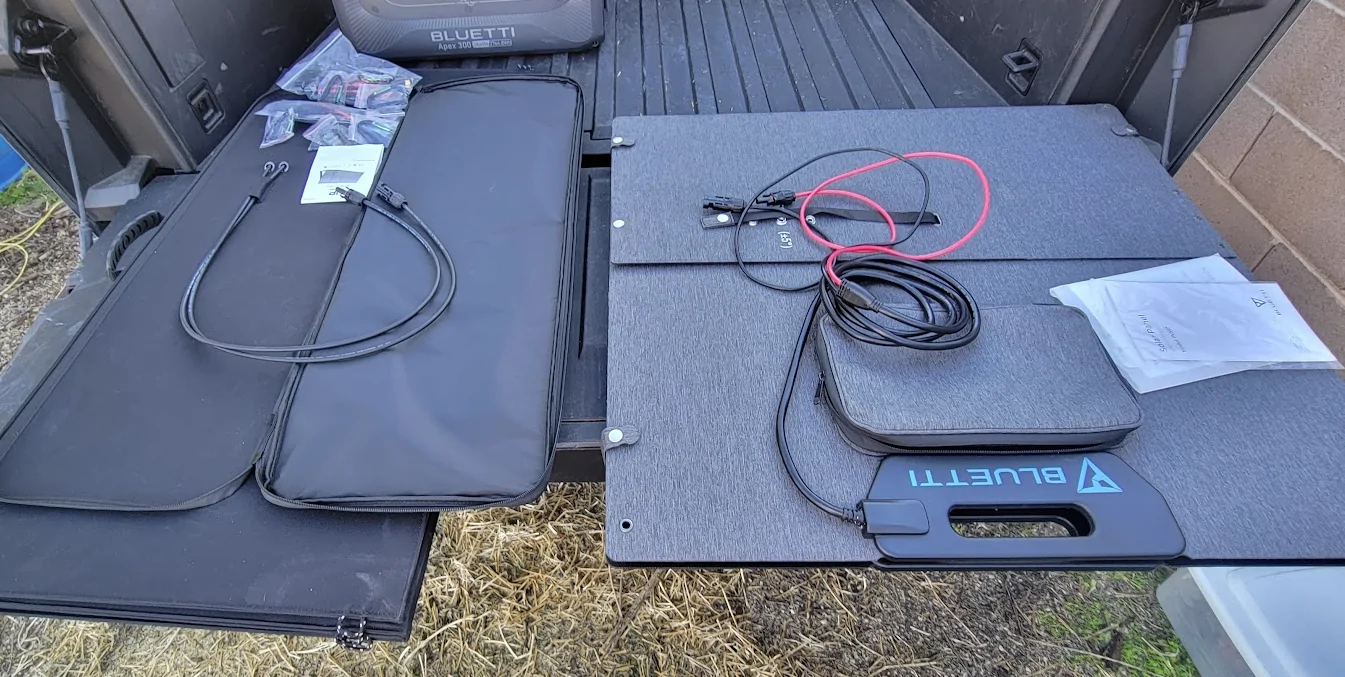

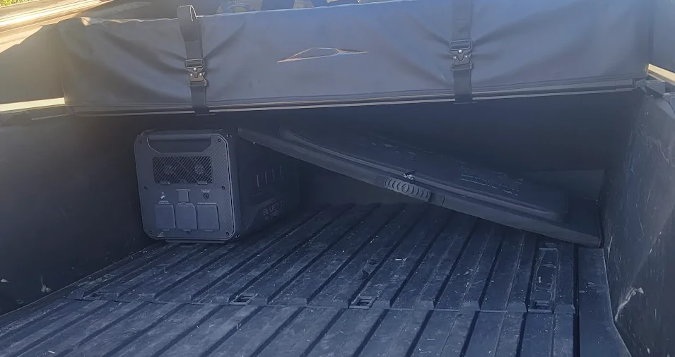

Thanks for the suggestion, @hemiarch!

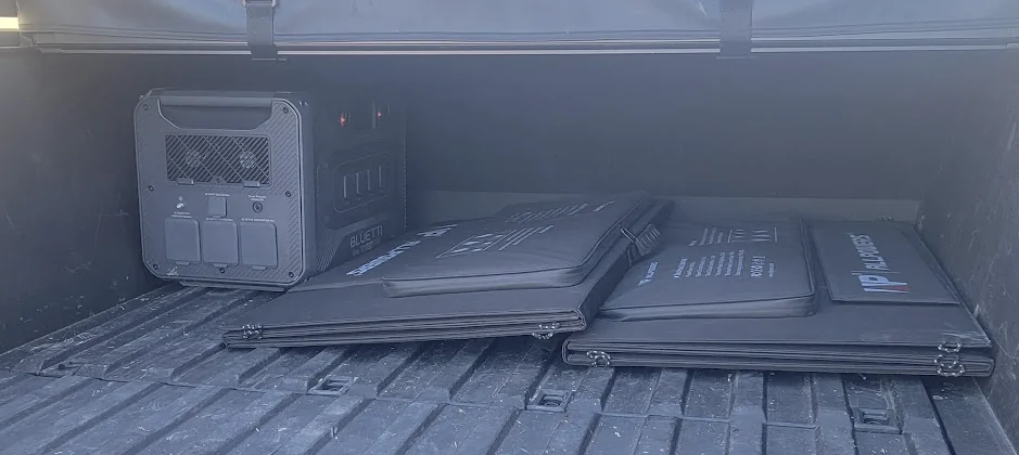

I decided to grab three of those 400W Allpowers since they are a LOT cheaper than the 350W Bluetti and did a comparison. Despite my confirmation bias really wanting to come up with a good reason to pay the extra for the Bluetti if I had it all to do over, I would have only bought the Allpowers and saved my money. That said, if money is no object and you don't mind paying double for a miniscule improvement, the Bluetti are slightly better in terms of durability and ease of use. If they were the same price or maybe only a $50 difference, I would favor the Bluetti.
Side by side:
Bluetti fit a little better. Here's four - could easily stack six.
Unfortunately, the Allpowers were just a little too wide to fit landscape:
Also too tall to fit two portrait:
The Bluetti did come with a longer cable which is really useful connecting them in parallel (but you can get an extension for $10 so hardly justifies the price):

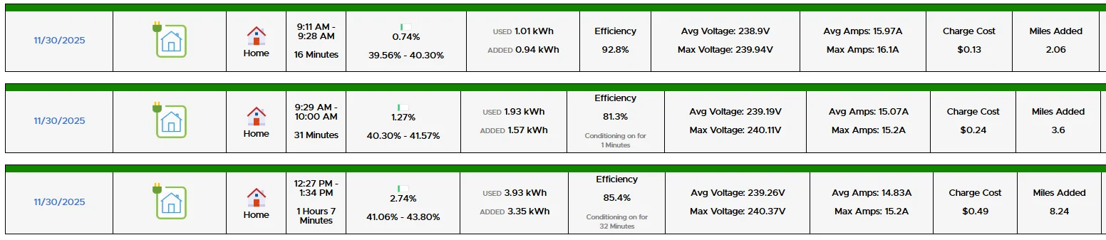

So I tested this out yesterday and it does look like a viable work-around. I set the charge rate to 15A and programmed it to charge for an hour every three hours. Was getting 85% efficiency.
The first charge at 9:30 got interrupted when I went in the truck to look at the settings. I had to run an errand so shut it down before the 3:30 charge but I think I would have gotten over 20 miles total added.

That awesome man. So how many mph are you getting at 15 amps?
Side by side:

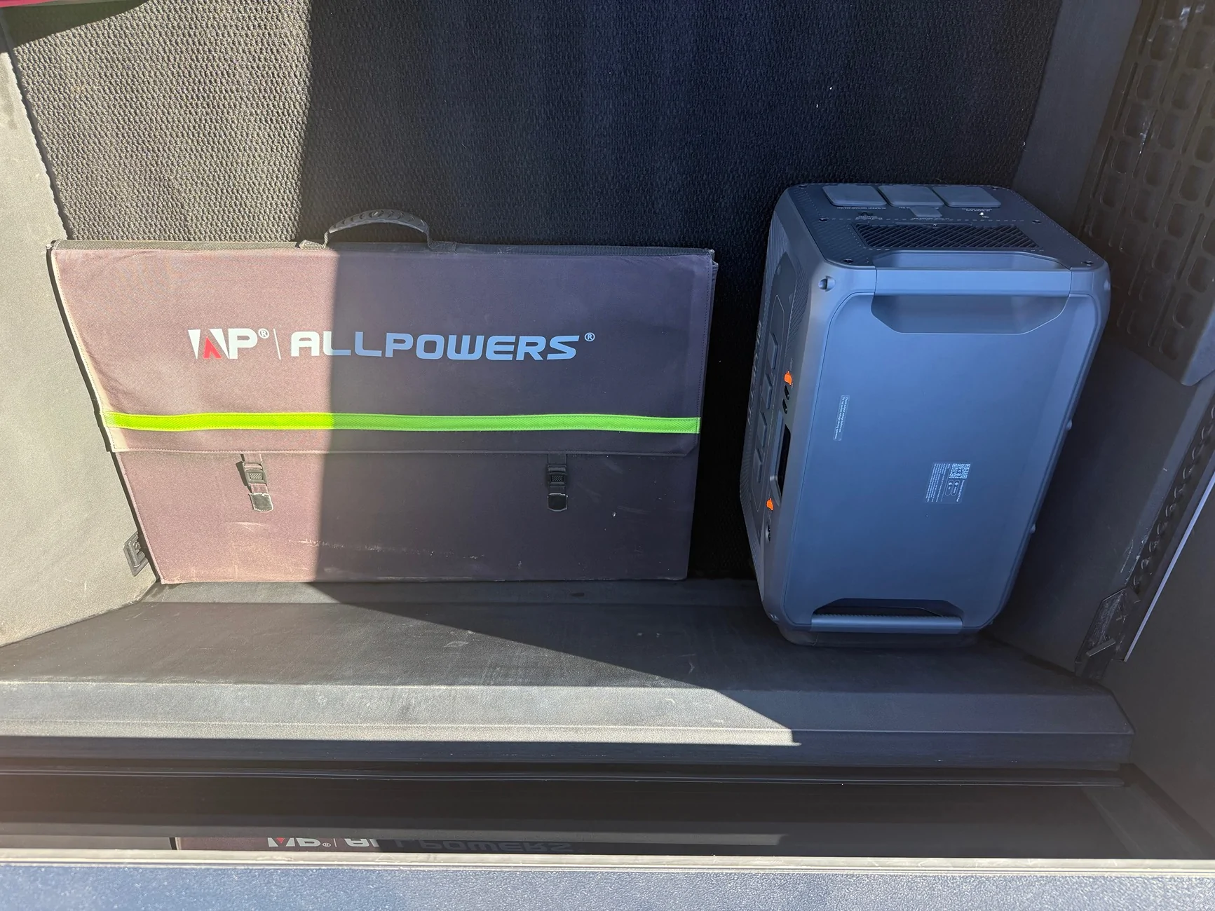

So I got you a photo. The proportions of the 600w panel are different and I like that it goes flat on the ground and can be staked.
I have 6 of them and they have a Voc of 52.8v.
Since the solar inputs accept up to 60v (1200w each), I’m running three in parallel on each input for some significant overpaneling without exceeding the 60V limit. 1800w for each 1200w input. That will produce a very consistent 2.4kw for most of the day (it’s what I do on my delta pro 3 also) .
Since the battery on the ac 300 is very small by EV charging standards, it’s important to keep a consistently high input.
I have the cybertent out of the truck here but it all fits very nicely under it.
Since the. Battery on the ac 300 is very small by EV charging standards, it’s important to keep a consistently high input.
