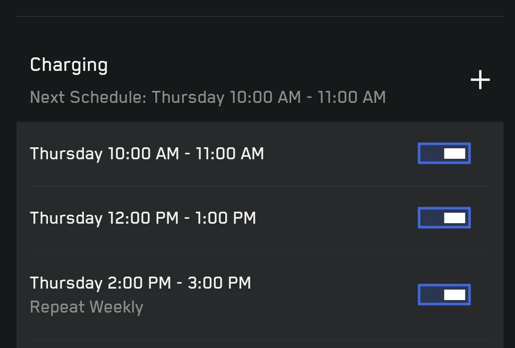

You can have multiple charging windows ...
Settlable SOC on the battery would be great, even better if time limited so it doesn't stay off because it's one percent under the threshold.
Sweet! Is that new? I was looking for something like this earlier this year (my TOU has two windows) and became convinced it was not possible.
