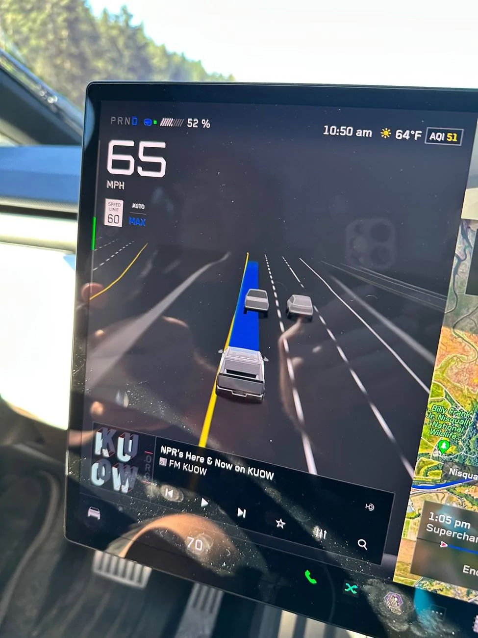

What I experienced repeatedly was riding near, on, and over the lane lines even when there were no vehicles nearby, even running constantly on drunk bumps and little turtles, and a couple of times actually straddling a line. I had to abort and report a couple of times. It’s not a case of the truck misinterpreting where the lines were, the display clearly reflected the behavior. And also, it wasn’t momentary, but ongoing, doing a good simulation of someone not paying attention to driving. I don’t have photos of the worst because I was managing panic. A couple of times it was so close to sideswiping that I bet the oncoming driver freaked out. I know I did but the mirror stayed attached.
I’m expecting it to be considered a bug and addressed in an update… unless I’m the only one experiencing it. Am I?

Not heard anyone else complain about it. I've not driven much on freeways - so can't say much. On city roads I don't have that problem.
Recalibrating cameras might still be a good idea ...

Yes it is only on freeways and highways. I did 1000 mile road trip immediately after the update.
The display reflects exactly what I’m seeing through my windshield and left side mirror, so I would think the driving software is also seeing it. But how would I recalibrate the cameras? I would love it if that would solve it.

You’re not alone. Mine does this too on freeways although its not so extreme as yours. Just biased towards the left side even with no cars around. This “bug”’seems unique to the cyber and is not the way FSD 12.5.4 on my Model X performs

Lane position isn't adjustable. If your vehicle is over the line and it shows it's in the line, a camera recalibration may help.
I just did that on my CT, I read it could need recalibration after an update. My truck was hugging the right side line, hitting every storm drain grate and almost some mailboxes and tree branches. I did a re-calibration and that helped a little but was still too closeto the right. I did another calibration and it works great now, keeps the truck centered in the lane. I think the most important step is to keep the truck as centered in the lane as possible, and even a little to the opposite side of which ever way it was favoring before. My truck was hugging the right so i made sure i was centered or to the left of center and it is very good now.

Yes, I also have 12.5.4 in my X (2024.27.25) and I don’t have any off-centering problem. On my Cybertruck the left-ness only seems to be a problem at highway/freeway speeds. I’m relieved to hear I’m not the only one. Thanks!
