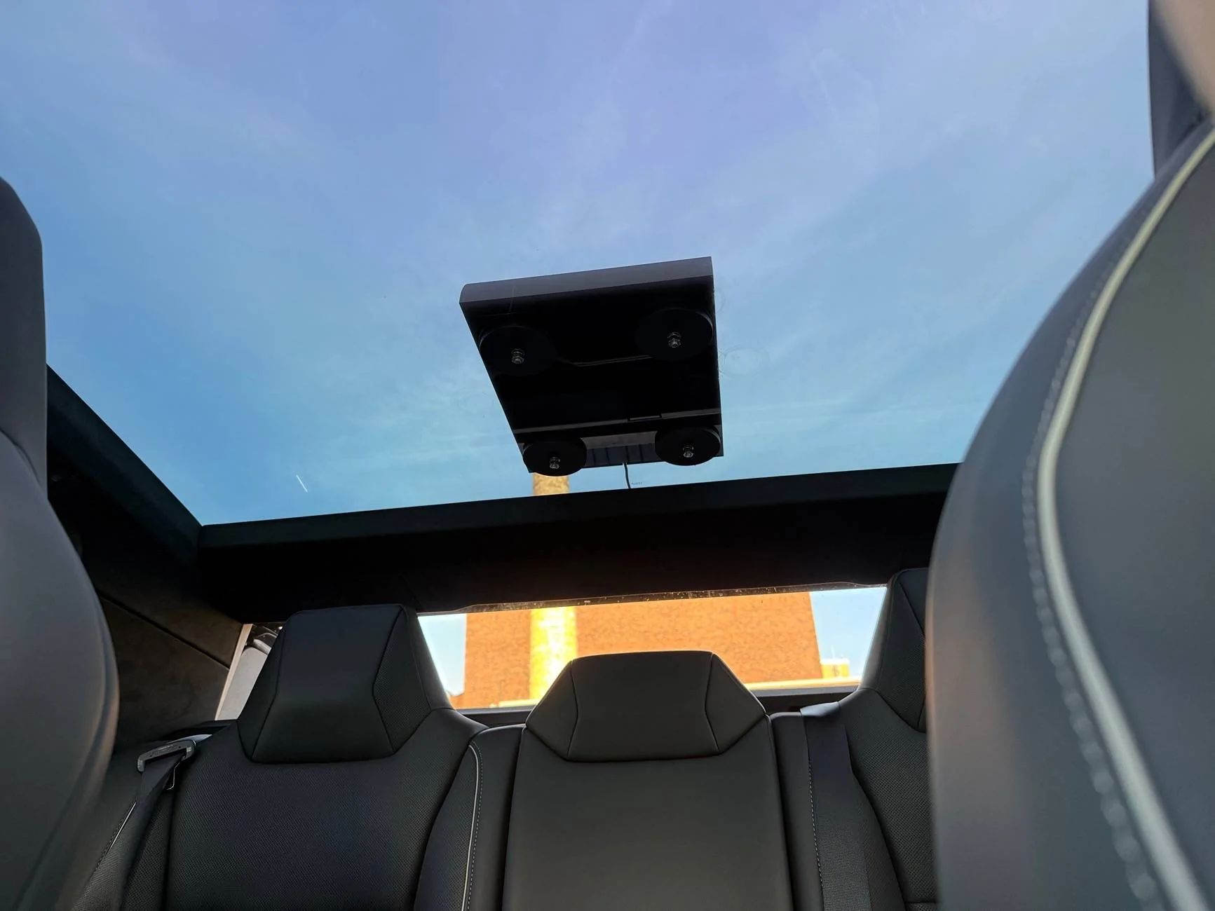

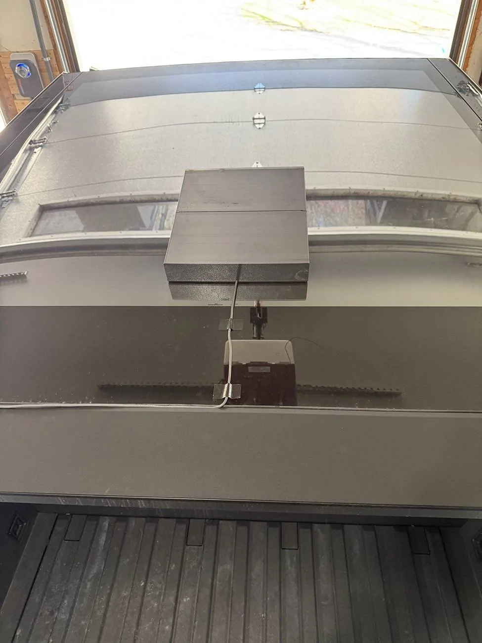

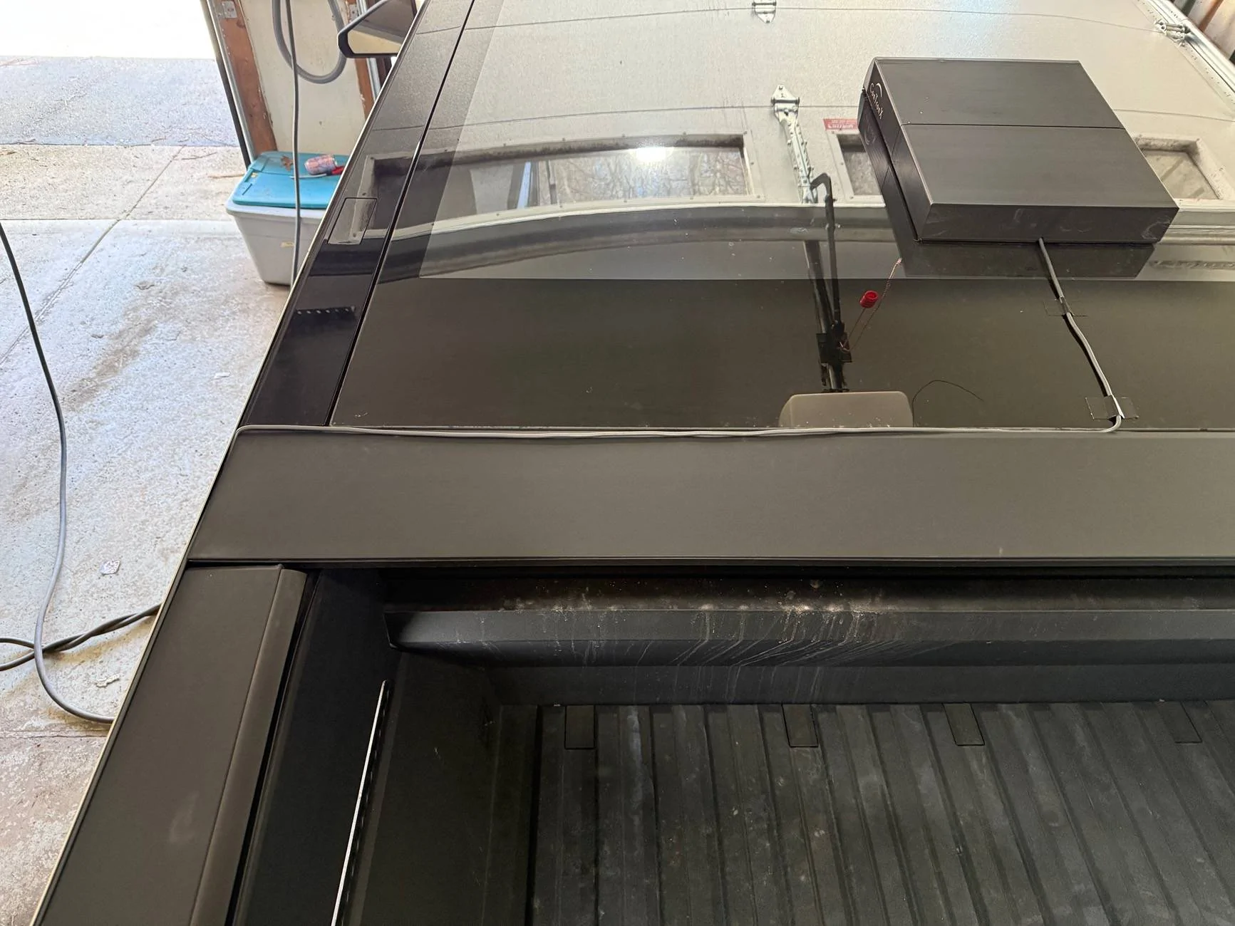

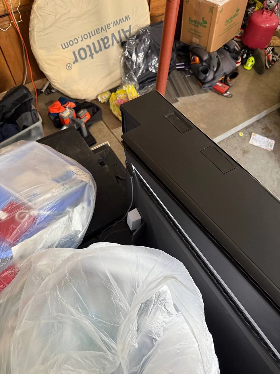

Sharing my exterior Starlink Mini setup that's been working great:
- Mounted using four 120lb magnets (two per side of glass) in a custom design
- Power cable runs discreetly between trim to truck outlet
Stress tests (accidental):
1. Went through full car wash - held strong
2. Took direct hits from Stihl BR809 blower (239 MPH claimed) - didn't move
No interior space used, perfect for backseat passengers. No drilling or adhesives - just pure magnetic hold.
Happy to share more details or photos if helpful.

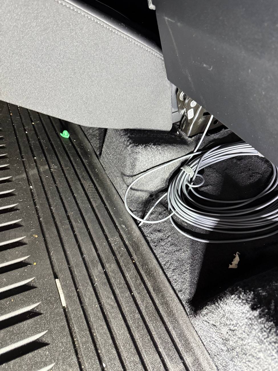

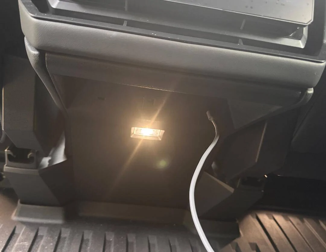

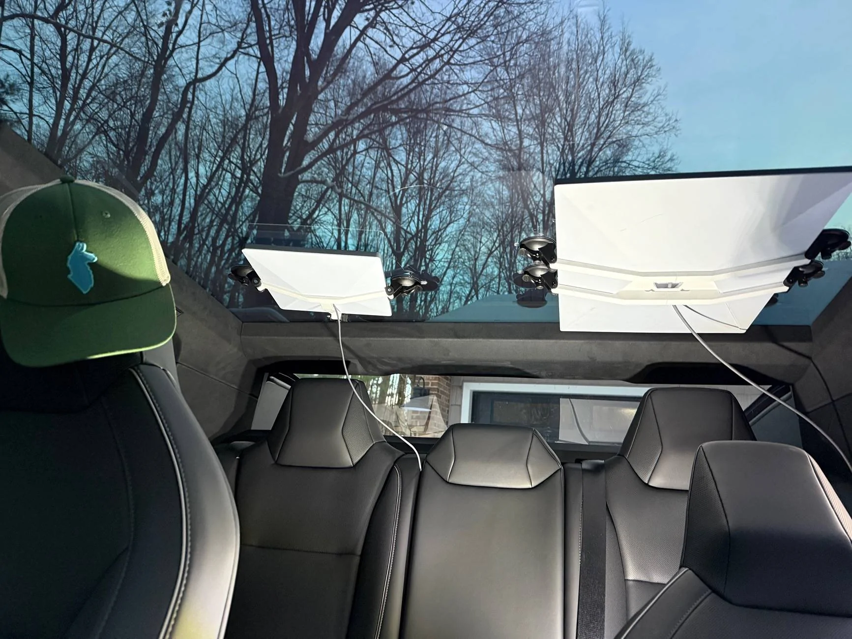

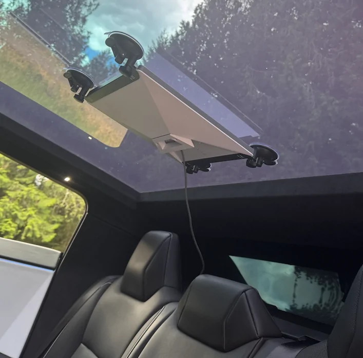

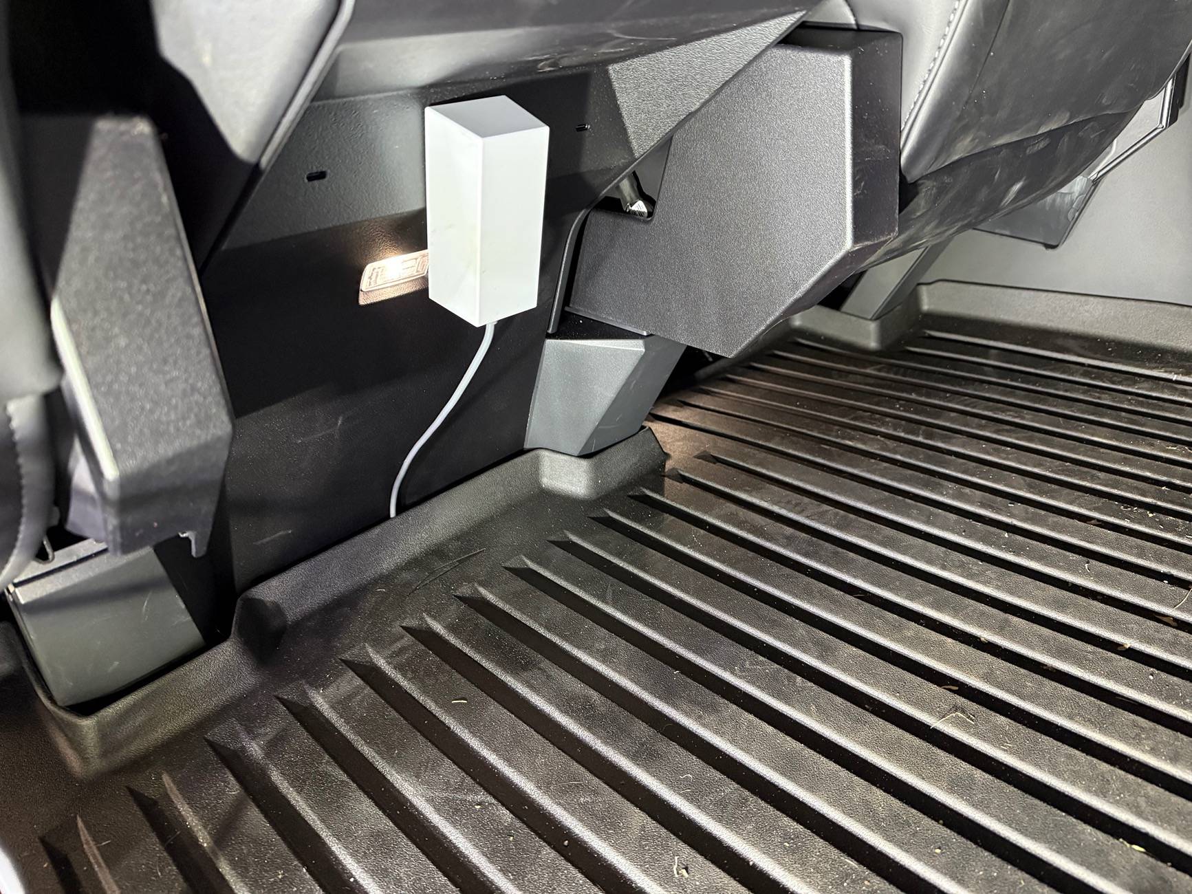

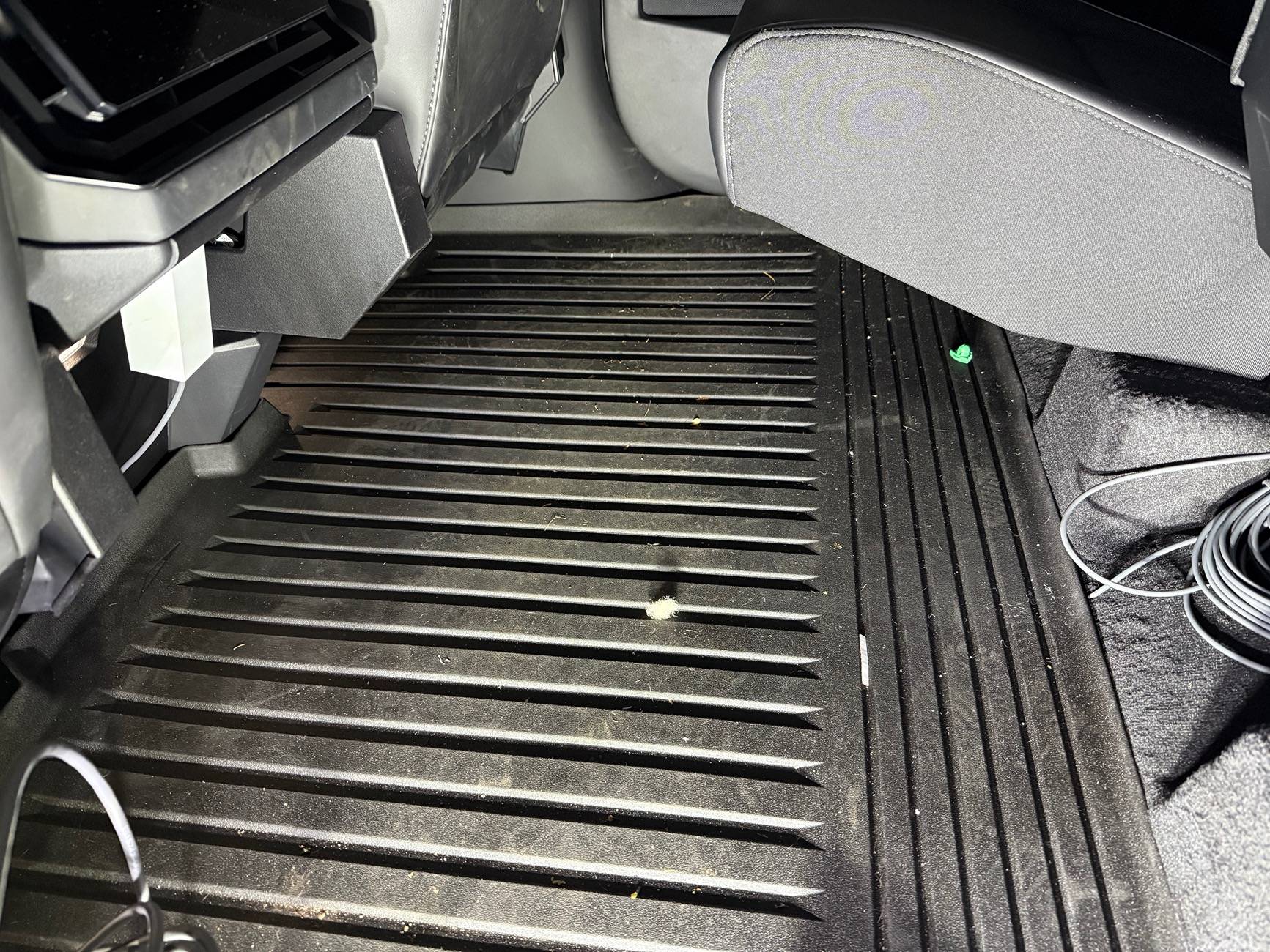

For those who prefer keeping things inside, here's my alternate setup:
- Mounts either Starlink Mini or standard dish on interior glass (custom-designed mounts)
- Power cables routed cleanly behind rear seats to 120V outlet
- Zero exterior modifications needed
Benefits:
- Protected from weather/wash damage
- Maintains Cybertruck's clean exterior look
- Easy access for adjustments
I've used both this and my exterior magnet mount - each has its advantages depending on your needs. The interior version is great for daily drivers who want maximum protection.
