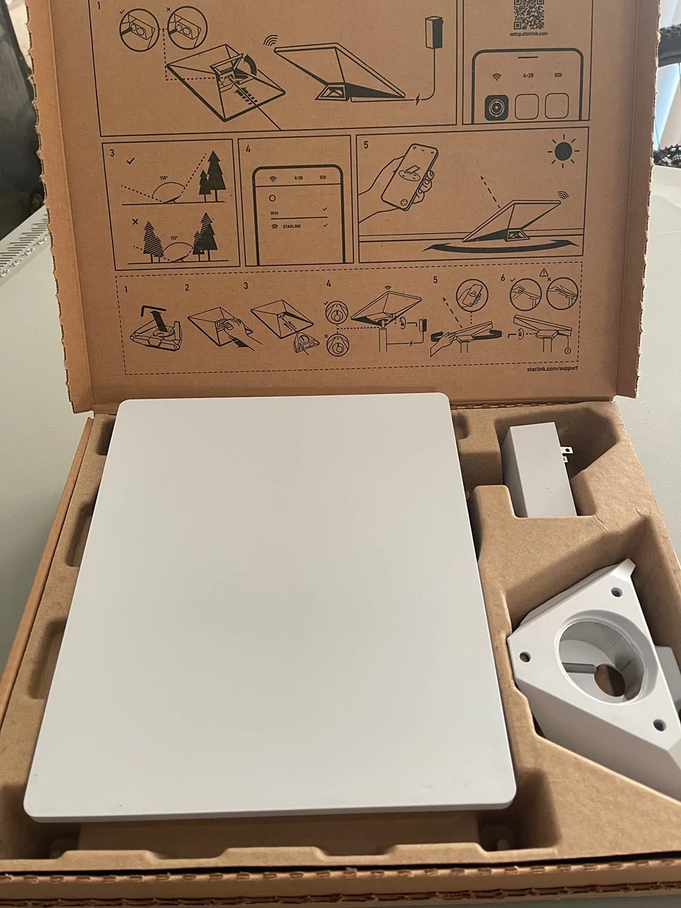

Just do what hemiarch says and buy one! Yes, he’s a bad influence but it’s so so worth it! Mine arrived the other day. 😂
