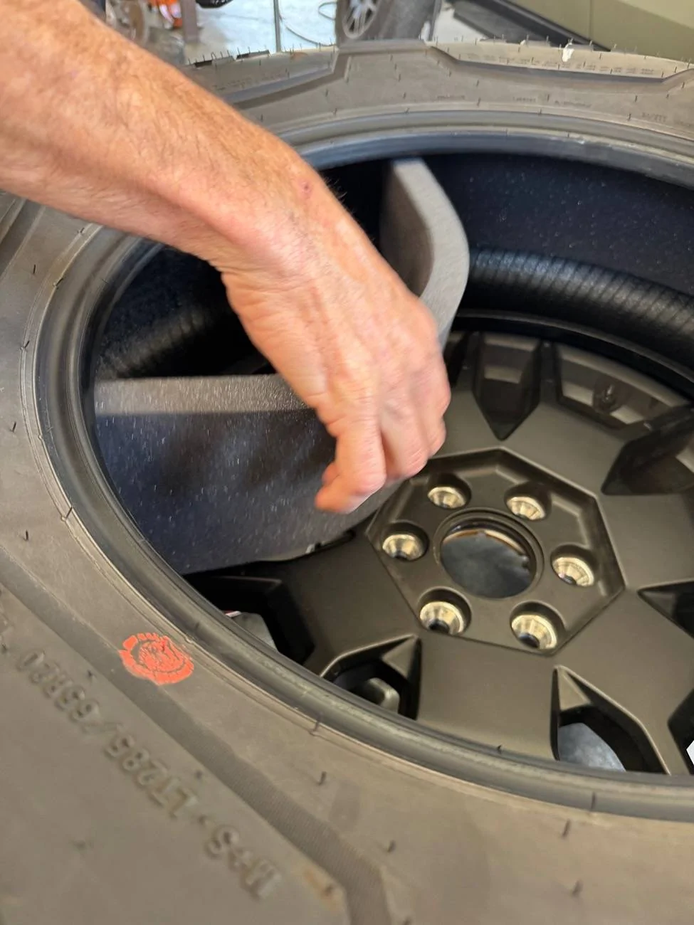

Tesla Cybertruck Sudden extreme vibration and shaking IMG_5172
Yes, I just learned that at least two of my tires had foam that was loose in there and causing instability. This was assessed at my local tire shop I’ve been using for years. The source of the issue is bad glue. There’s barely any glue on it. It’s a linear stream in the middle and they said that other high tires that have foam in the inside are glued 100% to the surface and it’s almost impossible to pull it out. These were pulled out with about 1/2 pound of pressure…for safety reasons and instability at highway speeds, I’m having to remove the foam. We’ll see if the sound is bad.
Good pic, always wanted to see the foam inside. I would expect Tesla to cover that under the warranty
