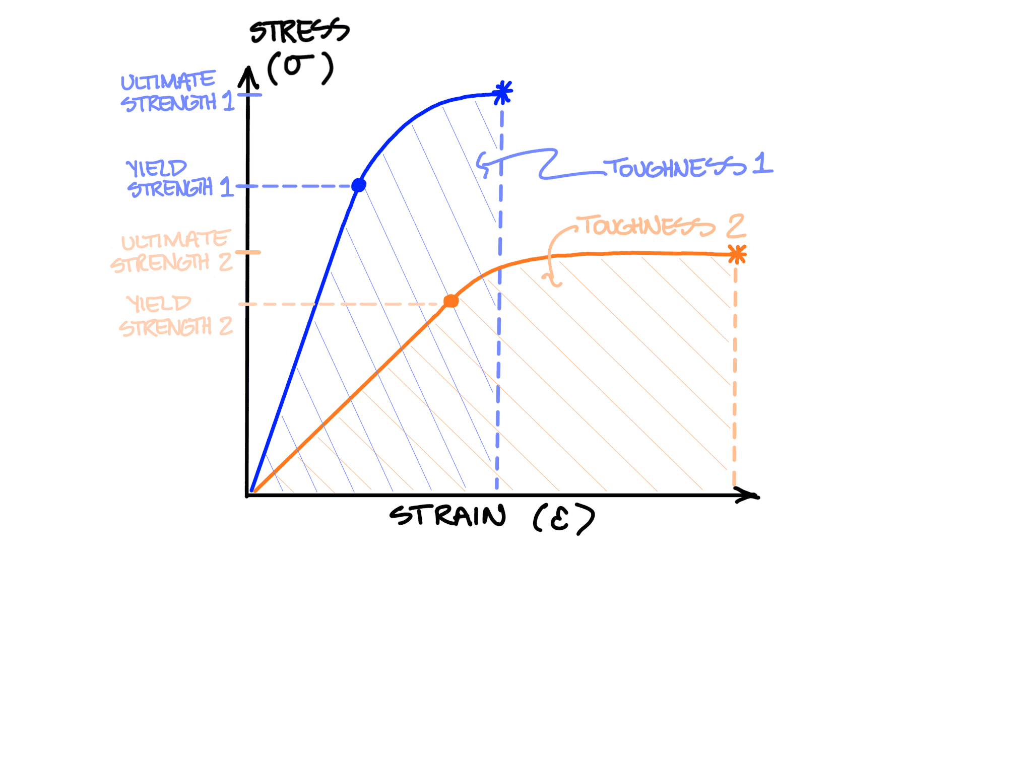

Ductility is the ability of a metal to deform without fracturing. Metals that can be formed or pressed into another shape without any fracturing.

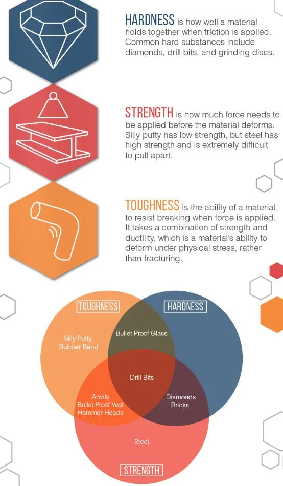

Strength vs. Hardness vs. Toughness
Modified 2021
https://engineering.stackexchange.com/questions/25943/strength-vs-hardness-vs-toughness
Tesla Cybertruck Tesla employee undergoing Hot Form Stainless Steel Training dx1dXl
Tesla Cybertruck Tesla employee undergoing Hot Form Stainless Steel Training i0bPu
Hardness Vs. Toughness Vs. Strength
https://www.wasatchsteel.com/hardness-vs-toughness-vs-strength/
Hardness
Hardness is a term that speaks specifically to a metal’s ability to withstand abrasion resistance – or more simply, friction. When rubbing up against or contacting other materials, how well does the material hold up? There are numerous processes within metal working that require high friction resistance, and therefore need high hardness ratings; think of drill bits, grinding discs and numerous other metal tools like screwdrivers or hammers, which constantly produce friction and need to be able to withstand it. A good example of hardness is the diamond, which is one of the hardest substances on the planet. Scratching a diamond is virtually impossible due to this hardness. But if you smashed that same diamond using a sledgehammer, it would shatter – this is because it’s not tough. Let’s look at toughness next.
Toughness
Toughness, on the other hand, speaks to how good a job a material does at resisting fracturing when force is applied to it. Strength, which we’ll go over in a moment, plays a role in toughness, as does ductility – the more a metal can deform before fracturing, the tougher it is. Silly putty is a great example of how some people think incorrectly about these terms: You wouldn’t think of this as a ā€œtoughā€ substance normally, but if it were a metal, it would be very tough because it can stretch to a huge degree before breaking.
Strength
Finally, there’s strength, which refers to the amount of force needed to deform a material. The more force needed, the higher the strength. Steel, for instance, is known to have very high strength due to how hard it is to pull apart.
Overlap
Now, it’s important to note that many metals have overlapping hardness, toughness and strength qualities. A metal can be both hard and strong, such as a drill bit. It can also be tough and strong, such as an anvil. Or in other cases, materials may need to be hard and tough, but not worry too much about strength – think about bulletproof glass, for instance. In addition, it’s possible to enhance these qualities in a given metal. A common format here is ceramic coatings, which increase hardness for metals that lack it but are already strong and tough.

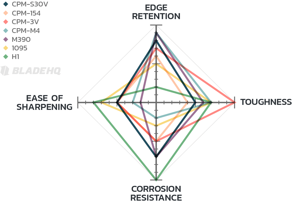

I believe there is actually a 4th factor in play as well which is corrosion resistance. Well known in the knife/cutlery world which is a heavy application usage of stainless steel. As an novice knife sharpener with an investment in it as a pro (lol), I see this debated all of the time.
As an example: Where Edge Retention = Hardness and Ease of Sharpening = Strength.
