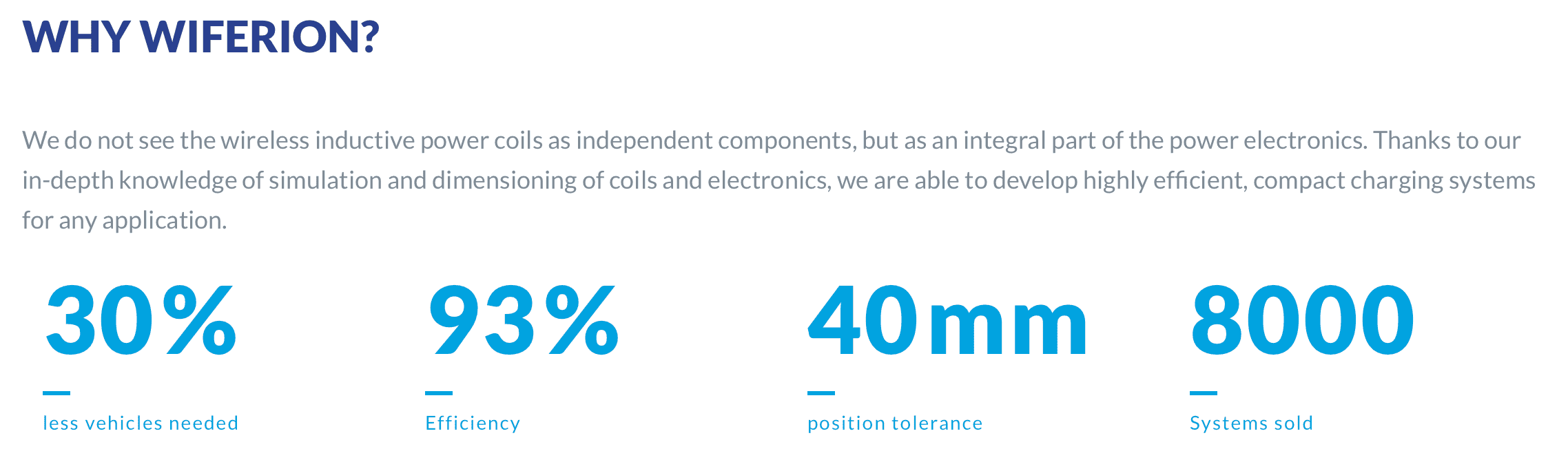

Inductive charging energy loss is on the order of 25% for wireless phone chargers, and those have a pretty small gap between the coils, like a few millimeters. I’d expect the losses to be much worse with an approximately 1 foot gap between the mat and the bottom of the truck. Efficiency falls off exponentially as the air gap distance grows, as I understand it
Yeah, I get the correlation between phones and cars, and why you might expect it. BUT, it appears you'd be wrong. This is from Wiferion (formerly a Tesla owned company)... 93% efficiency.
Tesla Cybertruck Tesla Inductive Charging Pad (wireless) is in development! Screenshot 2023-12-19 at 10.56.26 AM

Inductive vs. Resonant Charging Efficiency
Inductive charging systems typically have an efficiency rate ranging from 85% to 90%, while resonant charging systems can achieve efficiency rates up to 95% or even higher⁷.
The increased efficiency of resonant charging systems can be attributed to their ability to transfer power over a greater distance and with more precise alignment between the transmitter and receiver coils. This allows for higher power transfer rates, which ultimately translates to faster charging times for EVs.
