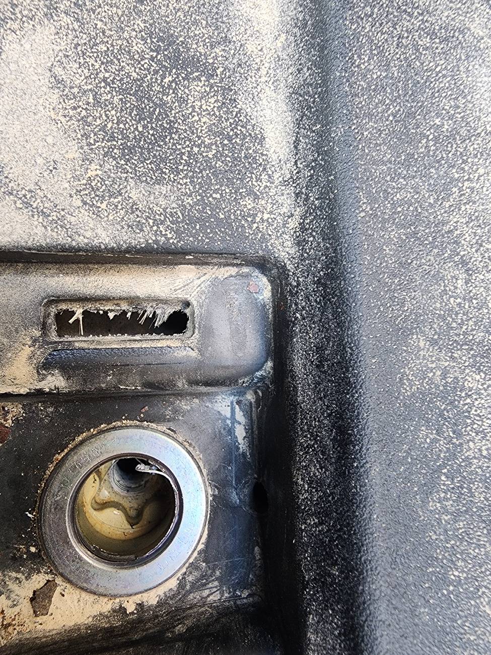

One was already easy to move.
Two were easy after I loosened the bolt, cycled the ring a few times to free up the mechanism, then retighened the bolt fully with the ring at ~45 degrees to maximize interference .
Same process with the fourth, but it is a bit stiffer due to interference with the bed. Still hand movable with the bolt tight though. Could add a thin washer to have the best of both worlds.
