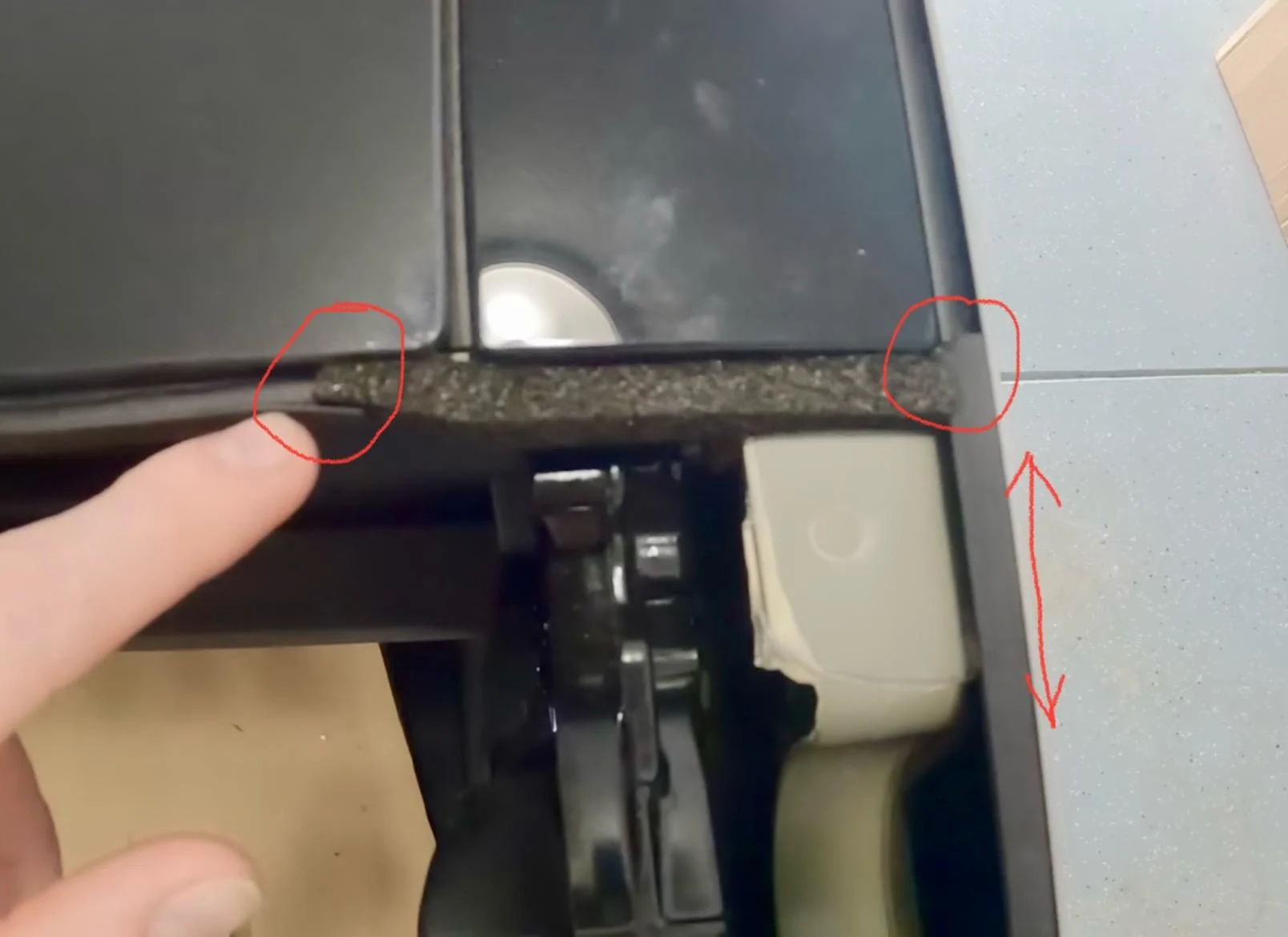

I just did this in mine. Before I took off the stock foam it actually looked really good. It was compressed into the crack and was still really sticky but even then it still leaked in the center like nothing was there. Afterwards i have one spot in a corner that leaks. That corner was particularly difficult to get clean because the stock foam just ripped into little pieces instead of coming off as a strip. I cleaned with goo gone then isopropyl but I guess the interface between the new seal and the 2 inches of stock foam I left wasn't enough.

Make sure all ends where the new seal meets the old seal are caulked well and on the backside of the 3 inch old piece of foam. I circled both critical spots. Also, don’t forget to add the additional seal on the edge to close the factory gap. Noted by the red arrow on the picture below. I hope this helps! My new seal is holding up very well. I haven’t had a single drop of water in the bed since I replaced it a few weeks ago.

Initially I didn't put any caulking in but I went back and did the corner that was leaking. That seems to have done the trick. I couldn't get the foam where it meets the new seal to sit in the groove because it just ripped apart when trying to remove it. All's good now though, it's been through a heavy rainstorm with no leaks.
