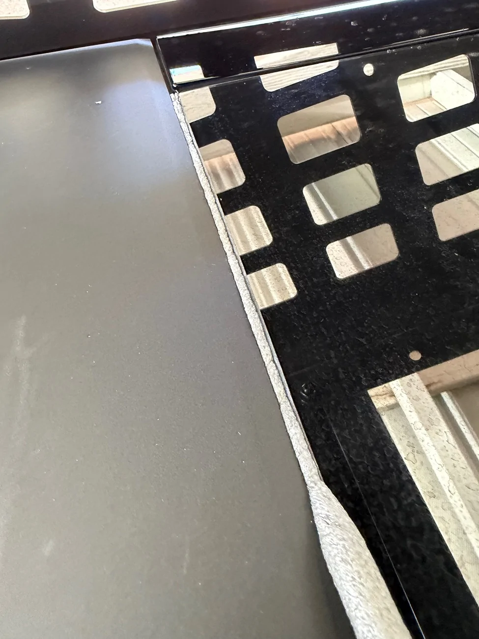

Update: Service center wanted to charge me $275 for the diagnostic testing for water ingress after they stated my vehicle was normal with the leak between the rear glass and aero flap. Ultimately they didn’t fix it and I wasn’t charged the fee.
I went ahead and used EWELON’s advice and stuffed 3/8 backing rod in the gap. I did run into a slight issue towards the far right passenger side of the rear glass and aero flap. The last 3-4 inches were too narrow for the backing rod to fit so I left it empty in that right side area. Did the water test and surprisingly water didn’t get in.
Thanks for the tip. So I think it’s really up to the service center and technician to whether they’re willing to change the sealing or not for the leak. I have a 2024 FS and definitely didn't have any seal within the aero flap.
great news
Front at leading edge of aeroflap
Middle 1/8 backer
Each end 1/4 backer
