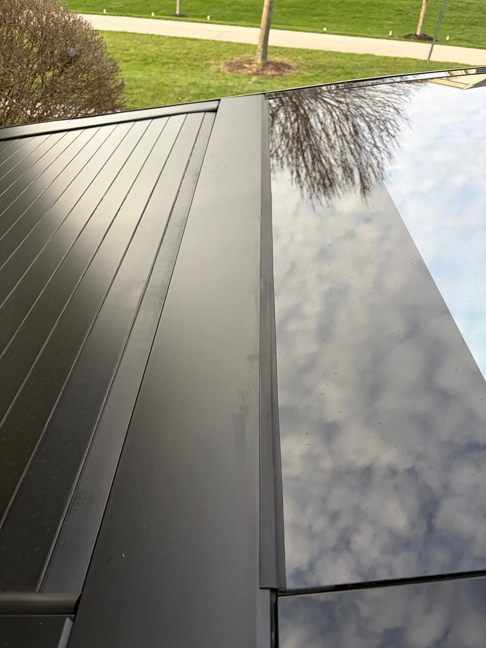

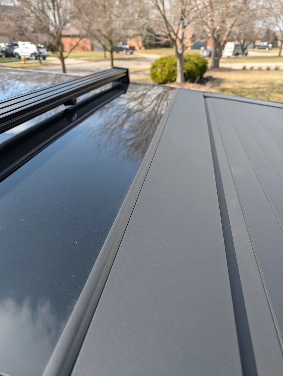

Installation is as easy as it looks? If so, that's a way better solution.
Yeah, nothing to remove or glue just cut peel and stick. It is really low profile and looks factory done. Take your time to get it straight and don't stretch it.

I just had the tonneau rework done, my cover barely leaks on the back trim now. I am planning on doing the weatherstripping to further seal.

The pictures on Amazon make it look larger. I'd say it's about 1/2" wide. They give you a lot.
how far to the sides did you go on it?
