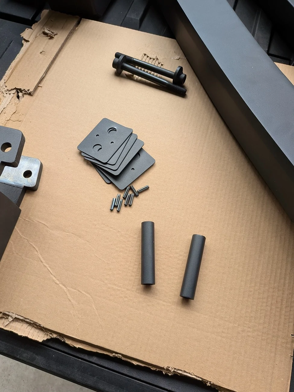

It's a bull bar. I'm excited that it is here, but I'm not sure when I'll get it installed. There doesn't seem to be an installation guide available. I think I've identified the purpose of all of the parts, but I can't be sure. There are some spacers(?) and press fit sleeves(?) that might need some explanation.

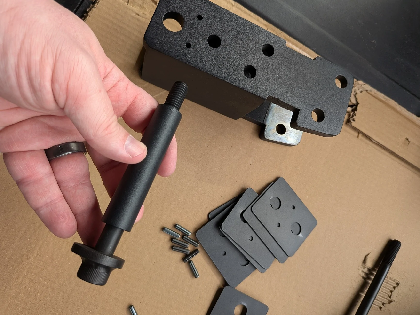

Here are the parts in question:
Tesla Cybertruck Unplugged Performance: Discreet Packaging Option? PXL_20260410_215535490

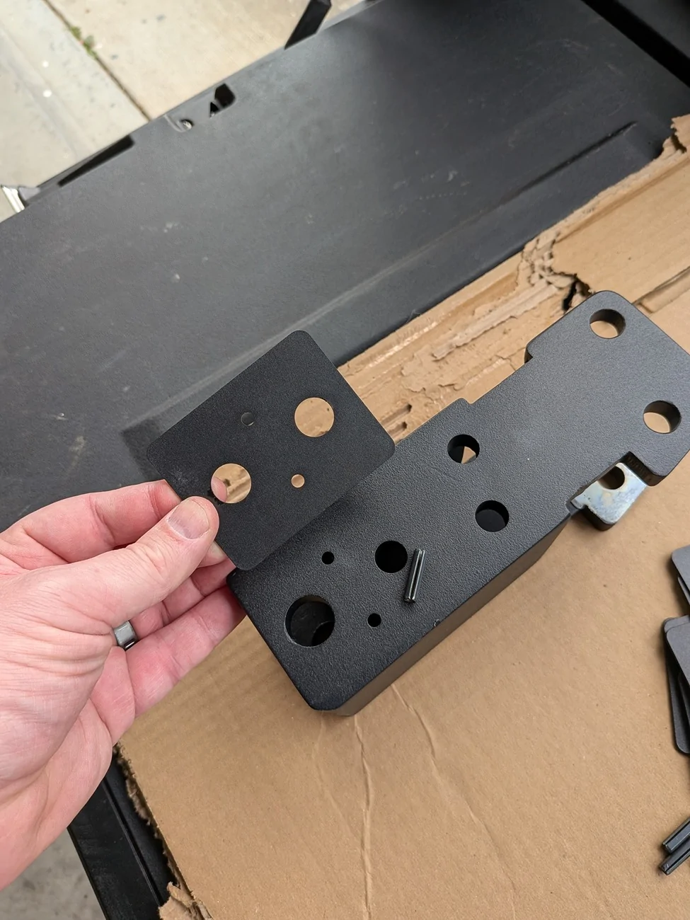

Given the gap between the bull bar and the bumper mounts the shims must go here, and the hole pattern is perfect to fit the roll pins that should keep them in place while mounting:
Tesla Cybertruck Unplugged Performance: Discreet Packaging Option? PXL_20260410_215617020
Tesla Cybertruck Unplugged Performance: Discreet Packaging Option? PXL_20260410_215648191

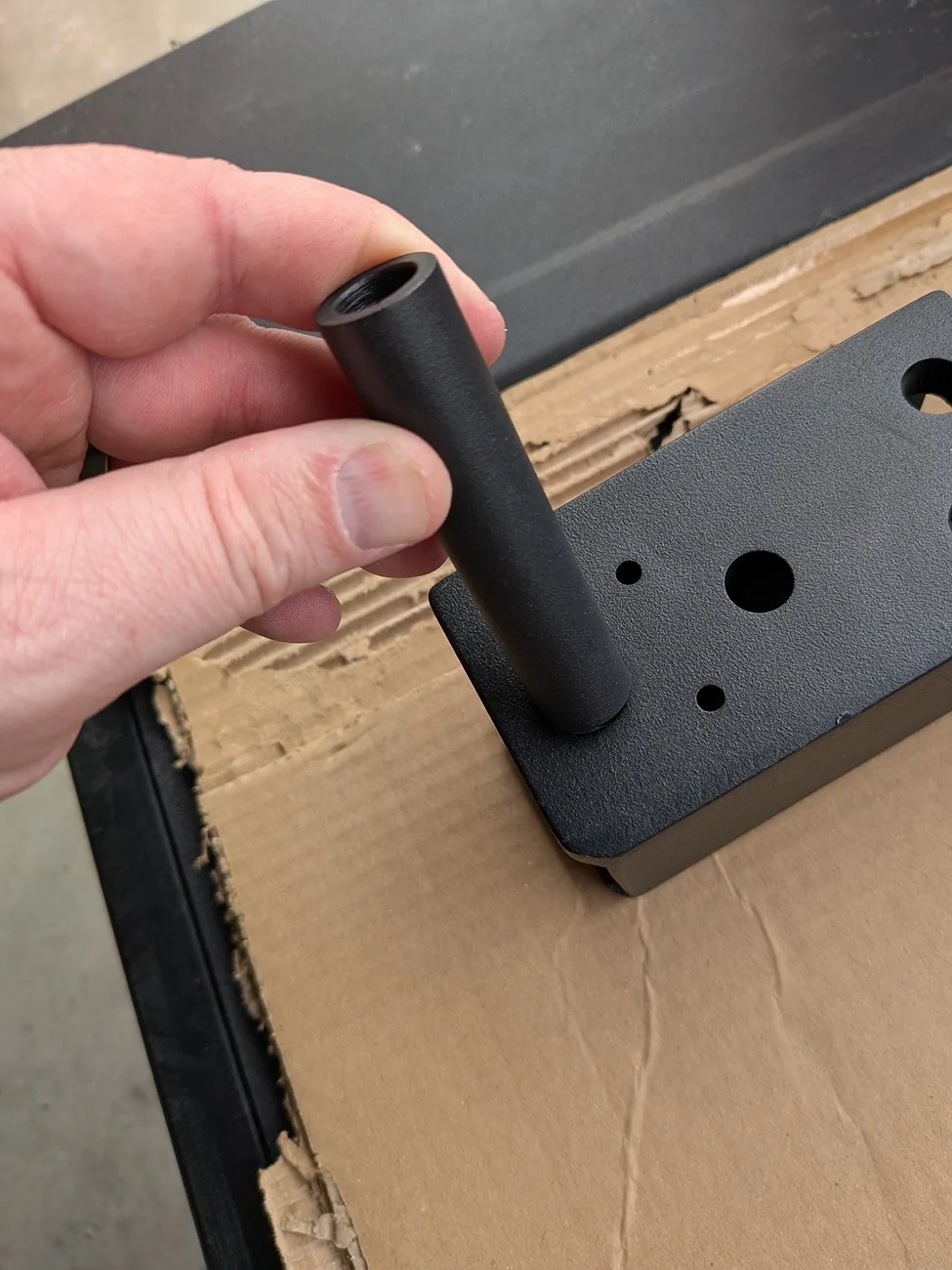

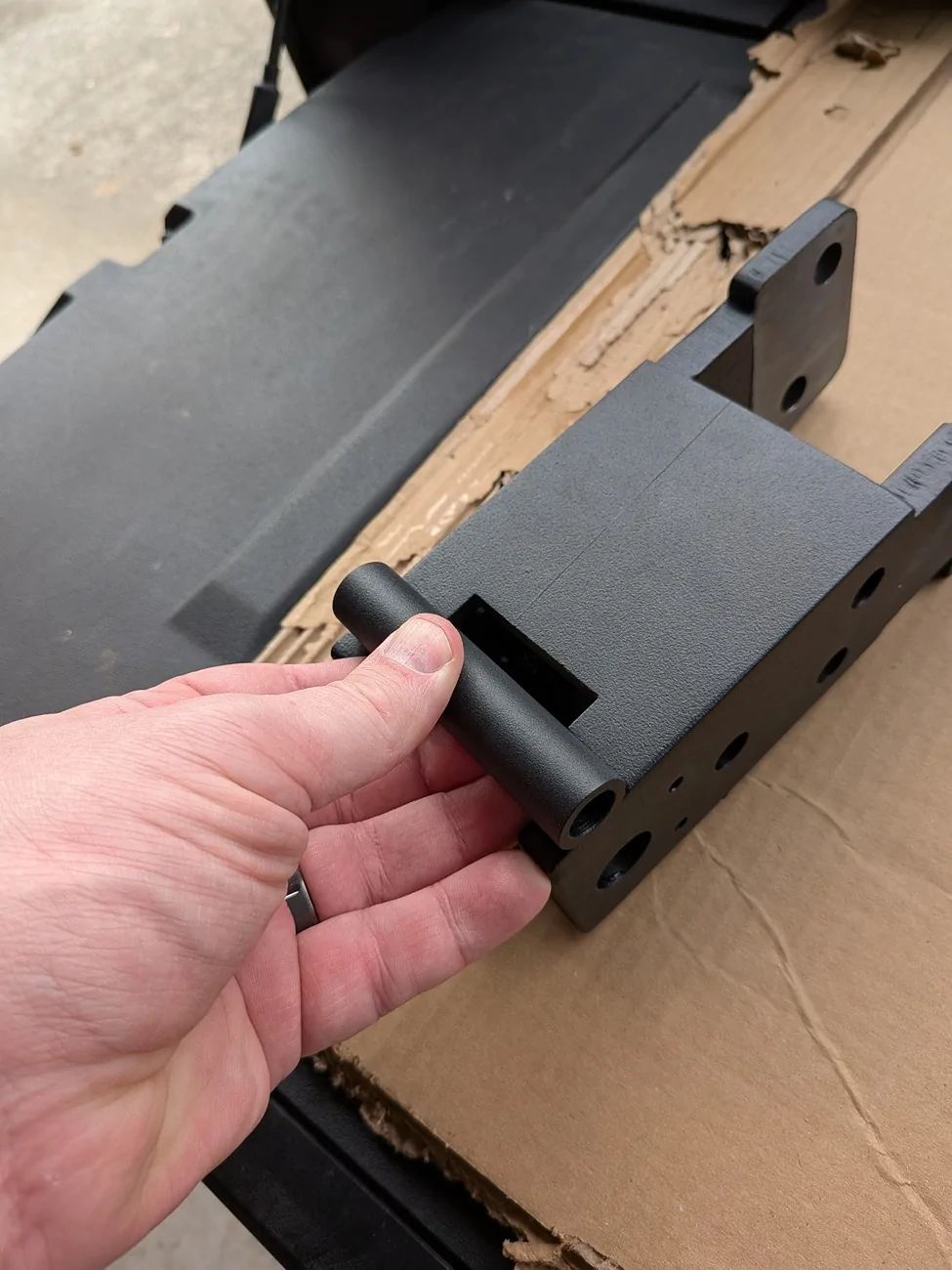

The large metal sleeve seems like press-fit candidate for the larger hole on the forward end of the bumper mount. The powder coating prevents it from sliding in, but a hammer should fix that. It's the right length for the job and fits the mounting bolt.

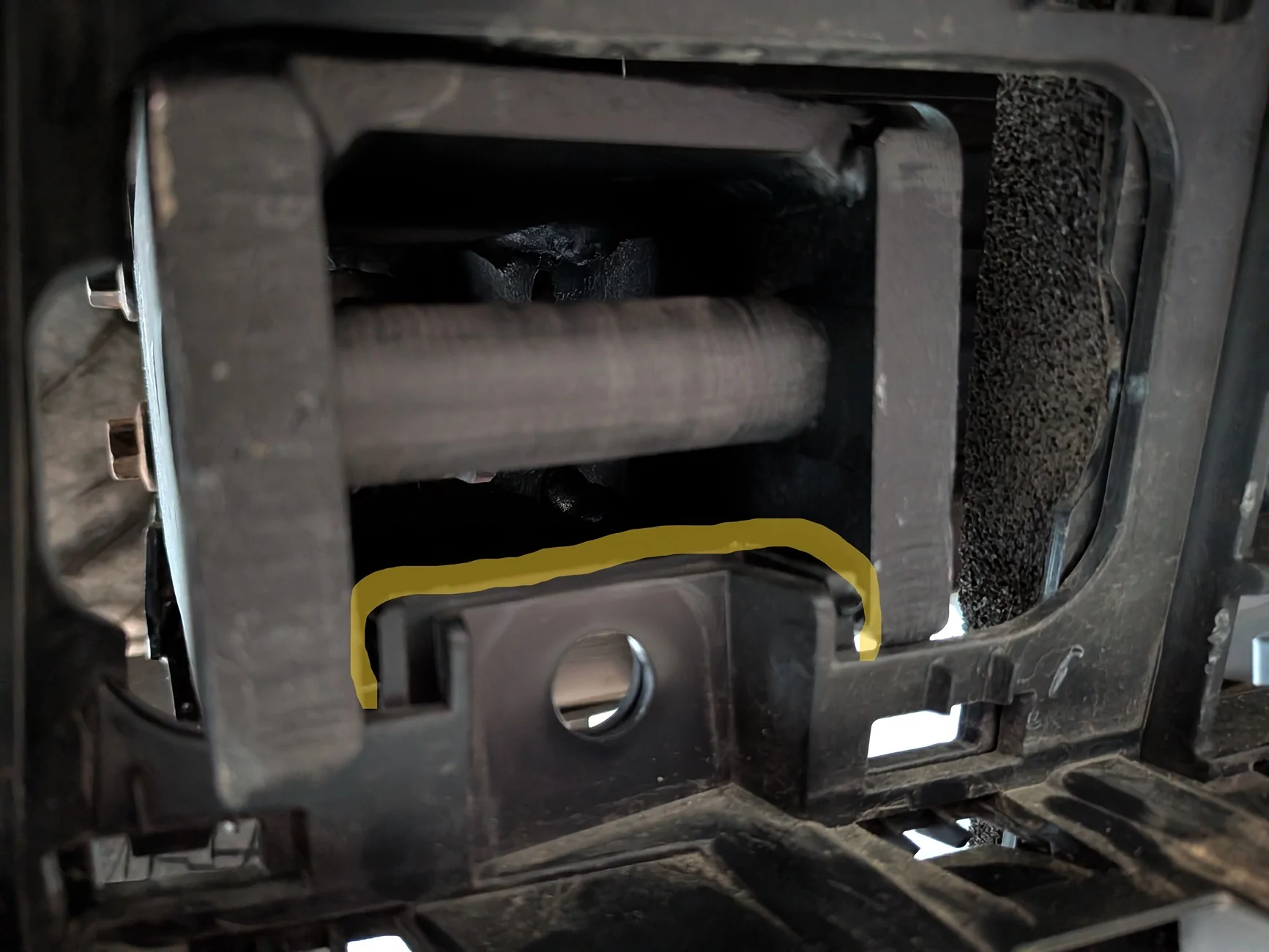

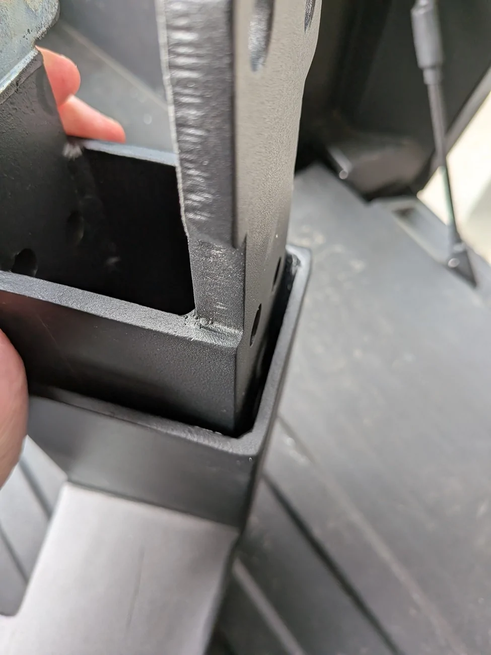

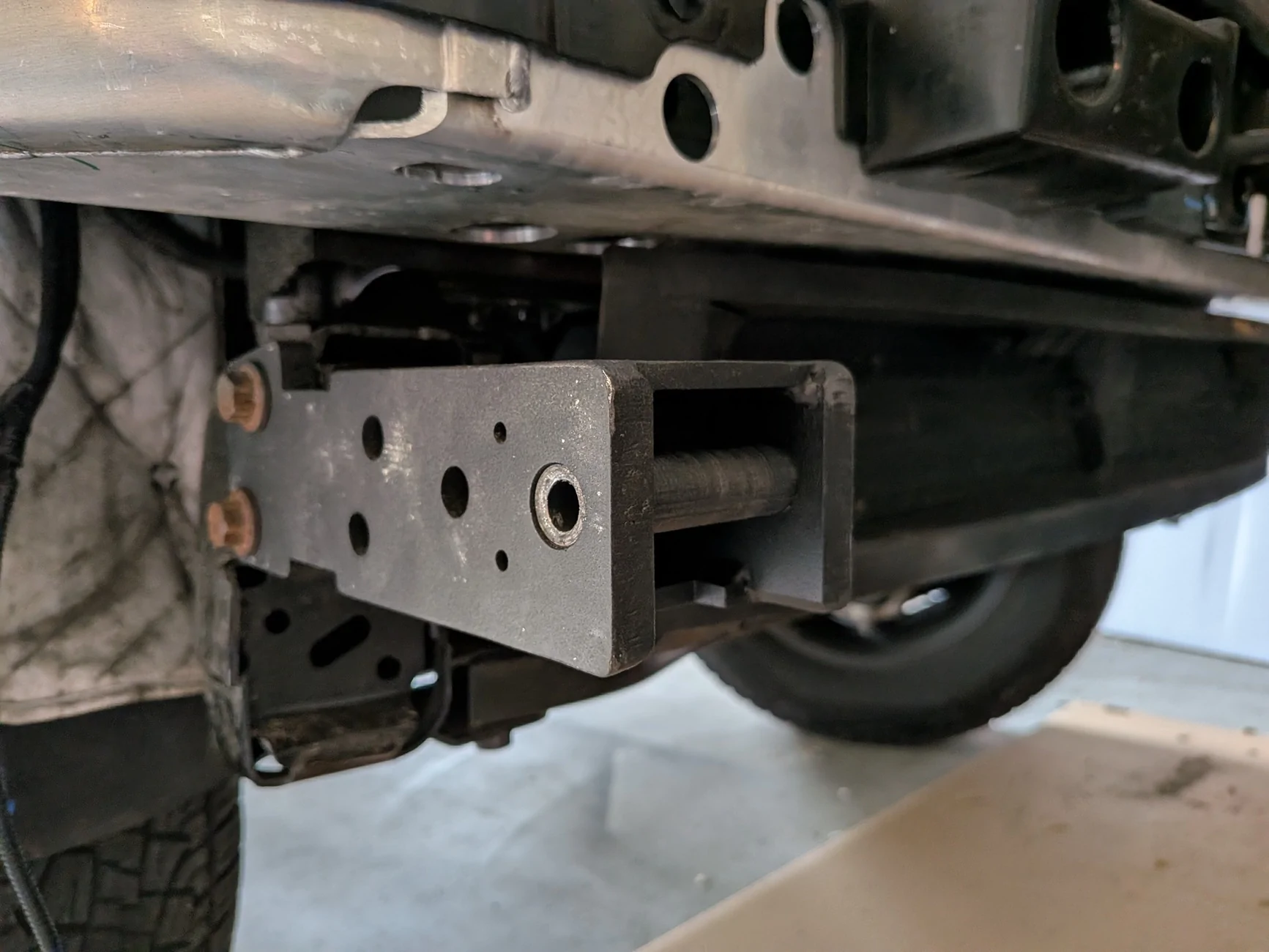

Things are progressing nicely up to this point.
Tesla Cybertruck Unplugged Performance: Discreet Packaging Option? PXL_20260411_194219182.NIGHT
Tesla Cybertruck Unplugged Performance: Discreet Packaging Option? PXL_20260411_194313105

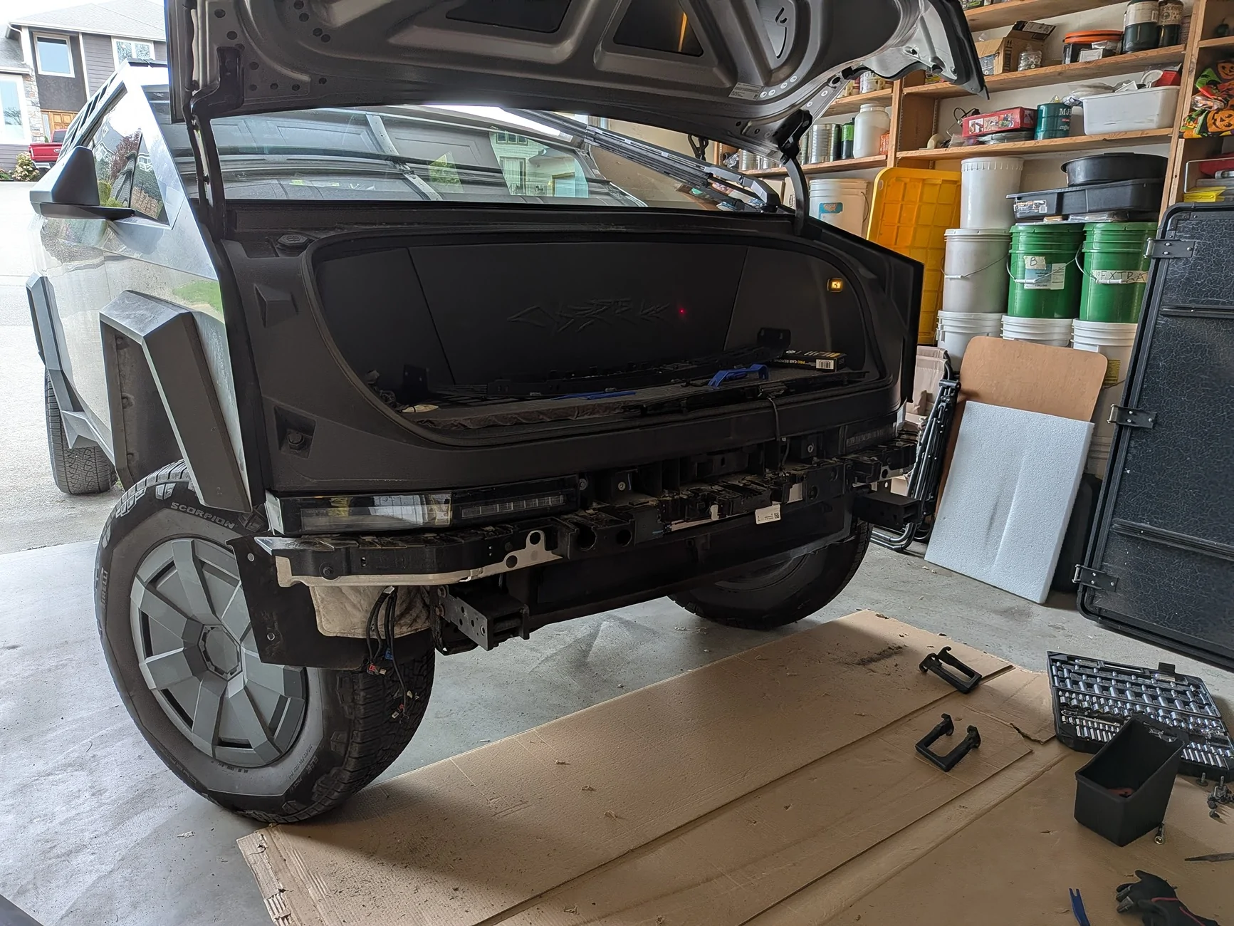

However, I'm reinstalling the bumper and the UP bumper mount prevents the OEM bumper from sliding back into place.
Tesla Cybertruck Unplugged Performance: Discreet Packaging Option? PXL_20260411_200745987
I'm wondering if I received the wrong part, but frankly I don't really care. I'm not afraid to cut some plastic.
