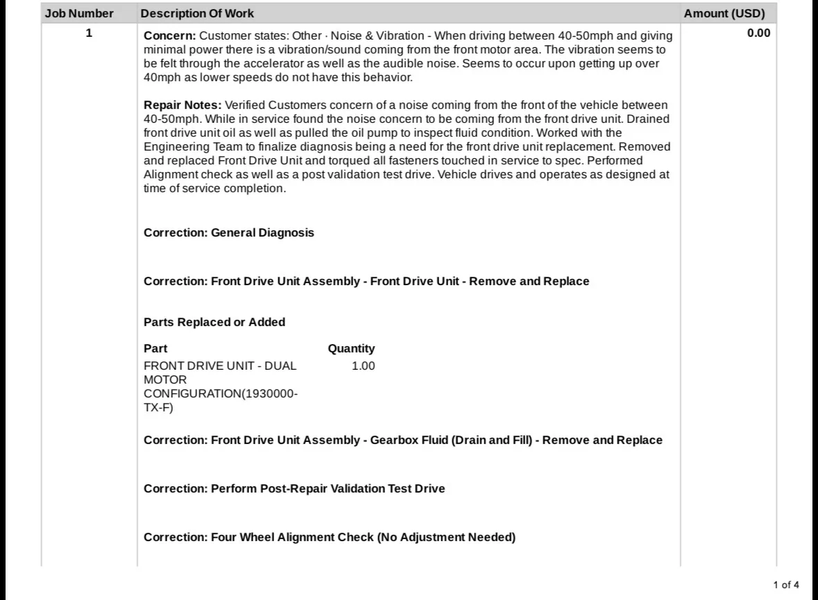

If you dont Mind, think you can share the service visit for when they finally did fix it for you? Thinking that may help me get this resolved.
Here is a screenshot. Repair Done in Oct 2024 at Salem, OR. Took about two weeks for repair, diagnosis and shipping of new FDU
Thank you for sharing this! I forwarded it to them. See what they say.
