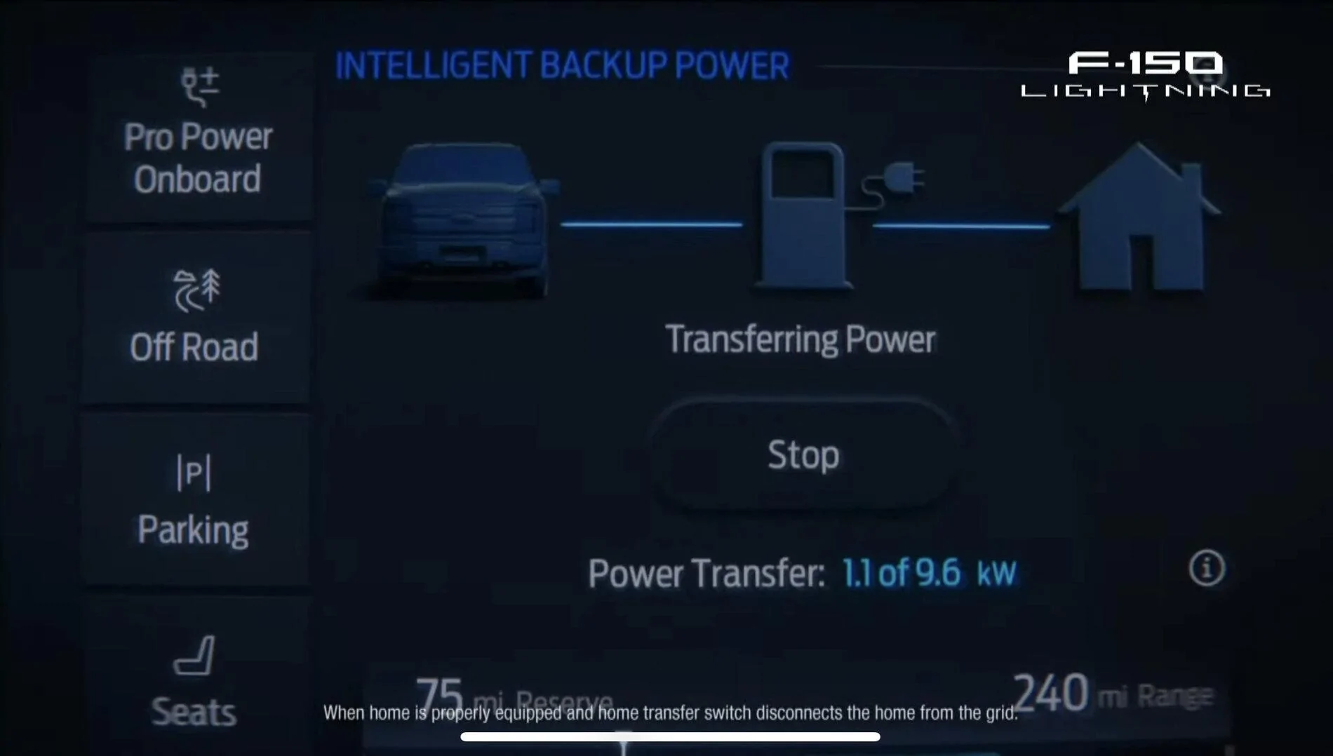

I disagree that, in practice, buyers of the Ford Lighting will not find it works how Ford claims for two reasons that have already been revealed:
1) The truck is unlikely to be charged 100% when a power outage happens.
2) Buyers of $90K trucks have homes that consume more electricity than the truck will be able to supply for three days without having a disconnect for higher consumption circuits and making sure non-essential loads are not creating excessive vampire drain.
The bottom line is that an EV is not a good backup power source for an entire house of the type typically owned by the buyers of such an expensive truck. Yes, it could be useful, no, it's not going to replace grid power for three days in a winter storm. People are unhappy when their expectations are not met.
I'm tired of pussyfooting around this. Again:

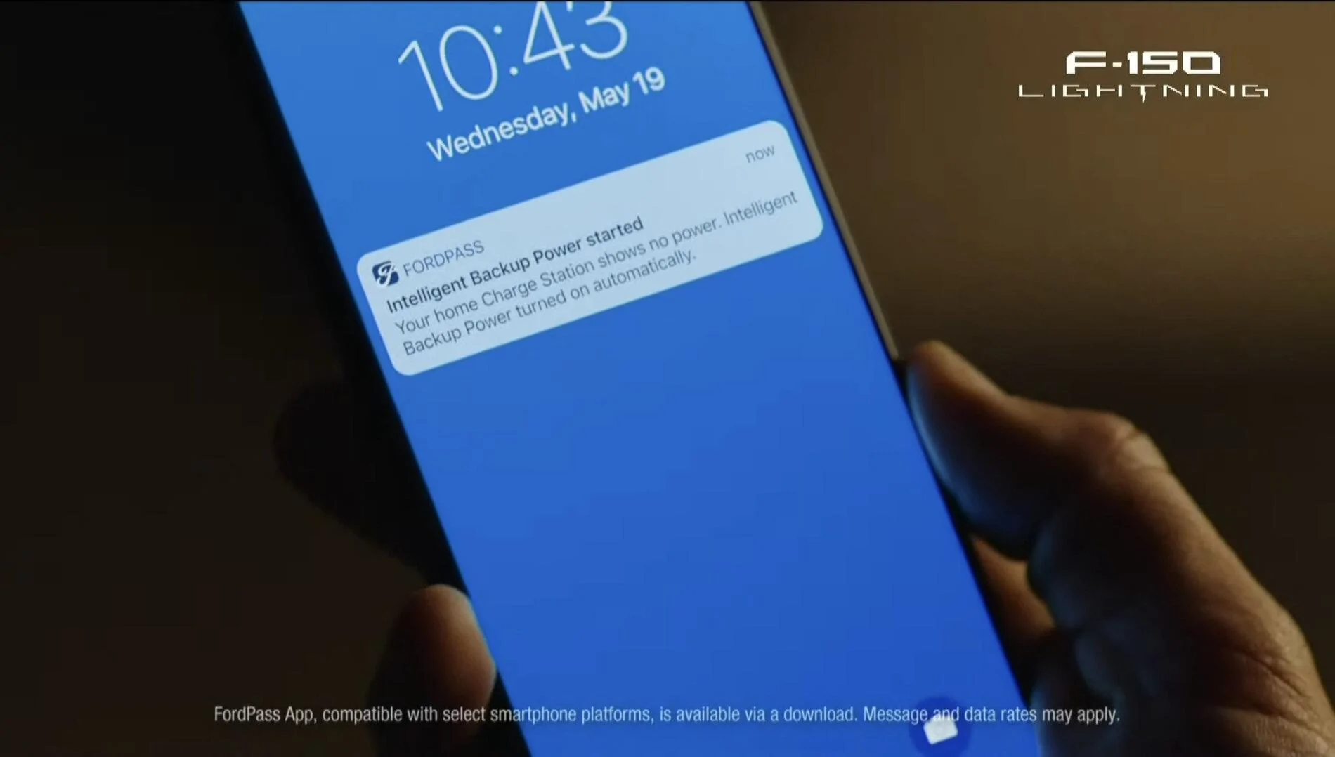

1) The Ford Charge Station Pro would know when to fully pre-charge the truck. Tesla already does this.
2) Rich customers are wasteful, and therefore should be accustomed to even more wastefulness? BS.
Ford said typical, and average. They are not lying.
Heck, you yourself pointed out how wasteful you are that you need 2-6x the backup power of a typical house.
That's six other houses that could be bright and warm but aren't, because of your purchase.
No, Tesla does not already do this, not with an EV battery. It would be wasteful to charge an EV to 100% every time there was a storm in the forecast and that would be most of the winter around here. And charging to 100% only when there is a hurricane or really extreme weather does not catch many power outages. Are you aware than not all power outages are weather related?
This means even if Ford adopted the wasteful practice of having their EV's charge to 100% simply because a storm was in the forecast, that still wouldn't ensure it was fully charged when power was lost

Tesla vehicles charge to whatever level you ask them to. Powerwalls are different however. When weather conditions of sufficient severity (and I don't know what defines that) are forecast in your area the mother ship will send commands to your powerwalls to charge up in anticipation of this. i don;t know the details.
