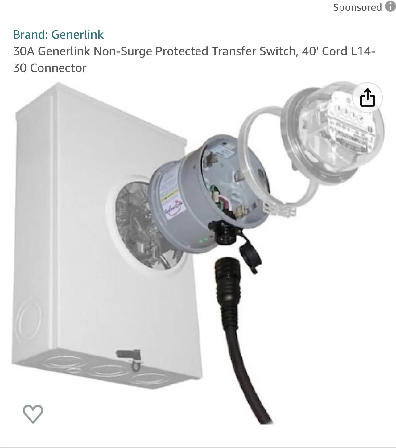

You need that for any backup system, vehicle or no. It comes on every UPS and backup power brick, it's not like a complex part.
And sure, you have reliable power. But most rural buyers don't. Texans don't. Californians don't. People in hurricane and bomb-cyclone areas don't. People in wildfire regions don't. You know, places where it's handy to have a truck.
Here’s an automatic transfer switch.
Tesla Cybertruck Cybertruck needs to have vehicle to home charging (V2H) IMG_9251
