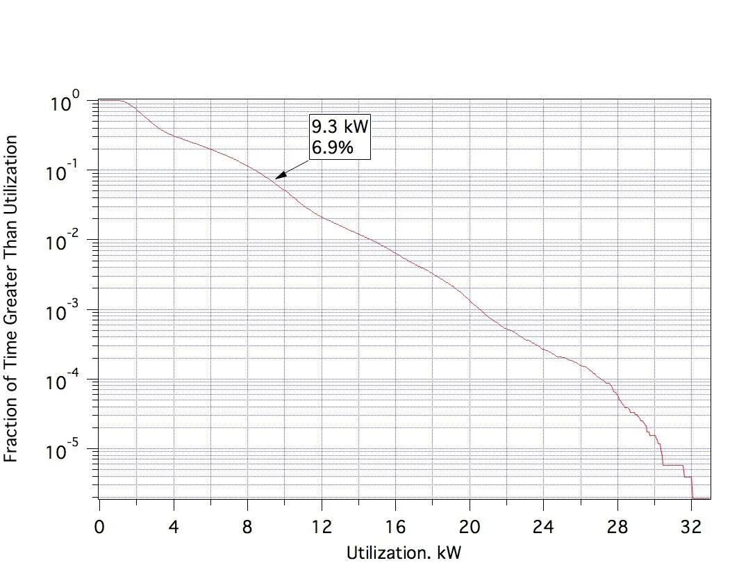

9.6 kW is not "quite a bit".
Yes, actually it is. I live in a pretty good sized house with 3 heat pumps (2 of which are equipped with electric E-heat), one A/C and a walk in refrigerator. I also charge a Tesla X. I have electric ovens and an electric clothes dryer. The picture below summarizes my demand over a full year. Note from it that my peak demand is 33 kW.
Tesla Cybertruck Vehicle to Home (Ford Figured it Out) YrHisto
Note that 9.3 kW is exceeded only 6.9% of the time. That's spread over the year
