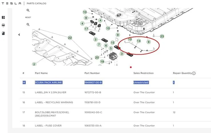

We've known this for a while, the pack is being pressurized to stop water ingress. That's it.
It has nothing to do with "cold air sucking water in", as this can be dealt with by the existing breather hose on the pack. It's just in case the seals let water in, which in turn could create corrosion etc in the pack. An actively pumped volume uses positive pressure to push air out of a leak, which means no water can come in. Our expedition vehicles did the same to keep the dust out of the cabin. It's quite common in dusty environments. I'd do the same.
Even some ICE etc have breathers on diffs and gearboxes, but they are cooled down much faster, because of the small thermal mass, and large surface area. The battery pack is a huge volume in comparison with only a small exposed area. But it has a large seal, which is why they keep it pressurized just in case.

One of the things you have to do to setup a 4X4 for deep wading is extending the breathers for the diffs, transfer case, and transmission up above your target depth; that and a snorkel to move the air intake up.
For the Cybertruck, since the compressor is already running to keep the air suspension at max height, running an airline into the battery pack is a straightforward way to achieve this feature for the cost of a length of air-hose, two air ports, and a few assembly steps. If you wanted to get fancy you could add a valve, but I don't see any harm in pressurizing the pack when the suspension is adjusting up.

From SawyerMerritt:
"So this is cool. The Cybertruck's Wade Mode apparently uses its air suspension tank to seal its battery during river crossings.
In the Cybertruck parts catalog, there is an entry called "Scuba Pack Airline," which goes from the air tank to the battery pack. In addition, a "scuba valve block assembly" lets compressed air in the line to increase outward pressure and prevent water from entering the battery pack during river crossings and the like."
