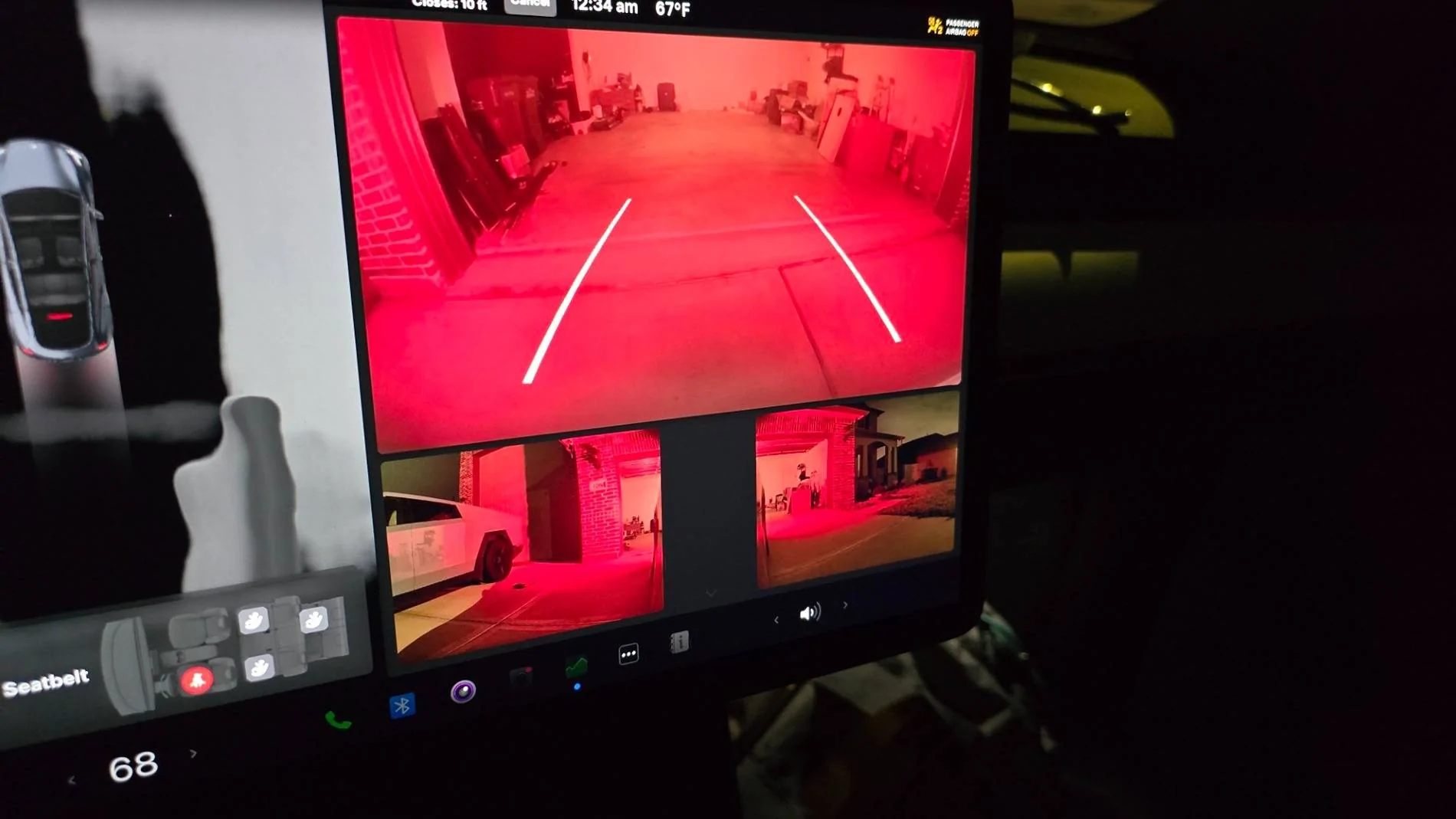

I just confirmed when backing into the garage again, the top of the garage door is not visible in the 1. rear view camera, 2. rear view mirror, or 3. side mirrors. It is only visible slightly in the 4. side view cameras. I feel more confident now that there was not much I could have done different in the moment to avoid this.
Who looks UP when backing into a garage? I typically focus on the ground for debris, children or pets.
