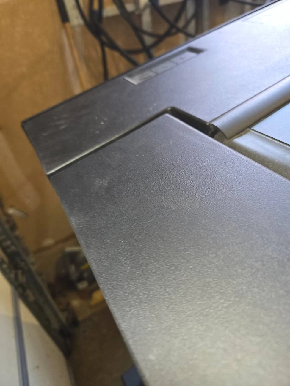

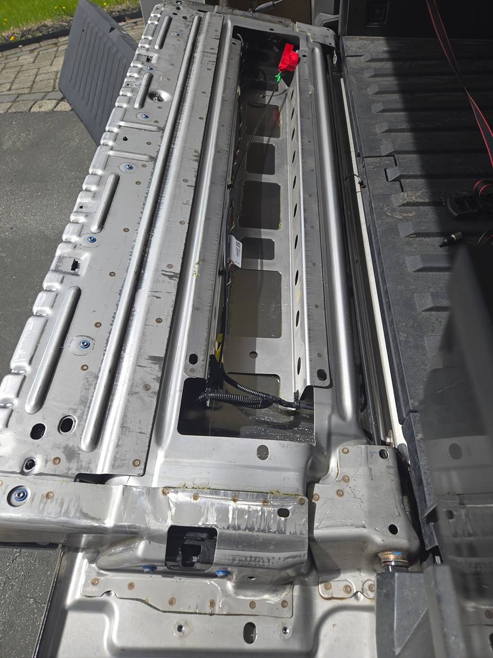

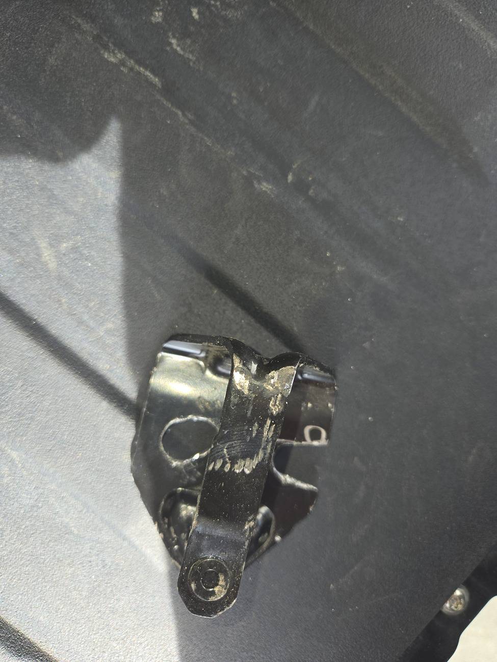

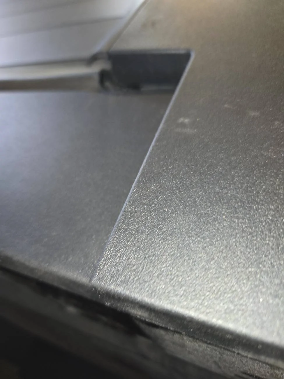

Here's my temporary fix. I took the tailgate shield off and indeed about 1/2"-3/4" crunch on the height of the tailgate. The latch catch won't engage because it is too low. Figuring the latch bracket/capture pin attached to the truck is pretty much expendable, I hacked and drilled into it to allow the lower latching point. Works like a charm now but the gate is still damaged - but not really recognizable (or an eye sore except to me) unless you really look. I'm still keeping my eyes on aftermarkets ($500-1000 with scratches but I have a wrap). Shipping there is the big concern - most soloists won't. A new one would cost $4k and I don't want to waste an insurance claim on this one
Tesla Cybertruck Warped tailgate issue after hauling load TeslaBent
Tesla Cybertruck Warped tailgate issue after hauling load TeslaHP
Tesla Cybertruck Warped tailgate issue after hauling load TeslaGoodSideClosed
. I attached some pics for your viewing pleasure. FYI - door closing adjustment I am SURE could do in a similar way with minor expansions to the holes in the latch bracket.
Tesla Cybertruck Warped tailgate issue after hauling load TeslaBentSideClosed
