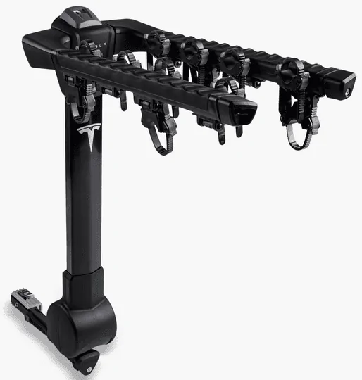

Tesla Model X/Y Bicycle Hitch Rack for up to 4 bikes
Tesla Shop
https://shop.tesla.com/product/model-x_y-hitch-rack
Features:
Fits both 1.25" and 2" hitch receivers
Carries up to 4 bikes
Weight - 40lbs
Note: Tow hitch required. When carrying bicycles or other items on the Model X/Y Hitch Rack, always check to ensure that the maximum weight is not exceeded. The Model X/Y Hitch Rack is designed to support loads of up to 54.4kg ( 120 lbs).

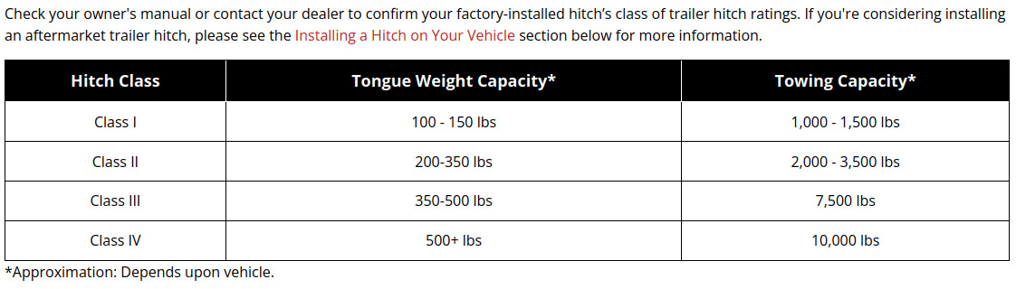

Tesla Cybertruck Warped tailgate issue after hauling load 1723711124404-d9
Hitch Sizes
Hitches are sometimes identified by size rather than class. Hitch sizes refer to the inside dimension of a vehicle's hitch receiver (measure one side). Class III and Class IV hitches have a measurement of 2 inches, thus they are often referred to as "2 inch receivers." Class I and some Class II hitches generally have a measurement of 1.25 inches, thus they are often referred to as "1.25 inch receivers." Class V hitches have an inside measurement of 2.5" and are designed for heavier loads.
Note: Some manufacturers fabricate Class I and II hitches with a 2 inch hitch opening to accommodate a greater range of hitch accessories, so do not assume that a 2 inch opening equates to a Class III or Class IV receiver hitch.
2" hitches almost always have greater hitch Tongue Weight Capacities than 1.25 hitch receivers. Check your owner's manual, contact your dealer, or simply measure your receiver opening's diameter to determine your hitch size.

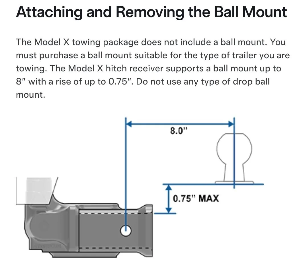

Tongue weight (mostly) only reacts vertically. The ball and hitch ensure there is no torque on the receiver beyond the 1,100 pounds (plus dynamics) on the ball multiplied by the frame to ball lever arm.
An unconstrained suspended load can exert much higher loads in directions and ways a trailer would not.
Model X calls out max ball height and distance from pin due to torque when accelerating and deceleration.

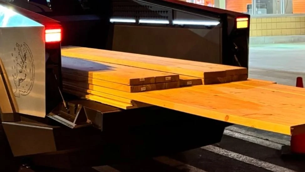

Warning to everyone about hauling items. I was hauling a load of 12 foot composite decking boards today. I made sure that the weight limit was not exceeded, however, since the load shifted, it obviously put too much weight on the tailgate and now the tailgate is warped. Fortunately still shuts but it clearly bent the stainless steel and it now has a gap.
So caution about this possibility. Perhaps I should have known, but alas I was unaware of the potential.

Not happy that these click bait rags are posting my user name without my permission and creating a false narrative with my information. They certainly did not ask for my permission.
For the record, my cybertruck tailgate issue in no way would make me not want to purchase all over again.
If anything, I'm surprised more damage wasn't done when my improperly loaded composite boards sliding and bending over bounces--putting clearly higher than expected pressure with a leveraged effect on the tailgate. I'm lucky the entire load didn't slide out to the road.
Placing these vertically to prevent flexing as suggested by another would be a good idea (and of course carrying fewer of them at once). First time I've worked with composite boards and I didn't know how crazy flexible they are.
I only wanted to be sure that others were aware to be careful about load placement and the tailgate.
My tailgate is perfectly usable and the latch function is intact. I will make an appointment to see if an adjustment can make the closure even.
The false narrative that these clickbait rags have run with that cybertruck is somehow not up to "real truck" work is absolutely ridiculous.
This truck is fkin heavy duty, incredible and superior to anything else on the market. (Not to mention bullet resistant!) It has exceeded my every expectation. I would not want any other truck.
