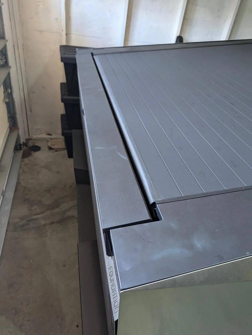

Help!!! I lightly backed into a 4x4 wood post with the tailgate down. 🤷‍♂️Now the right side of the tailgate needs minor force to close and open. The right hinge is off about 1 degree from square. The left hinge is square.
Did you not use the reverse camera when the tailgate was down? /s 😁

I had this problem. I got the gate back level by bending the striker plates, but I had a tailgate error on the screen as well. Turns out it damaged the latches in the gate when the striker plates bent. Tesla replaced all of it for about 500 bucks and good as new. The only durability issue I have had with my truck so far.

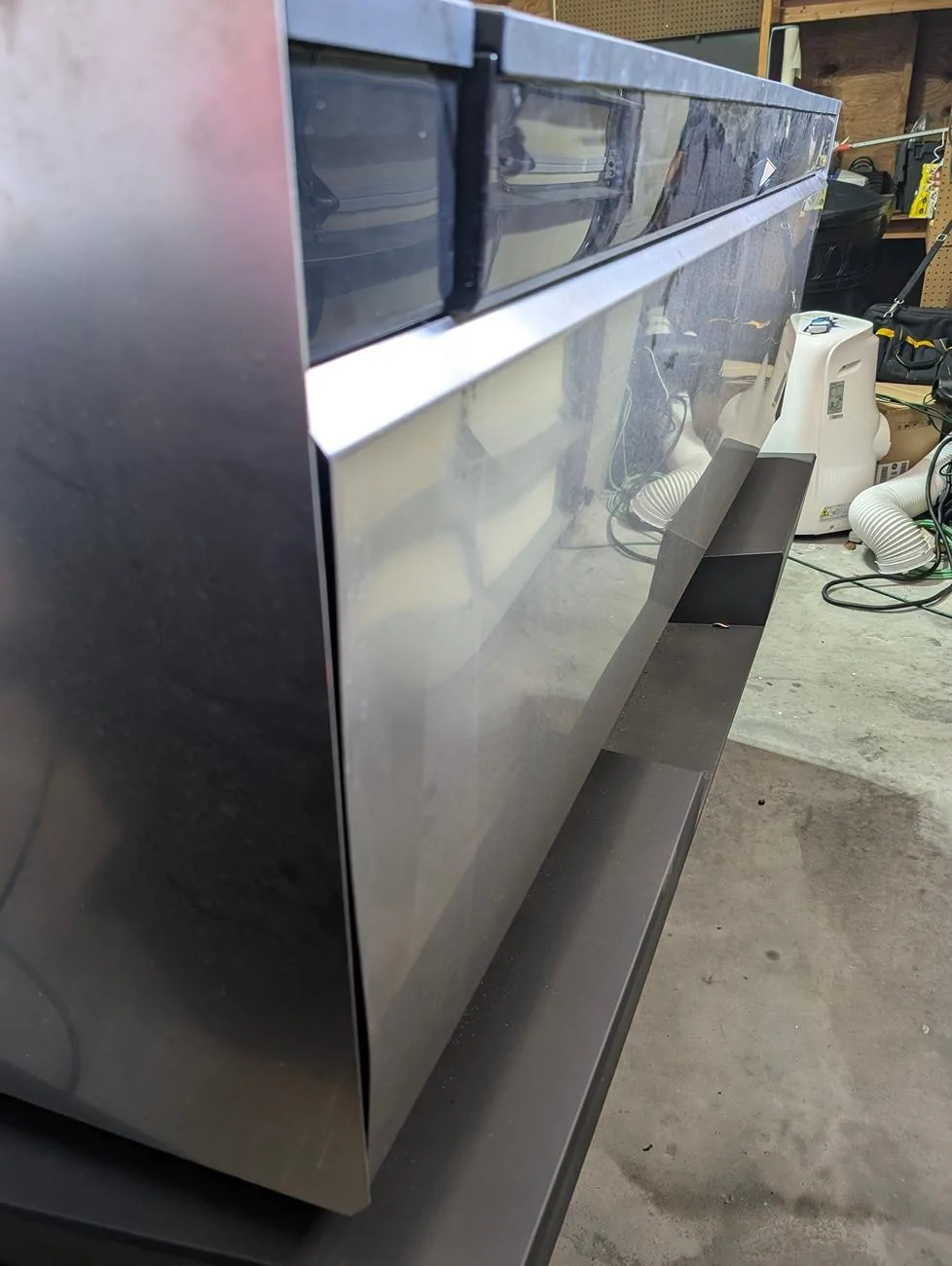

Warning to everyone about hauling items. I was hauling a load of 12 foot composite decking boards today. I made sure that the weight limit was not exceeded, however, since the load shifted, it obviously put too much weight on the tailgate and now the tailgate is warped. Fortunately still shuts but it clearly bent the stainless steel and it now has a gap.
So caution about this possibility. Perhaps I should have known, but alas I was unaware of the potential.
Did you have the tail gate closed or open
