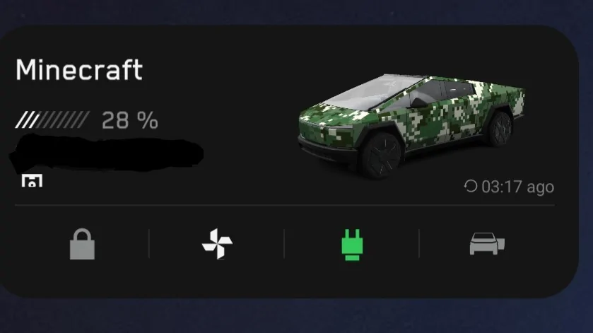

Use your phone app to enable the ac before entering and change the temp to your desired setting. I have the fan shortcut on my top row and the Tesla widget on my home screen. I also use cabin OT set to 85F but it does seem to stop working if the vehicle is left unused for 12?+ hours and I have to reenable it from the app.

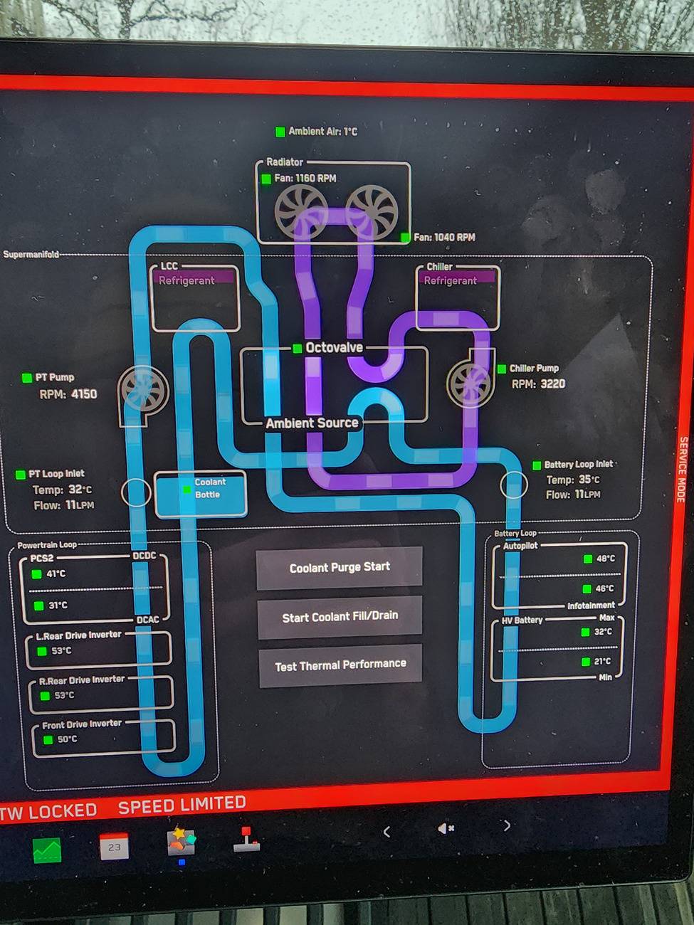

The Service Menu can display temperatures and pressures in real-time.

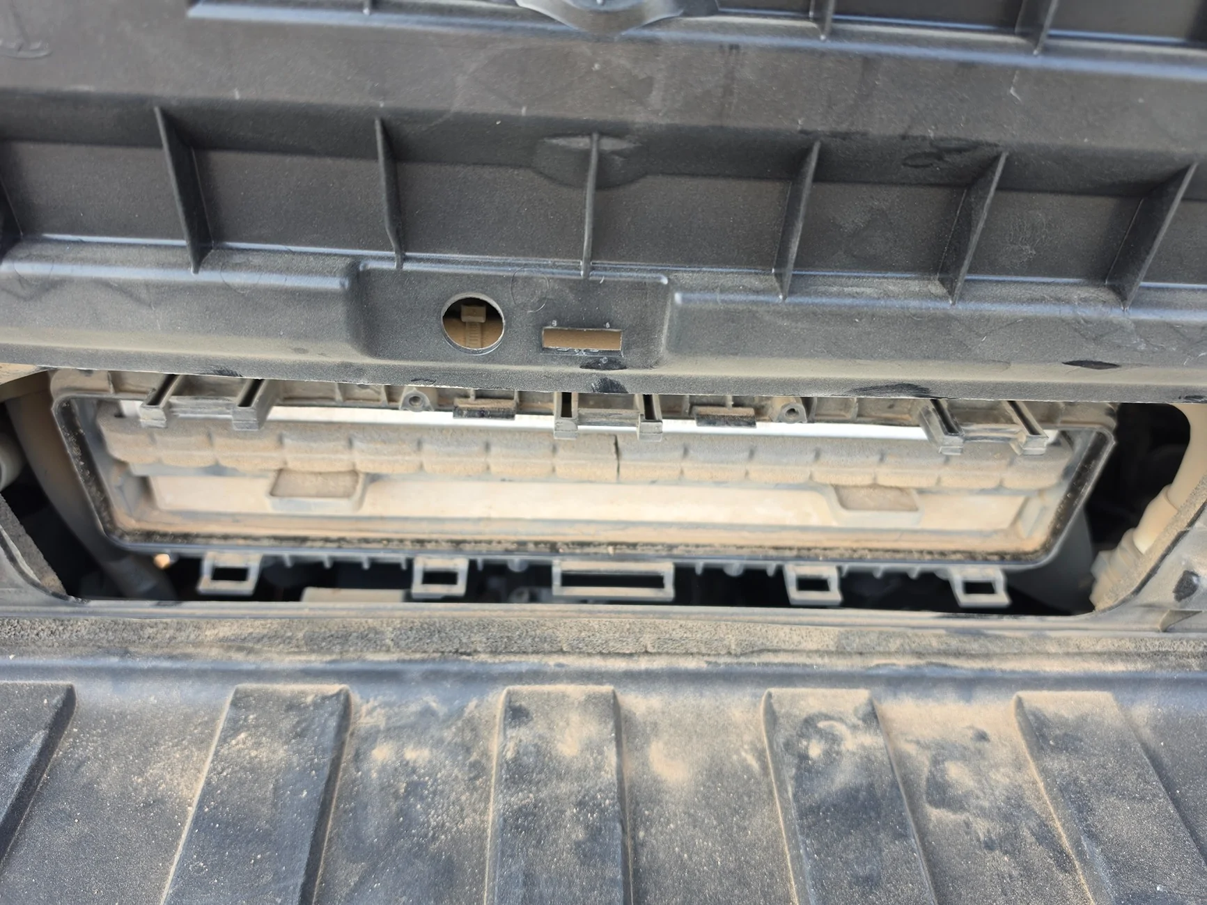

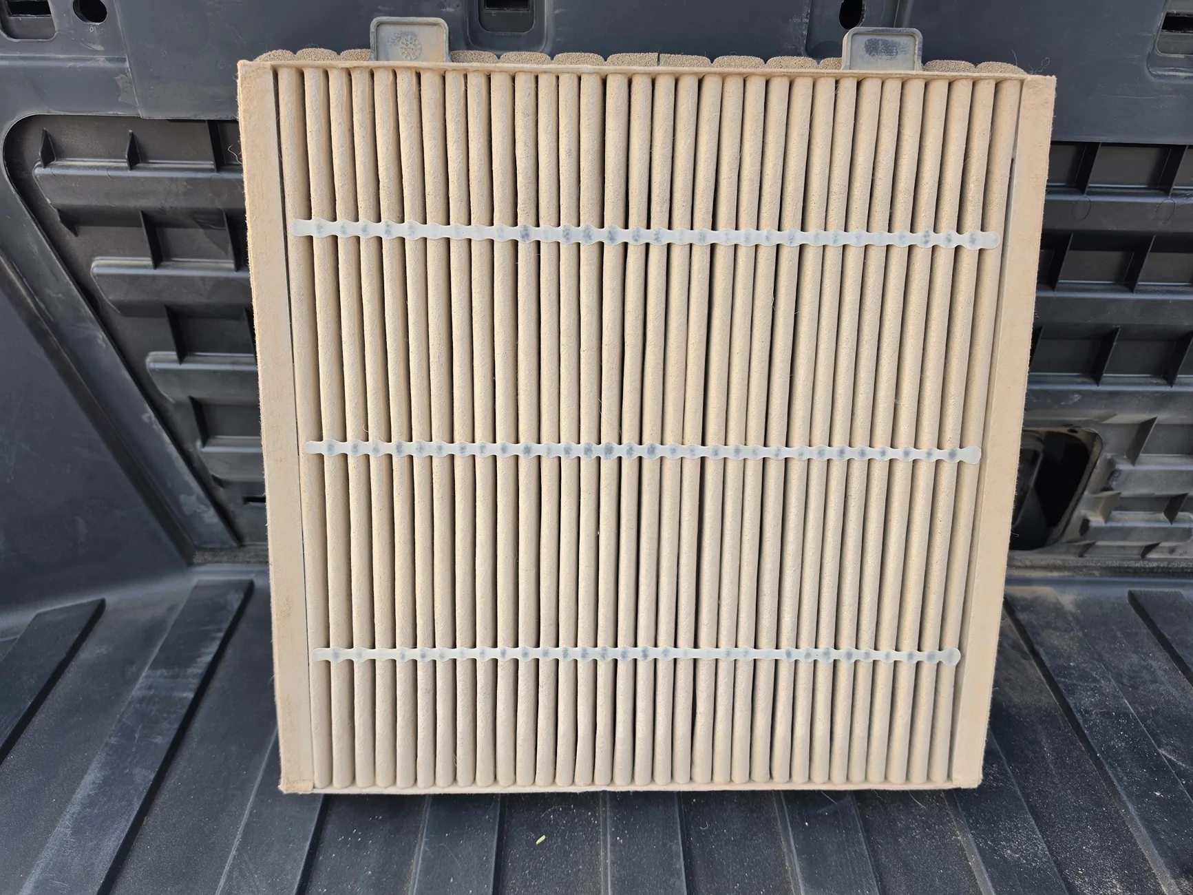

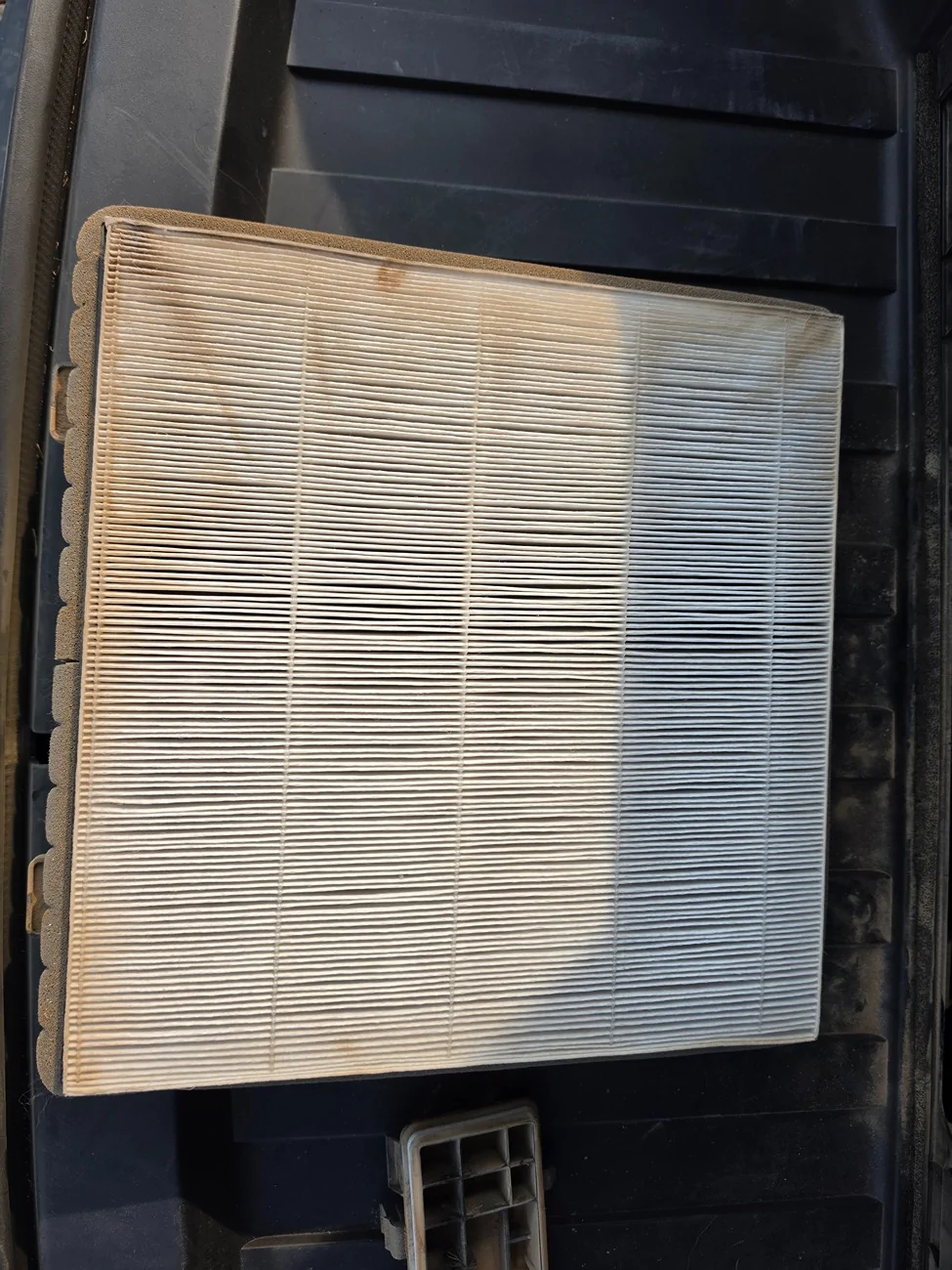

I second all the HEPA posts, blew out the dust from my filter and it started blowing twice as hard

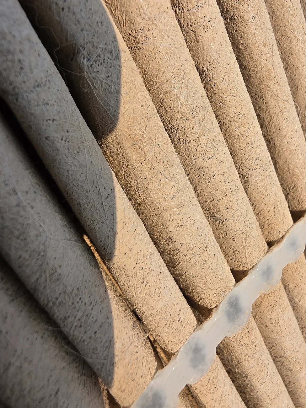

Ok so I'm not the only one...
So being in dusty rural Colorado, I thought hey let's use a "severe service" interval. Usually that's changing everything twice as often. So the manual says to change the HEPA every year, so I thought I'd be good doing at the 6 month mark. HECK FREAKING NO.
After 4 months it's basically passing no air, so maybe have to change it every 2-3 months. That gets expensive fast. I just put in a new filter and set my phone schedule for me to blow out the HEPA the 1st of every month. We'll see how it goes.
