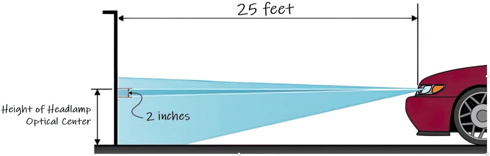

Tesla Cybertruck Weak Headlights are the Cybertruck's Worst Feature how_to_adjust_headlight_height
Headlights should be basically level.
I adjusted by eyeballing the beam on the side of a building from across the parking lot, they were still level even at that distance. And very bright.
Part of the problem is how low they are mounted...
...That's actually better for you, as a driver - they have less distance to get the the pavement than when they're mounted higher, and will illuminate less fog. (If only the DRL turned off for fog and snow!)
But it does mean any tiny variance in adjustment will throw it off more, so making sure they're adjusted correctly is more important.
